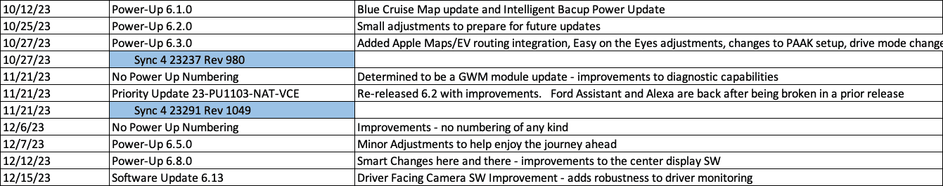

@rugedraw or @Mike G - Do you know if these door updates may have been included in another release as well? While I've been lucky to get most every update and very early in the cycle, I never got this one. I'm wondering if for certain trucks the door module updates were also included in another release. Back on 11/21 and 12/6 - I received two different unnamed releases then all of 6.X through 6.13, but not this one. I've double checked my screen shots that I keep. 1FTVW1EV3NWG03253
That I know of, there have only been two DDM/PDM updates released and they both were stand-alone updates that only updated those two modules. The roll-out for these updates was never very aggressive, though. I am not sure why.
2021-202323-PU0813-DOR-UP2Dec 2023We've made background improvements to improve your vehicle's software to enhance your overall experience.DDM/PDM20
22-PU1007-DOR-UPFeb-23N/ATo help alleviate overheating, we made an update to improve your heated mirrors for optimal temperatureDDM/PDM20

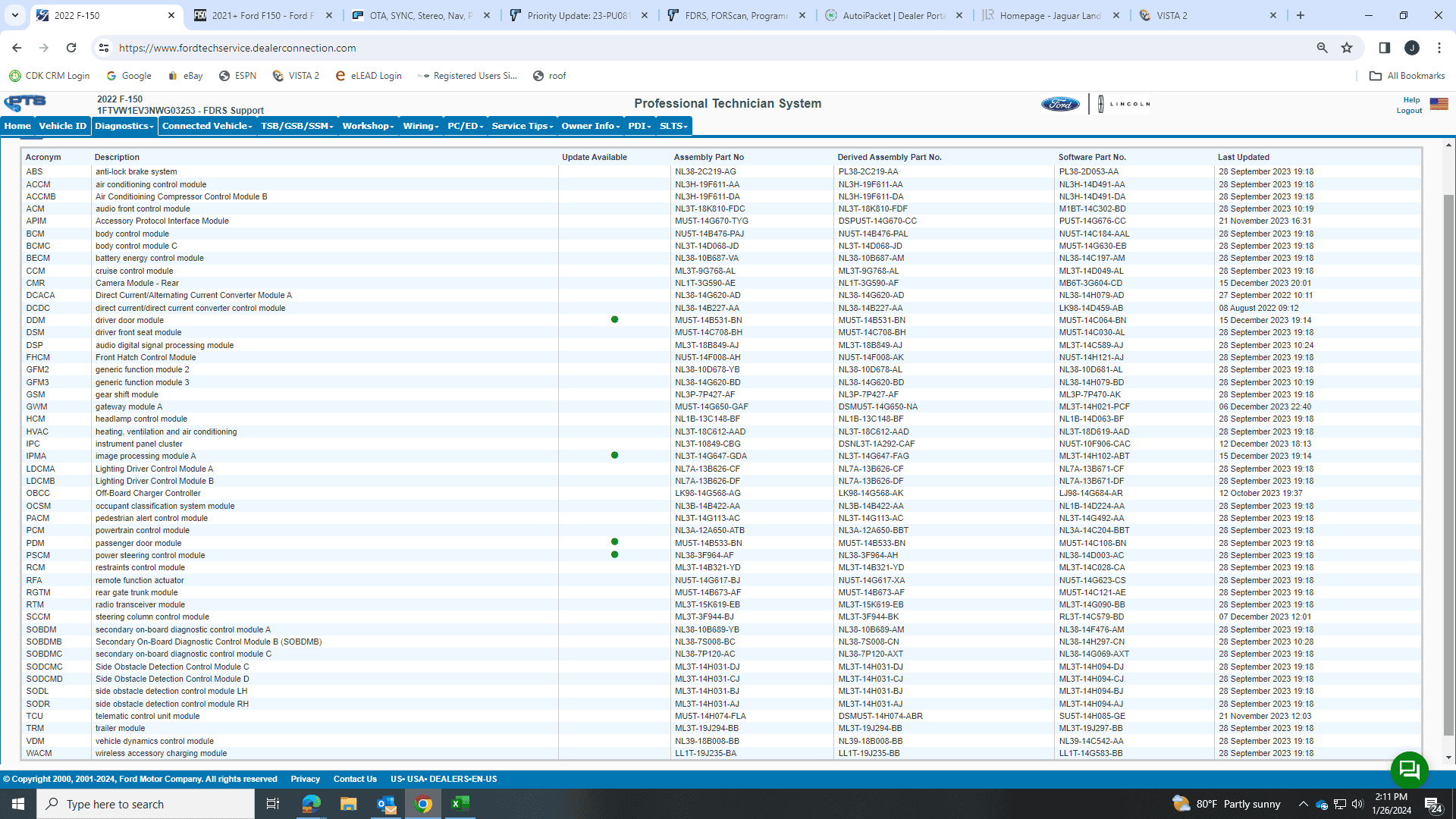

PTS does show you have pending updates for those modules:
Very interesting - thanks. Odd I didn't get the release when I get most every other one, also interesting they are showing releases available and was updated with SW from September and the other from December. So they still have recently updated. Just maybe more updates for something like Walk Away lock.

The IPMA/PSCM updates provide significant improvements to BC performance and have the features for BC 1.4 in them, but not activated. The first popped up in FDRS for vehicles in December.
