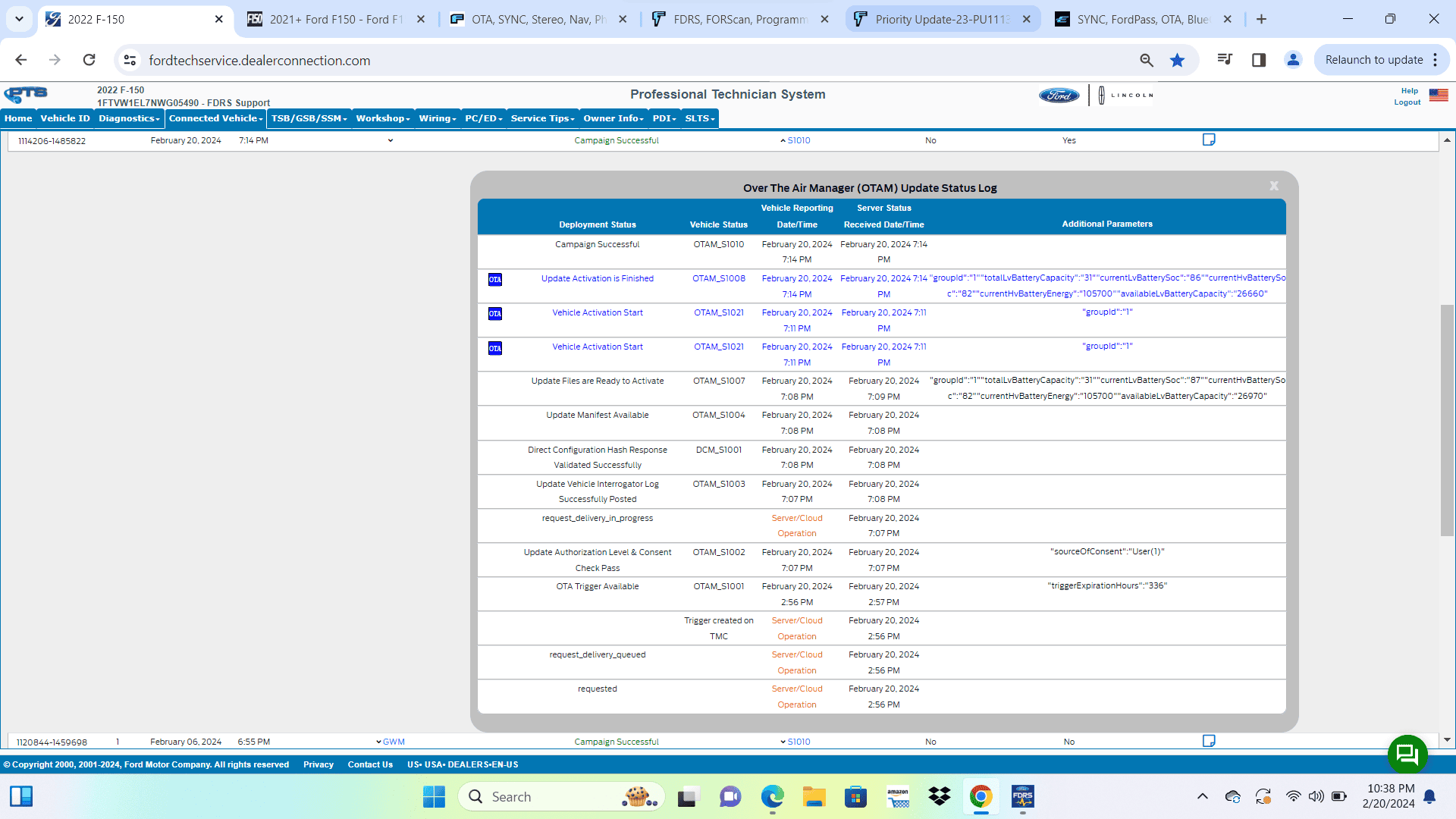

OTA time stamp is below. The tricky thing is that this update doesn't show it downloaded any files. The interrogator polls post the log, followed by the hash response from the server, the manifest posts and then the OTA is ready to install. No files downloaded. The OTA trigger was activate at 7:15pm and by 7:17pm, it was ready to install.
Ford F-150 Lightning Priority Update-23-PU1113-UNX-DC [Connectivity] 1708484826826

PTS doesn't show if it downloaded via wifi or its own modem. Just trying to see if anyone had gotten this with wifi off. Trying to determine if wifi is required as the update says.

It was today. Time stamp of the update is below:
Ford F-150 Lightning Priority Update-23-PU1113-UNX-DC [Connectivity] 1708486742601
