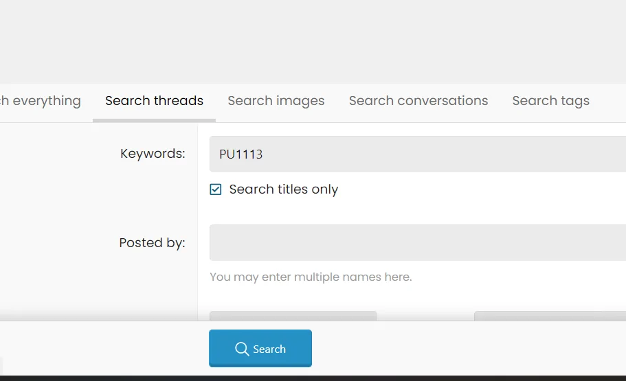

Wonder why that didn’t come up? I searched for 23-PU113. ?
Thought it sounded familiar but could find it.
Thanks.
The search engine is finicky, if it fails you try searching with titles only and a small group of characters.
Ford F-150 Lightning Priority Update-23-PU1113-UNX-DC [Connectivity] 1708733863620
Also head into the primary node where the majority of OTA information is stored, the hot topics will be at the head of the initial sort, old less active items further down.

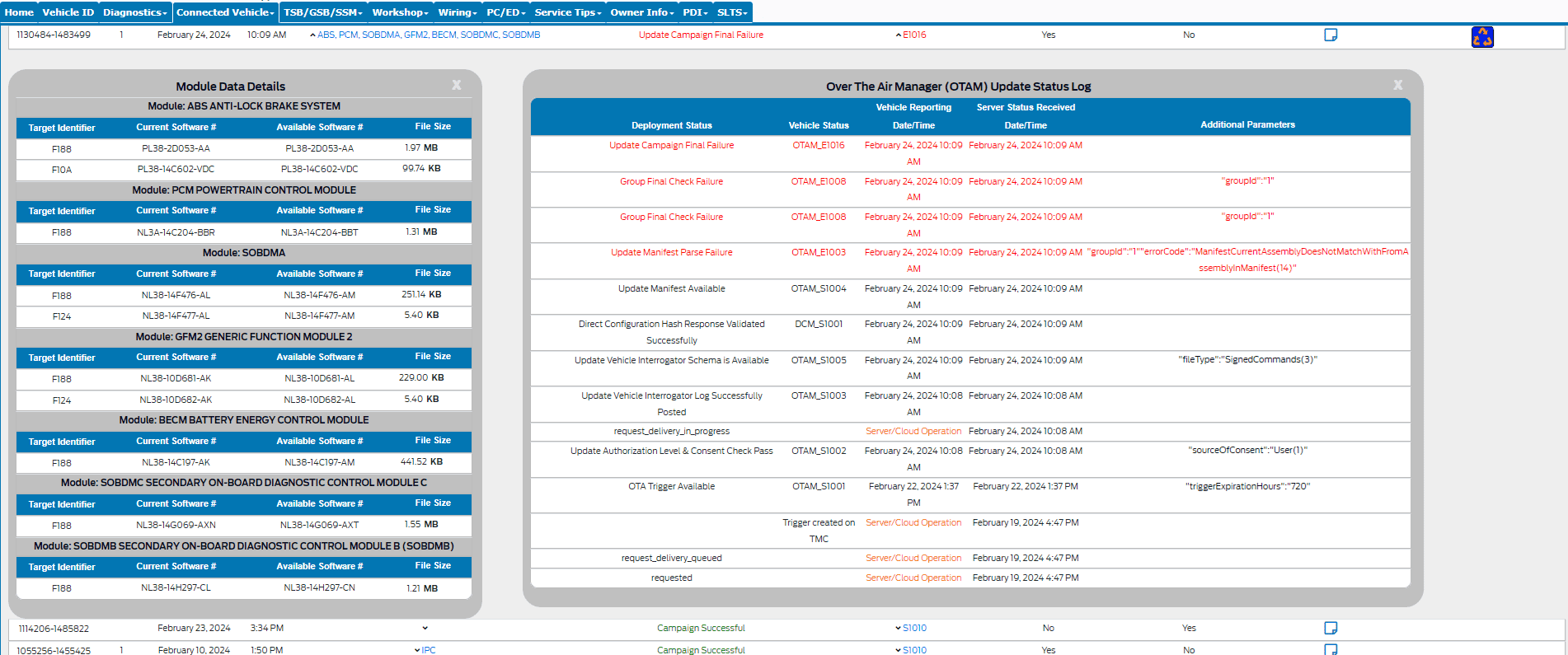

The update failed within a minute of the OTA trigger being activated. It failed due to a manifest mismatch. The update package includes several modules. Since this is to address a CSP, this is not EA related so this is what gets updated.

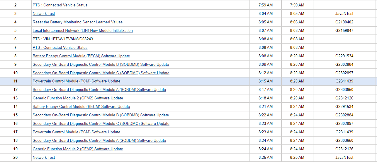

Could this be related to having the 23B70 Battery Monitor Sensor replacement or the BECM software updated at the dealer last week? What happens next? Thanks!

If it was related to the BMS or battery, the error code would have specified that as being the reason for failure.
The fact that they updated some modules that are included in this OTA package I guess could be why the manifest doesn't match up. However, as you can see at the very bottom of the list of what your dealer did, the last thing they did after the updates was a network scan. In theory, that should have synced everything up with the server. It's virtually impossible to diagnose why an OTA failed.
