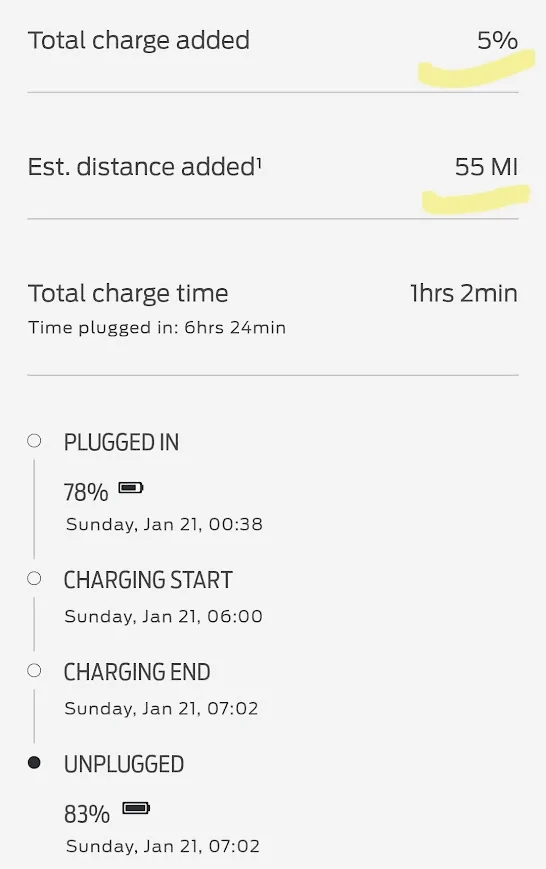

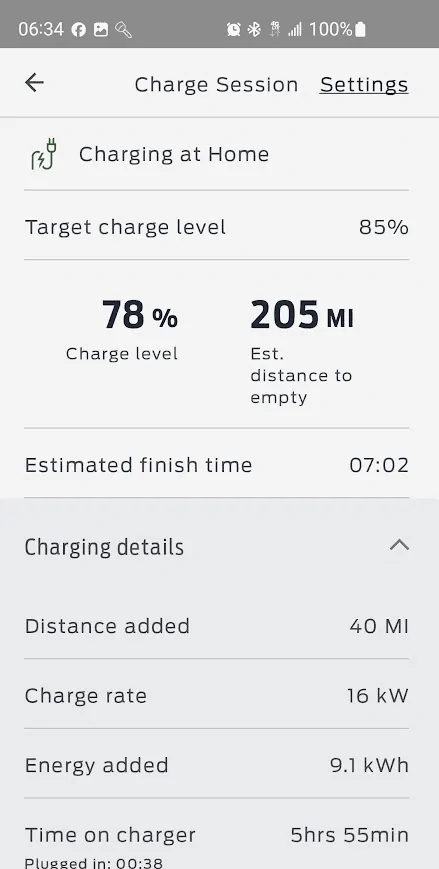

Here is another example of how the estimations and other data is unreliable, (we all agree)
Back story, Saturday afternoon, my truck was out in the cold most of the day and evening, had errands to do then host a party away from any charging facilities, temps got into the low teens, at that point the truck was well cold soaked and power out limiter was derated to 96%, Battery SOC was 78% from 85%
We got home a little after midnight, plugged in with delayed charge schedule commencing 6am, it ran, then I got up at 6:34 @10° and pushed the remote start just then and extended it intent that it be plenty warm for the Mrs. when I took her to church.

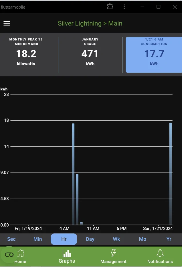

Notice the 6:34 snap shot said that I had already added 40 miles of range in only 34 minutes and that I had taken on 9.1 KWH of energy, the FCSP was pushing out almost 18 KW rate at that moment though FP said is was 16 KW, the session ran until I unplugged at 7:02, drawing a total of 17.7 KWH.
Later in the afternoon, FP posted the details of that session showing that I added 5% SOC [78 to 83%] the inferred DC stored energy is ~ 6.6 KWH [131*.05], it seems that the actual energy consumed to condition both the battery to bring up the core temp to a safe level as well as cabin warming took ~ 11.1 KWH
Est Dist Added* (55/(131*.05)) = 8.4 MPK

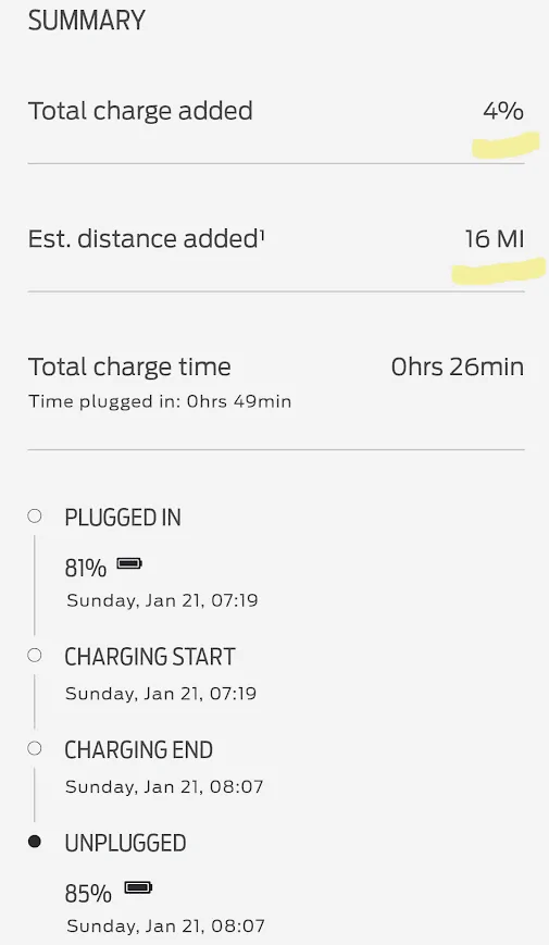

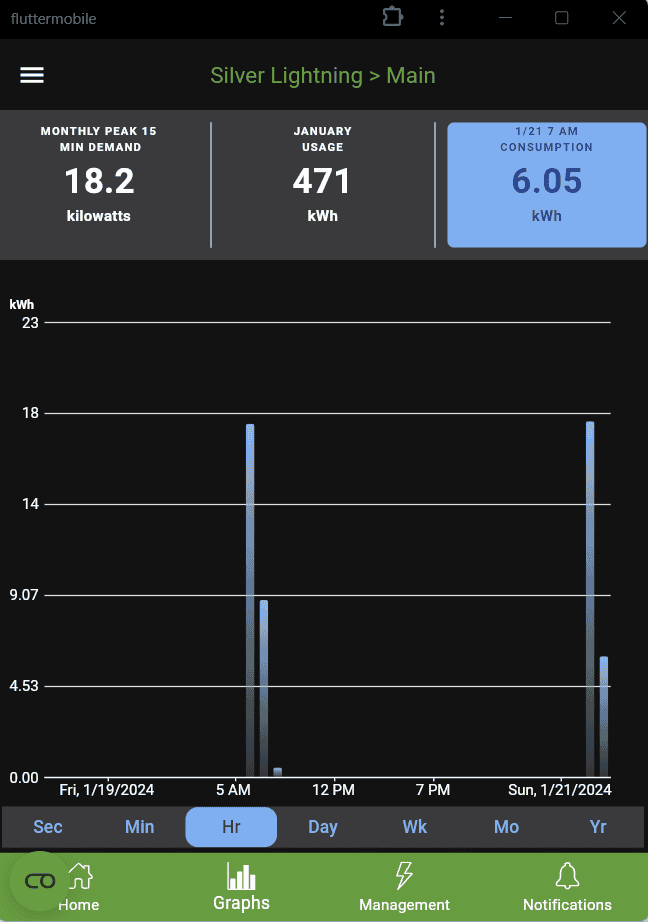

I made the short round trip drive after dropping her off, and returned to the garage and resumed charging the battery to get it to 85%, this took 19 minutes and 6.05 KWH, then a second abbreviated remote start of 7 minutes using 1.53 KWH as I left to pick her up and head out to breakfast,
Notice that I added back 4% for imputed 5.2 KWH of battery energy, the 26 minutes is the cumulative minutes the EVSE was sending charging energy and then later remote start energy.
Est Dist Added* (16/(131*.04)) = 3.1 MPK

The FP app should have a break-out for pre-charging conditioning energy and then charging energy, I'm assuming this is possible since we know how much energy the PTC is consuming by the second and how much is being trickled into the battery initially then later when temps are at safe minimum a higher flow to only charging and less or nil to the PTC. The data is present, we just need to have it analyzed & summarized correctly.
BTW Ford, PLEASE post the ending KWH to the close-out record we see several hours later as you've accumulated it in the active session record, yes it's potentially available in the connected charge station data but why do I have to look in multiple locations? Make a useful permanent record by adding these points of data.
