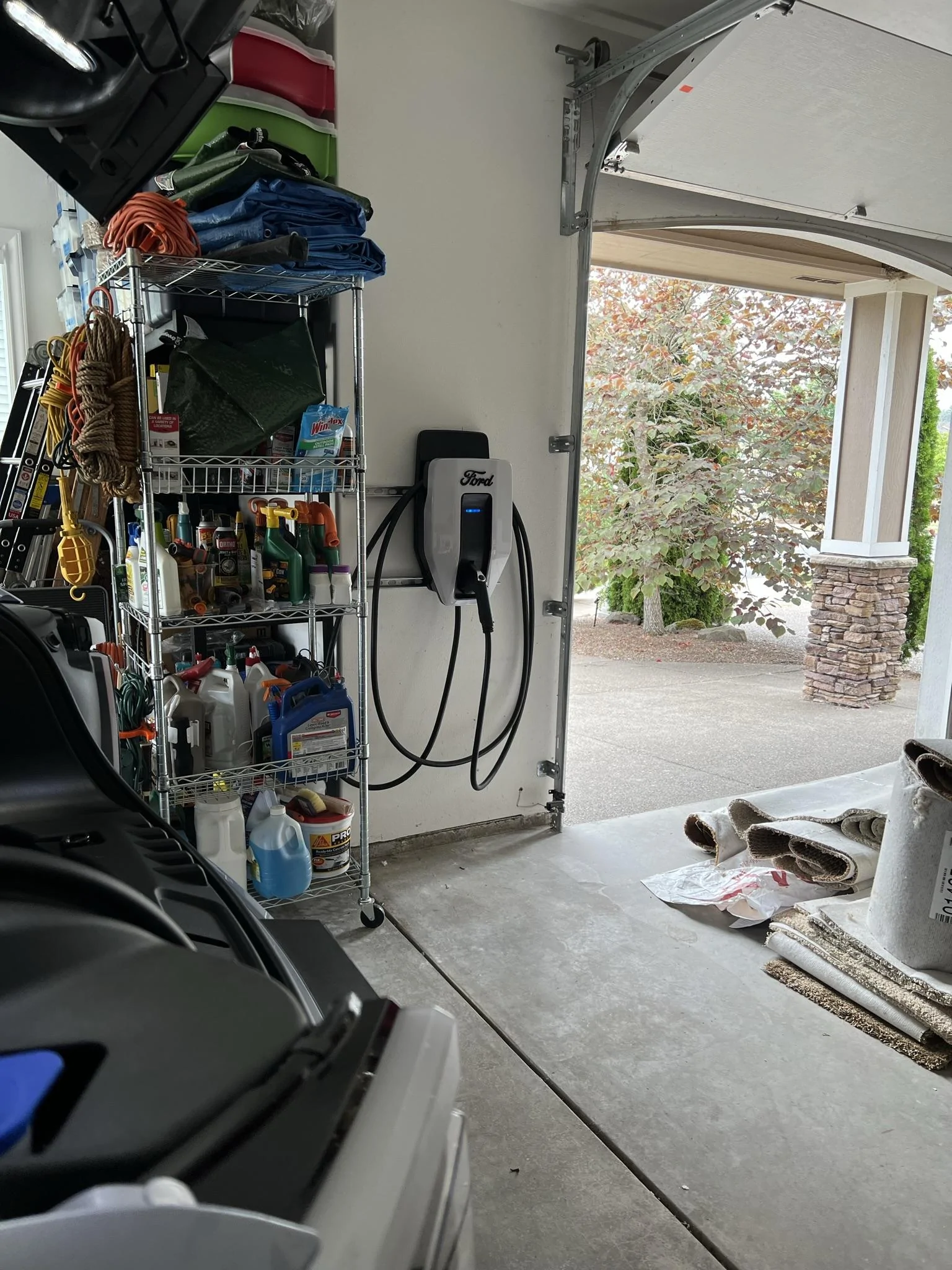

Update: it seems the full factory reset allowed me to go through setup again and this time it connected properly.
Observation: after the Charge Station Pro Setup app does its thing, it will prompt to open up the FordPass app so it can register your station with FordPass. You must wait 5 minutes before you can do this step! MOST IMPORTANTLY, if you click "next" too many times (after seeing "ChargePoint not found!") and get a message that you're locked out for 15 minutes, the charge station cannot connect to the web service that is required to tell Ford your FCSP is online - and it won't retry later... or if it does retry later, it will be well over a day later! For me, even a day later, it still told me ChargePoint not found! when I tried to connect it to FordPass. I think someone else said a few days later, he was able to connect it, but I wasn't willing to wait out a few days for the thing to work - that's horrible experience.
If you have entered the wrong Wi-Fi password and are now prevented from connecting to your FCSP using the setup app, you will need to perform a factory reset using the reset button in the FCSP. This procedure is not documented in the manual and I figured it out on my own. Remove the bezel and then cover of the FCSP (9 screws). In the upper left corner is a red button marked "factory reset"... you will need to push and hold that button until the LED's turn white (15-20 seconds for me). Then you will need to cycle the power to the FCSP (I tried waiting for 15 minutes without power-cycling, but the SSID never showed up) and wait 3-5 minutes for the SSID to show up on your phone. You can then use the Ford Charge Station Pro Setup app to set the device up again.
Thank you @FlasherZ for this and your many other posts on this topic! My electrician installed my FCSP today, I connected it to my WiFi through the iApp, and then registered it to my FordPass account through that iApp following your suggestions….it went smooooothly…no issues.
One item of note: He checked the torque on all of the internal connections to verify they were to the manufacture’s specs. He told me they were very tight and that he was unable to achieve the speciied torque because he was afraid he was going to crack/break their attachment to the board. He agreed with other comments seen on this forum that he would have expected a charger moving 80A would be manufactured a little more stout.
He’ll be back in 30 days to check the torque settings…no charge😎
