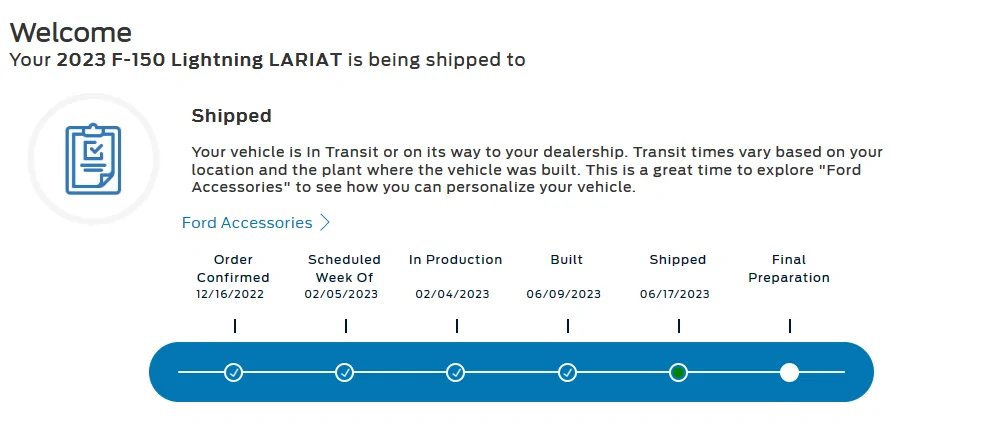

His truck blended on 2/4/23 but didn't get it's "BUILT" date until 6/9. aka gray zone truck, Dave get a snapshot of the load & pressure sticker from the door jam when you're visiting your baby today
