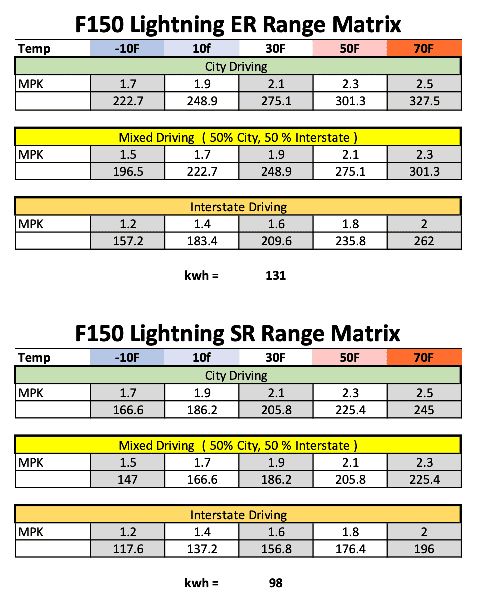

@Mike m as other have stated. Ignore the GOM, it's ~useless. Monitor mi/kwh and calculate on your own. Here is a reference matrix sheet I put together that shows as estimated effect of Speed / Cold. I have 19,000 miles on my Lightning and this is my second Wisconsin winter with it. I knew exactly what to expect and how to minimize cold weather range loss based on research prior to purchase, so winter driving has been a pleasant experience for me.

Love the chart.....are these the actual mileage as per the temp?
should we compare that to the Ford Pass DTE and over ride it with the chart? Example: my DTE is 322 and is 16 degrees outside. I should look at your chart and realize I really have 196 miles to battery dead after interpolation for highway driving?

100%. Yes.
As @TaxmanHog state the DTE or nicknamed GOM is ridiculously optimistic at 80+%. Once it drops below 80% it gets more accurate but it is still not very accurate
I dont even pay attention to it, other than to laugh at it. If planning a drive I use the calculations on this chart. If actually driving a distance where I need to worry about range I monitor my MPK usage per the direction and type of driving (interstate, mix, city) and calculate it out in my head.

it is a great chart. People from Wisconsin can understand my comment. A few years ago my car said minus 32. I wonder if the lightning has ever been tested that low and is there a hardline on temperature. Best practice or voiding the warranty😎
Oh it's been tested, and performs fine. Just less efficient. There are a few Alaskans / Canadians on this forum that have driven and done trip reports (on this forum) in those conditions. They also think Wisconsin is balmy in Winter compared to theirs!

I meant to ask this when you posted before, what is the definition of city driving here? My summer commute (with a mix of 35mph to 60mph) efficiency is usually in the 2.8 mi/kwh range.

I would consider it mostly sub 40mph with stop signs and or lights… but to be honest you are overthinking the chart. It is merely a rough estimate of expectations of the effect of temp and speed on range… not meant to be documentation of minimum and Maximum possible. Furthermore, to be honest most people aren’t worried about range when city driving in warm conditions. Also I did not alter the MPK for SR lightning so with the slightly less weight it would not shock me you get slightly better MPK.

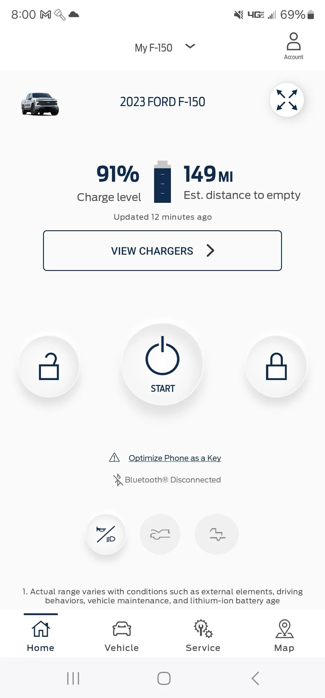

We are on a road trip to Montana in a blizzard. [edit: 0 to 10 degree temps and heavy snow] Hwy driving at 1-1.4 MPK. Woke up this morning to a 90% charge and an estimated 150 mile range [edit: on my extended range truck].
The chart looks mostly accurate. Wish I had factored this into the range between chargers. It's really changed our trip

We are on a road trip to Montana in a blizzard. Hwy driving at 1-1.4 MPK. Woke up this morning to a 90% charge and an estimated 150 mile range.
Very surprised that it's using the most recent {poor}performance, still a little optimistic at 1.25 MPK
