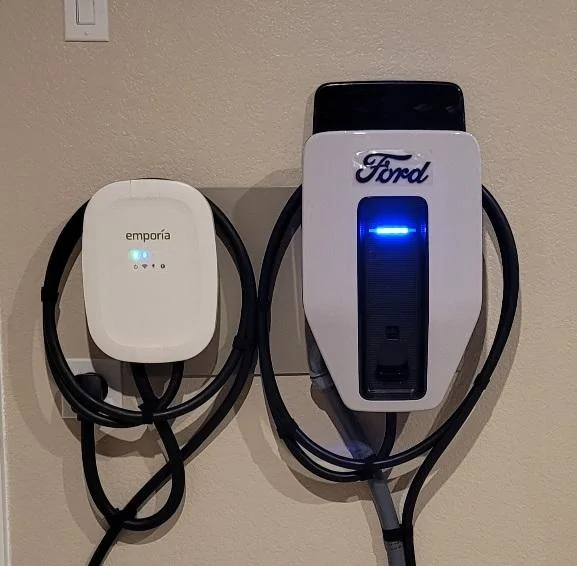

I installed an Emporia EVSE before my Lightning was delivered. I knew I was also getting a Mach-E and I wanted it to have it's own unit. I hardwired the Emporia and installed a NEMA 14-50 outlet. When my FCSP was delivered, I hardwired it and put the plug whip back on the Emporia.
