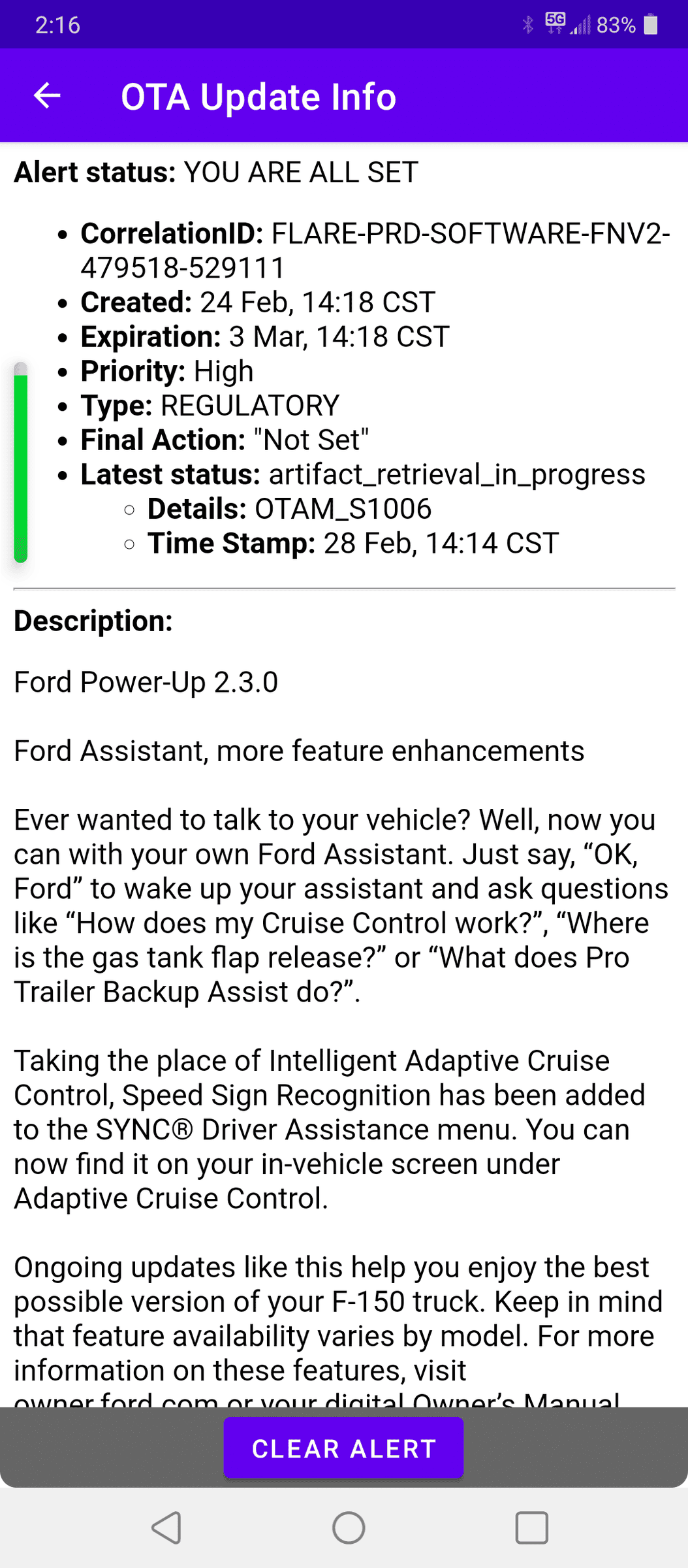

I received an update this morning and everything seems to be correct. I do have one question, unrelated, I keep getting this OTA message. Does this mean I will be updated between now and the 3rd of March?
Thanks for your time and effort in developing this widget
Looks like the OTA is close; I forget the stages but I think "artifact_retrieval_in_progress" means it's being downloaded. That follow something like "delivery_queued" when it's preparing to download. Hopefully next is "success" and not "failure".
Note that the notification will keep popping up until you click on "Clear Alert".
