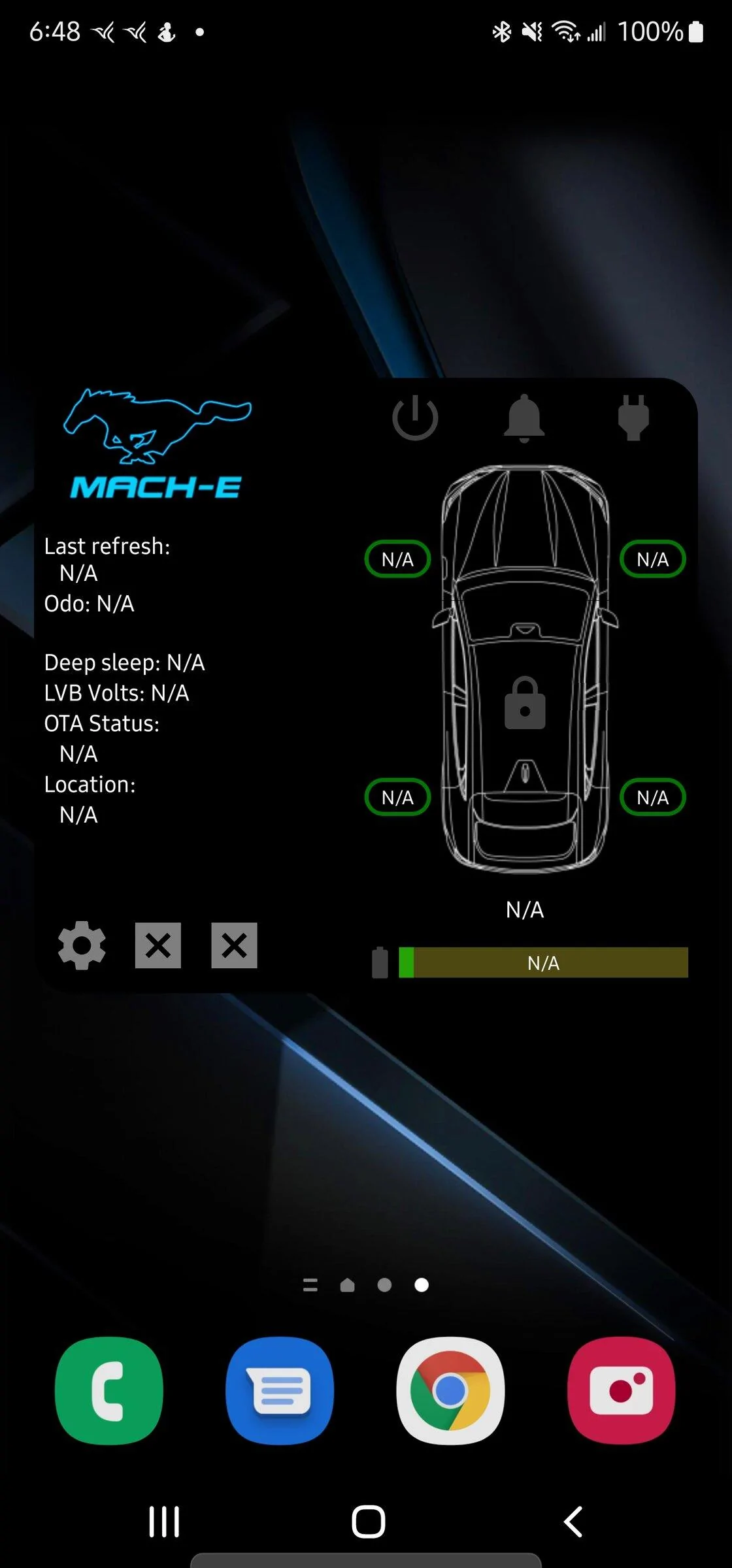

Version 2022.02.26 is out on GitHub. This release has the first attempt at graphics for specific makes base on VIN. Also, you no longer need to manually enable "F-150 mode" as it also uses the VIN to determine this (or at least that's the intention). I'm not thrilled with all the graphics so I will try to make them less busy in the future.
If you attempt to upgrade and Android complains about something, try first turning off the "F-150 mode' in settings. If that still doesn't work, let me know by opening an Issue on GitHub.

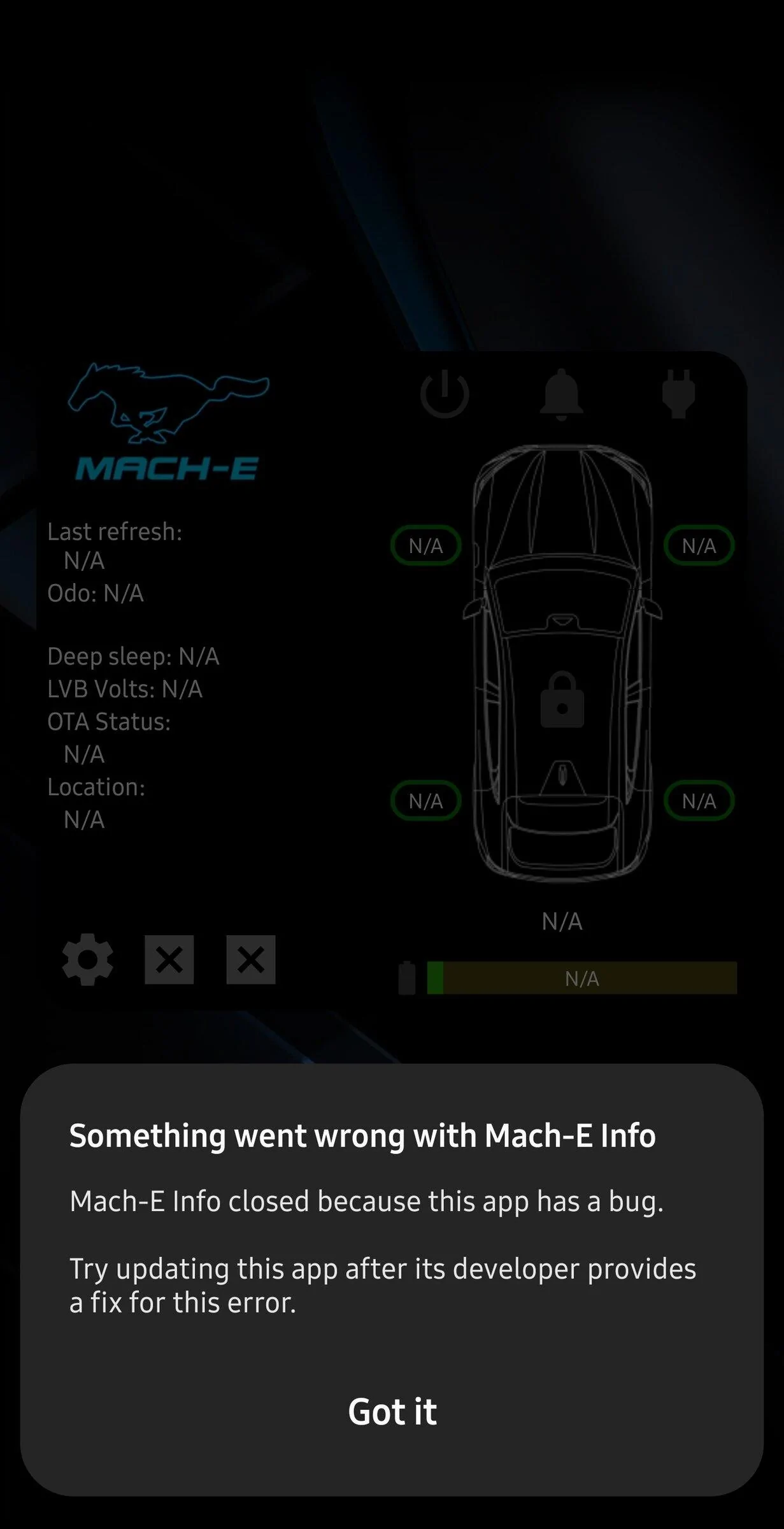

Note sure if it is helpful or you want any info to debug, but it will not open at all on my galaxy ultra 22. I tried 2 different launcher home screens and the widget installs and goes onto a screen fine but I cannot open it. Just let me know. No big deal otherwise, was just going to play with it for fun.
