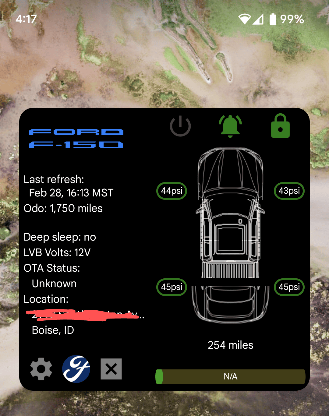

Sideload install was easy. Lock/unlock function works great. This is awesome! Thank you!
Few issues/questions:
  1. Can the vehicle be turned off? Double clicking the power button started the truck, but double clicking again does not turn it off. What if I accidentally double press the start button when I'm away from my truck :unsure:
  2. Looks like my vehicle graphic is using the back of the Mach-E? Mine's a supercab.
  3. Percentage bar at the bottom not working?
  4. FordPass app reports 92 miles DTE and 1,749 miles ODO
  5. What does the Bell icon do/mean?
  6. What does the 'X' button (lower left) do/mean?
Pixel 6, Android 12

  1. The widget won't let you turn the car off. I decided on this for safety reasons, since I can't tell if the car is in motion.
  2. Yes, that's weird. It also has the Mach-E front end. I'm trying to reproduce that one.
  3. There is code to support the progress bar for the fuel tank, but I've not been able to get consistent data to test it. Sometimes it seems to work, other times not. Same for the range estimate above it.
  4. The API gives the odometer in kilometers, as an integer. In my conversion to miles, I round up.
  5. That's the alarm setting. Green is armed, red unarmed, red with a Z deep sleep.
  6. You can assign it to launch another app (like Waze). Look for "Choose Linked Apps" in the three dot menu.

Mine is also displaying the Mach-E rear with a crew cab front (crew cab is correct).
Overall, outstanding widget! Thanks!

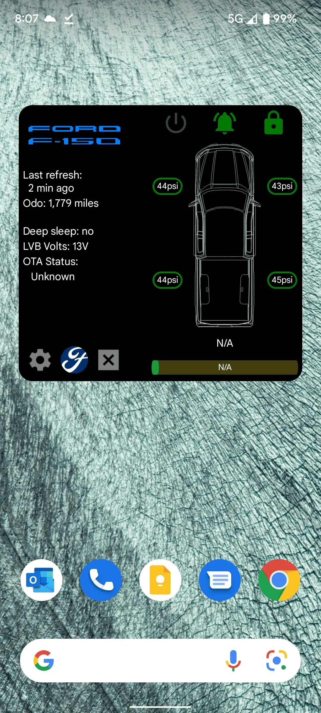

Look like today's update fixed my truck image. Fine work, @kennelh !
Ford F-150 Lightning Android widget Screenshot_20220302-080710
