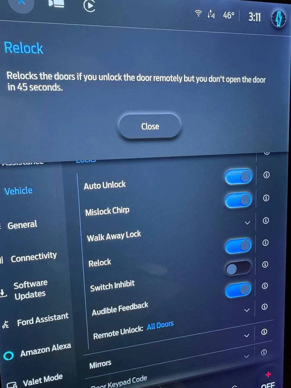

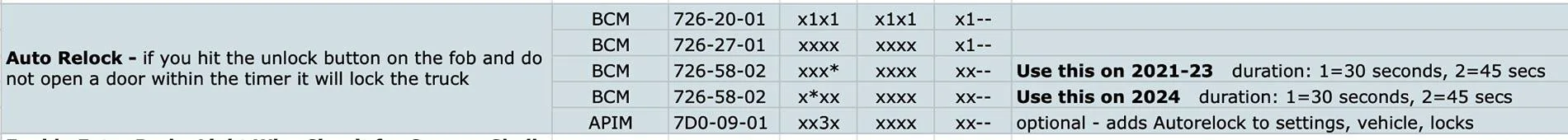

Noticed that Auto Relock is not listed in Post #1.
It is a nice feature especially if you accidentally unlock your truck with fob. The truck will Relock if door is not open within 45 seconds. After FORSCAN change is made it is switchable on/off from the Synch screen.
I made the change a few months ago, so I think the method is still the same. Although @bmwhitetx may want to confirm it. (Thanks again for all the work you've done here.)

@mrau, I added the auto relock mod as well. Thanks!
