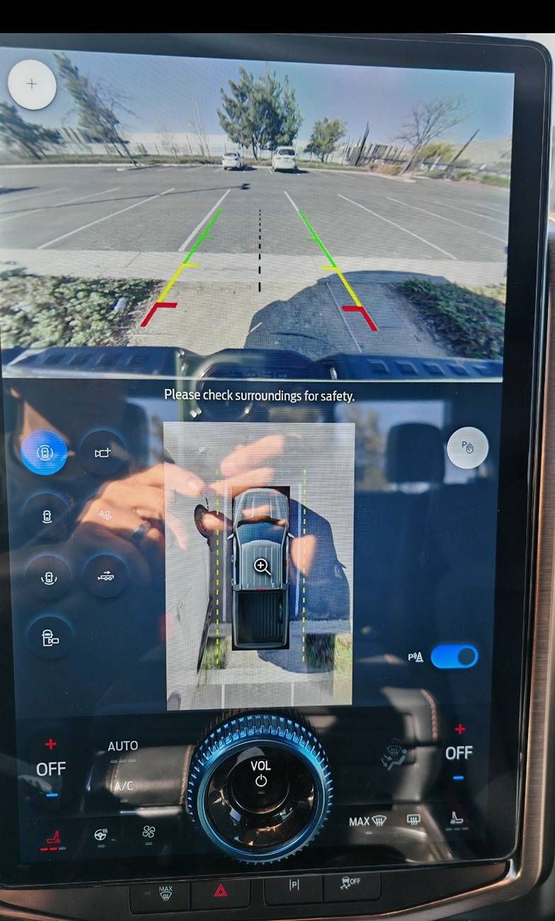

I just noticed after looking at a old photo of my screen that the 360 cam view is smaller, I'm not taking about small like after the front sensor update because that was even smaller. I'm wondering if it's smaller after the 50/50 view forscan change. Notice the menu button to select which camera view you want. Now the camera view is always in view.
