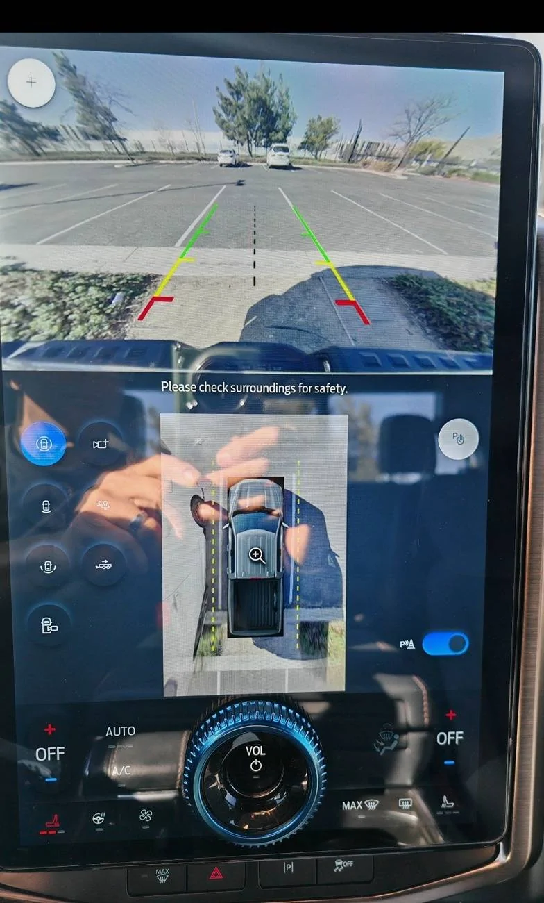

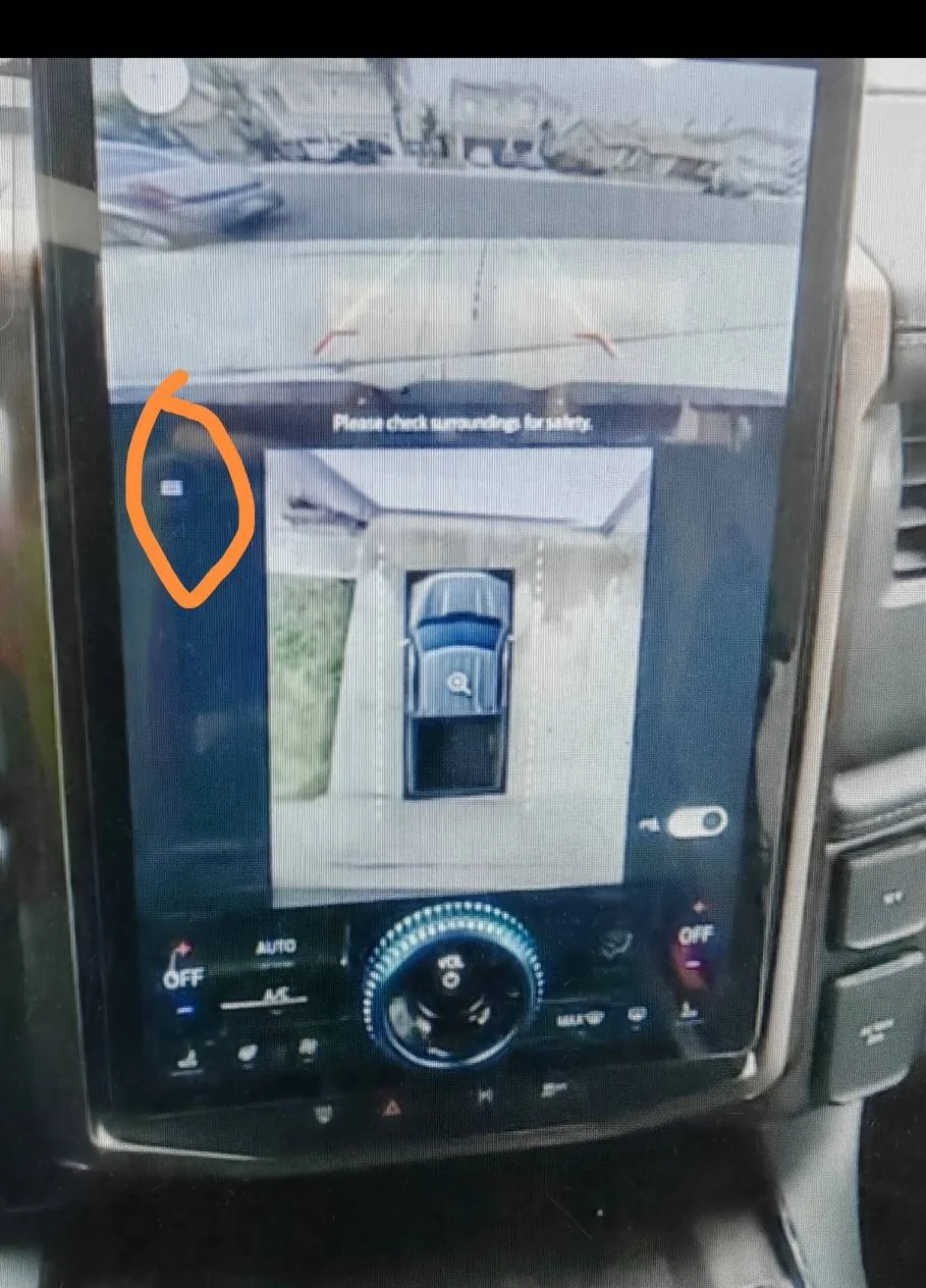

I just noticed after looking at a old photo of my screen that the 360 cam view is smaller, I'm not taking about small like after the front sensor update because that was even smaller. I'm wondering if it's smaller after the 50/50 view forscan change. Notice the menu button to select which camera view you want. Now the camera view is always in view.
I think that happened after a Ford update, not ForScan. I played around with different views and the one shown in the second photo is the best one.
Not sure the FORScan 50/50 changed caused that. Look at my post 113. The icon style was the same before and after I added 50/50. The only difference was the new icon appeared. The 2024s have this style out of the box so it may have been a Sync update that changed this.
When you say "played around with different views" do you mean going from my 1st photo with the menu button to open the camera views, or the 2nd photo with all the views displayed? I would like the bigger 360 view with all the camera selections showing.
No, I was looking at the available display options in Forscan and decided the stock configuration is best. I believe the original configuration is no longer available.
