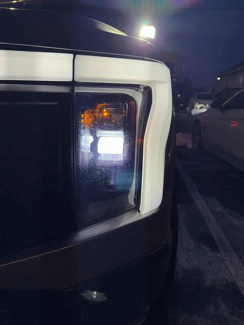

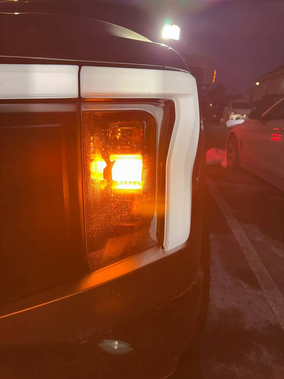

Are these not the DRL's? I would think there's some way to have them activate amber when on, but someone who is more versed in Forscan might be able to figure it out.
Agree and went out to confirm as well. I believe they are, just had not paid attention.
Obviously they have the capability to be amber, the question is can you make it do it full time. My gut says no since they are the DRL's. Maybe the Forscan gods will find it.
There is very old state and or Federal law that dictates what lights should be used for what, and maybe their color too.
A lot of people questioned Tesla on this. When the Model 3 came out the rear blinker was red. I think it has been updated on later models, the Y is amber I know.

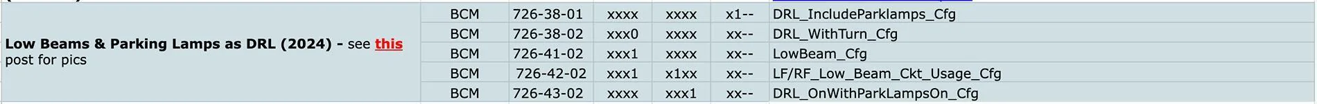

On the regular F-150 forum a member figured it out here, it appears that we have a similar setup with the DRL's also functioning as turn signals. I tried these values in Forscan but didn't have any success.

A few days back when it came up I went out to look at the front blinkers - they indeed are the DRL's that blink amber and the white light goes out while it is doing so.
Our blinkers are bright - when I am stopped at night with one on I see everything light up around - you can see the reflection everywhere.

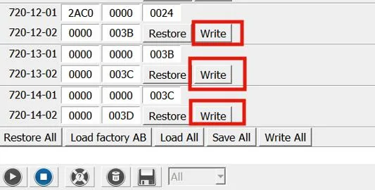

If there isn't a WRITE option next to a line changed (remove box on reverse cam) do you just "write all" at the bottom?

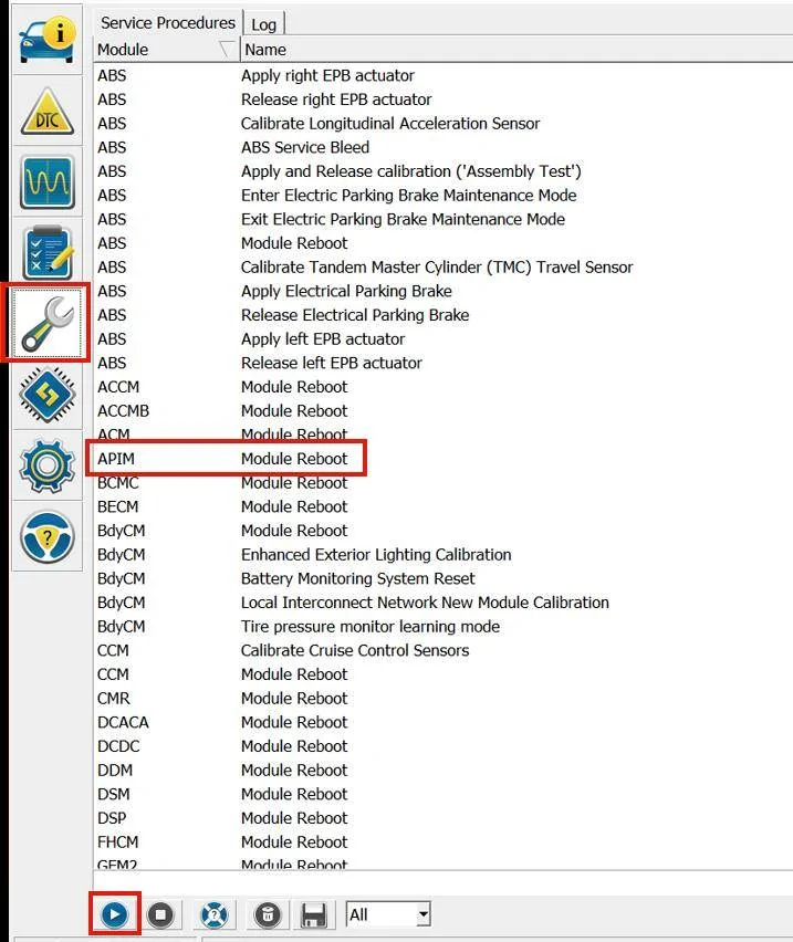

Reset apim- is that hold volume and next for restart?
Thanks!

Each subsection should have a Write button. For example 720-12 has a section that includes -01 and -02 like so:
Ford F-150 Lightning F150 Lightning FORScan thread - Version 2 1738162075787-hn
But if you change several sections them you can just do the Write All at the bottom.
To reset the APIM or any module go to the wrench icon and choose APIM - Module Reset and then hit Play at the bottom. Follow the instructions in the popups to turn off truck and wait 10 seconds.
Fuzzy screenshot:
Ford F-150 Lightning F150 Lightning FORScan thread - Version 2 1738162800398-w3
