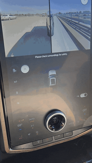

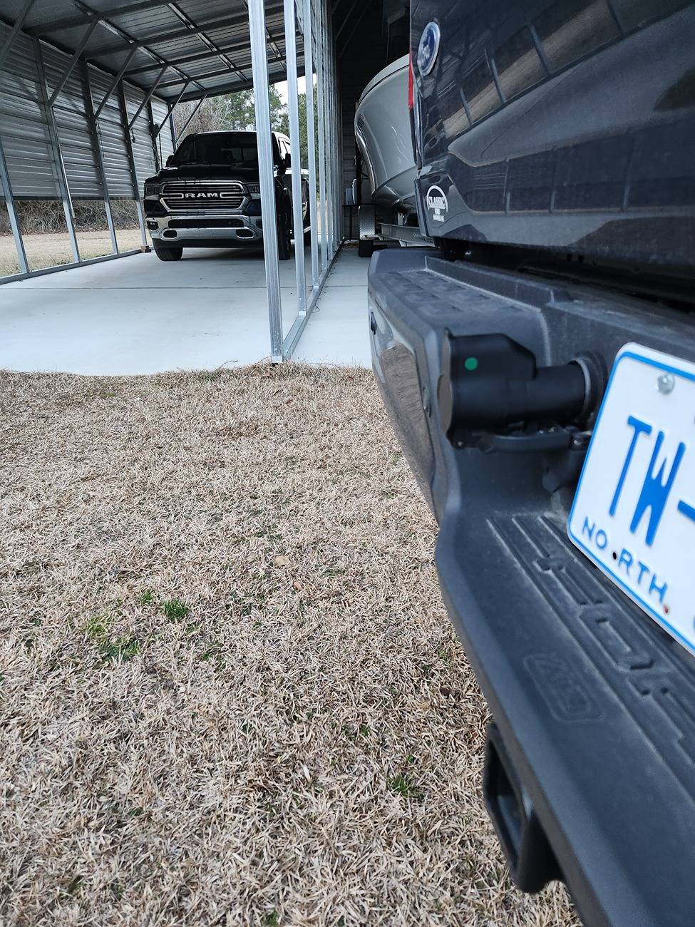

Well got one of the adapters to fool the truck into thinking I'm towing a trailer to enable the turn signal camera. Gif shows the 50/50 view and then the right turn signal.
After plugging in, it detects a trailer and you'll see a message that says blind spot and cross traffic disabled. I set it up as the smallest trailer possible which re-enabled the blind spot monitor (think that works on anything set up as less than 30ft) Blue Cruise and cross traffic alerts are obviously still disabled along with regular hands-on steering assist. It still pulls back if you hit a line but doesn't actively steer. Also disables the keep your eyes on the road message if you happen to be trying to drink anything.
Damn I may do this change tomorrow. Also what's that rear view mirror you're using?

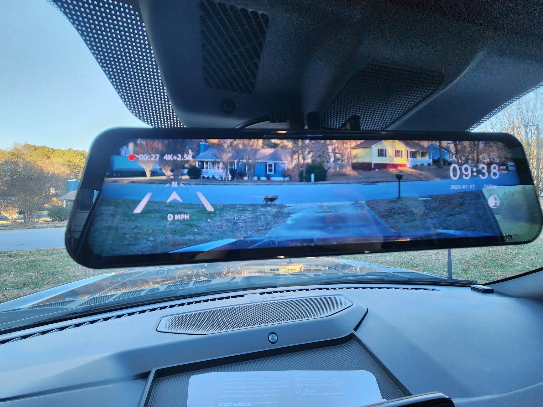

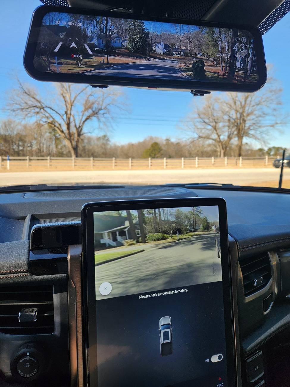

Wolfbox G900 Pro. It just attaches over your existing mirror and provides front/rear dash cams. Main downsides I've found are that it blocks the sensor on the oem mirror so the drivers mirror doesn't dim at night and there's some reflection on the mirror. Ordered a mat screen protector but won't be able to use it then as a normal mirror with the screen off.
Okay that is what I thought. Looks like a clean install too. I appreciate the feedback on some of the cons you’ve noticed. I’m on the fence about purchasing one.
Make sure to try one for a while before dropping a bunch of money.
With a regular mirror your eyes don't need to refocus for the change in distance. With a digital mirror your eyes have to switch focus from far distances (aka out the front window) to near distances (the screen).
I also find that with the digital mirror I have used there functionality is MUCH closer to the vehicle. With a regular mirror I can clearly see cars say 200 car lengths away, with a digital that was closer to 20.
Oh, and make sure the frame rate is high enough, ours have a low frame rate (may 23) and this causes issues on the edge of the fov.
I found them very nice to have on vehicles with blocked rear ward visibility but I dislike them everywhere else. I would rather have that screen elsewhere and not blocking the rear view mirror.
