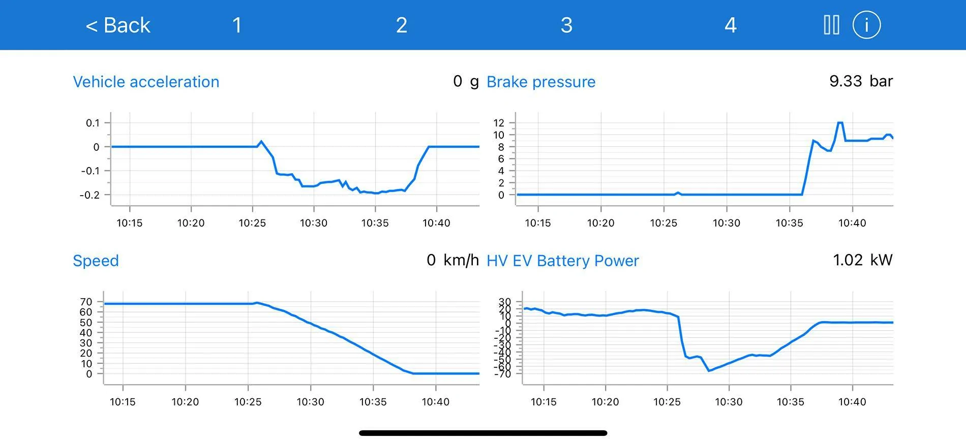

Here's a screenshot from CarScanner. It's a typical stop from 70 km/h to zero in two pedal drive where the brake coach says 100% energy returned. Note the brake pressure is zero until right at the end. Literally zero. The friction brakes are not used, at all, until almost at a complete stop, same as with one pedal drive. If you are seeing 100% on the brake coach then it is impossible to be any more efficient.
If you brake too hard, you see blips on the brake pressure graph, and the brake coach gives a number lower than 100%. In that case there could be efficiency gains. So, don't drive like that lol
