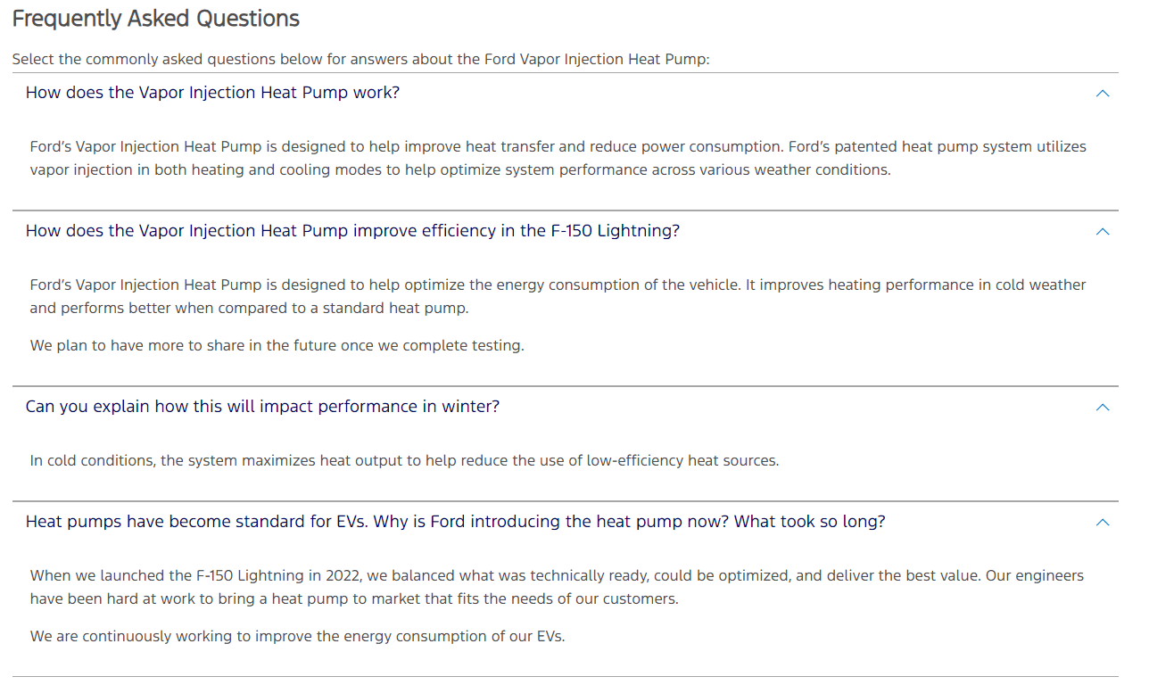

We can only guess, but I don't expect a notable increase. Will it help on a short trip vs the current heater? Sure. Or help a truck that sits at a cold jobsite everyday? Maybe. But significant range increase? No.
When Tesla added a heatpump the cold-weather delta was measured by various reviews - it was 3.2 miles/kWh with a pump, compared with 2.9 miles/kWh for ones without. That is 0.3 miles/kwh extra. Does not sound like a lot, but it is actually a 10% increase in range in cold weather which is quite significant. Since the Lightning has more interior room it has to keep warm, it may make even more of a difference.

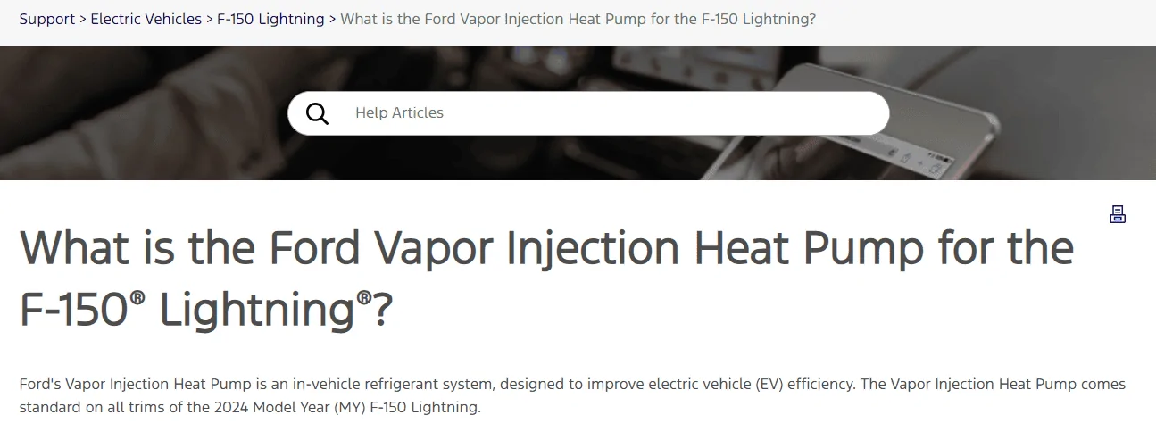

I just saw that Ford said the EPA range for the 2024 with heat pump is 240. The previous was 230. 240/230 is an increase of 4.3%. So, the ER might be 320 * 1.043 = 334.
I said it would be "negligible". That's pretty negligible.
sotek2345
Jun 7, 2021
3,876
4,665
Upstate NY
Engineering Manager
That is also mixed driving. The benefit will be less at highway speeds because you use less heat per mile driver the faster you go.
