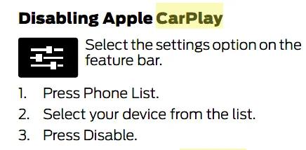

How do you do that short of turning off Bluetooth as instructed by the app?
To turn off CarPlay on the iPhone, go into Settings, General, CarPlay. Then tap on the name of your vehicle and turn off the slider.
On the Ford side of things, from page 537 of the 2023 Lariat ER owner's manual (v1.1):

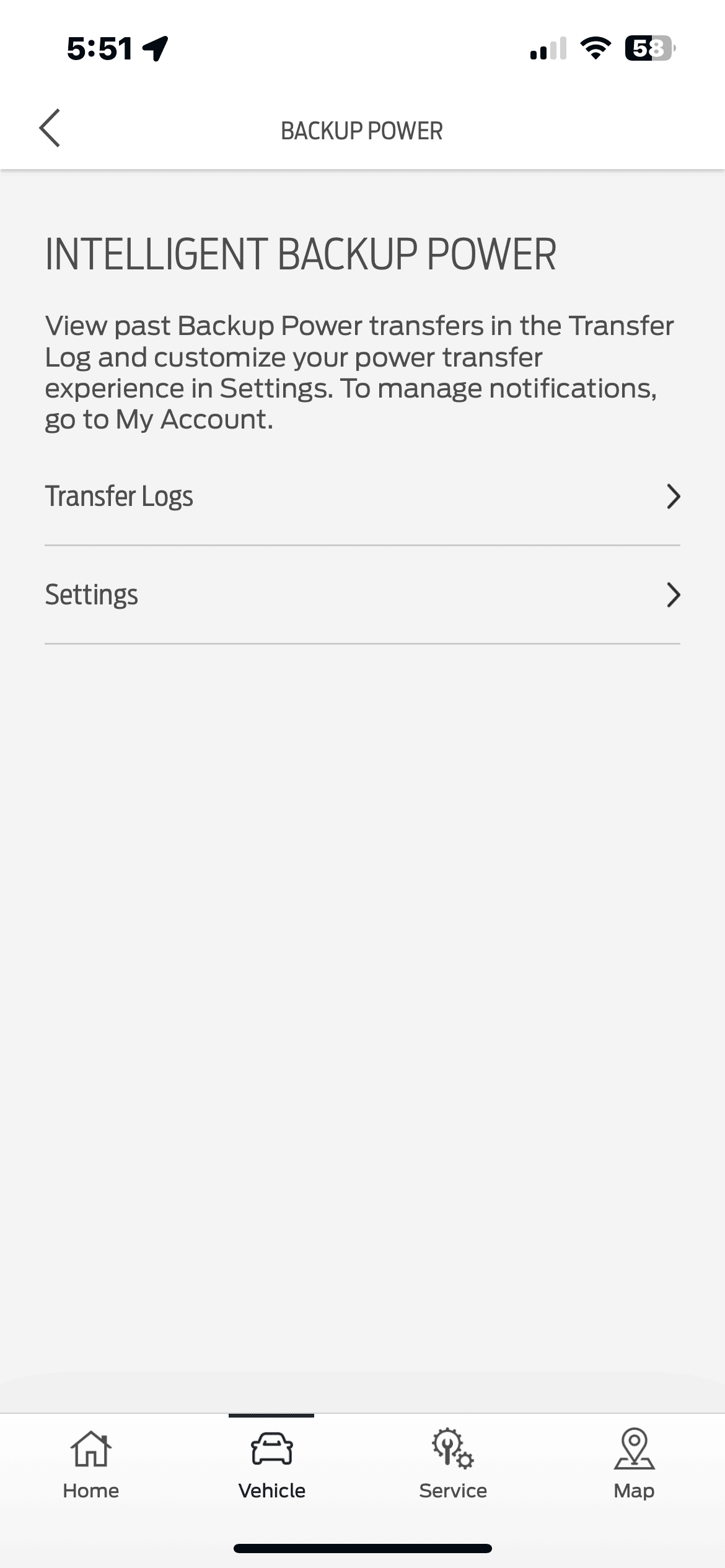

It appears the Ford Pass app issue has been resolved.
Curious what changed that leads you to this conclusion?
For the record I'm not a HIS owner, but watching this thread hoping you folks find solid remedies for this troublesome system.
I've noticed that Fordpass is responding more quickly transitioning from function to function [Home, Vehicle, Service, Map, Account, Charge Station, etc] this evening.
hifixenthusiast
Dec 13, 2022
60
Lighting Lariat ER, Taycan CT, Lyriq & Bolt
The Backup Power feature under the charging section is now functional again.

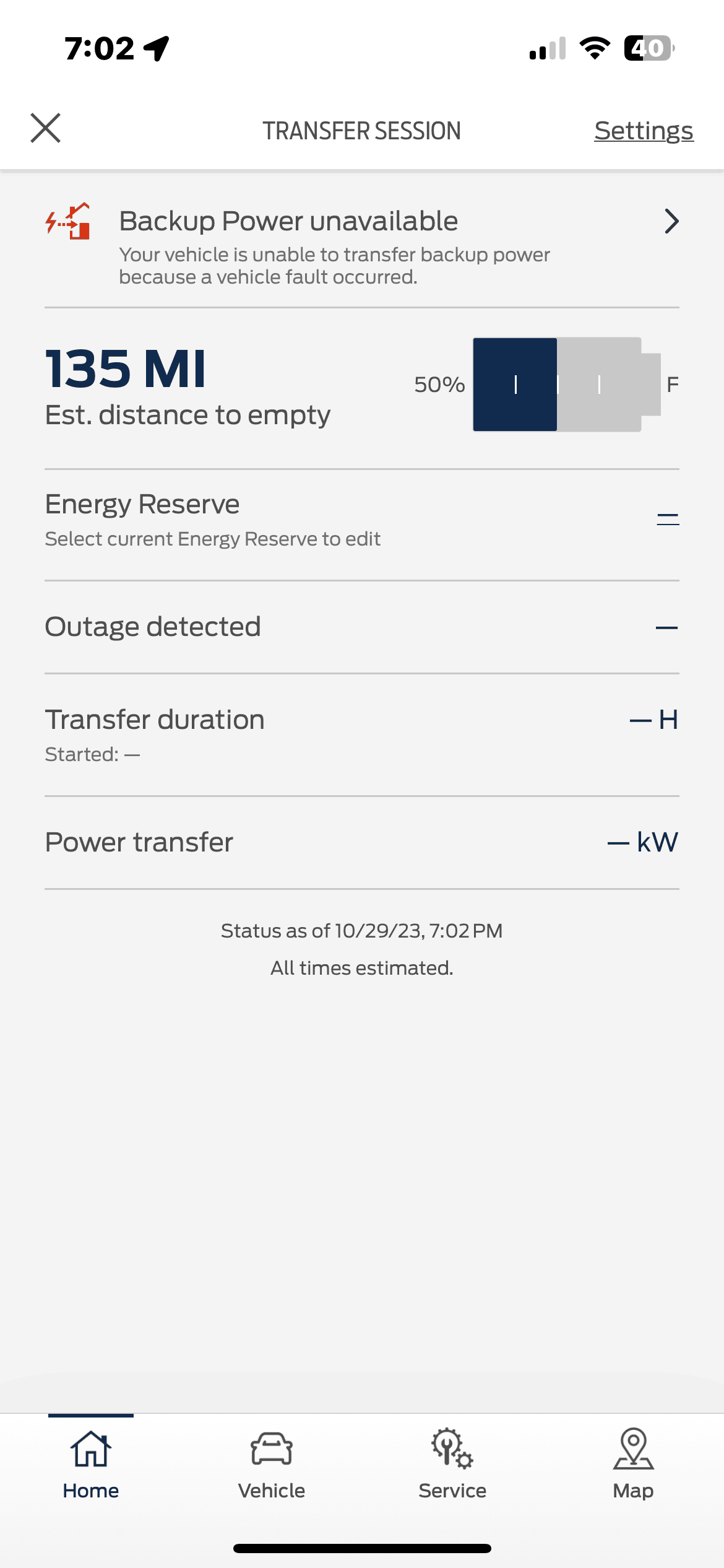

My Power Up 6.3 OTA update didn't come with any Intelligent Backup update included. My HIS unit still doesn't work. I was wondering how things were going for other HIS owners.
I noticed that @Aminorjourney (Nikki) updated her YouTube channel with a video reporting after more than a year that her system still won't automatically transfer power. She can get it to work off and on via a manual power transfer and provides a recipe for that at this point in the video
In the video, she states that most people with the HIS system seem to have it working now. I was wondering how it's working out for other HIS owners who've frequented this thread?
Also, Nikki strongly advises in her video that everyone steer clear of the HIS system. She thinks Ford may now be distracted by its UAW hassles and diminished efforts to promote EVs, perhaps even having let go of some of the folks trying to perfect the HIS system. (that might seem a possibility with the low uptake for the system by Lightning buyers, too). Another official future downgrade of the F-150 Lightning (is Ford going to be touting manual power backup via Pro Power Onboard?!).

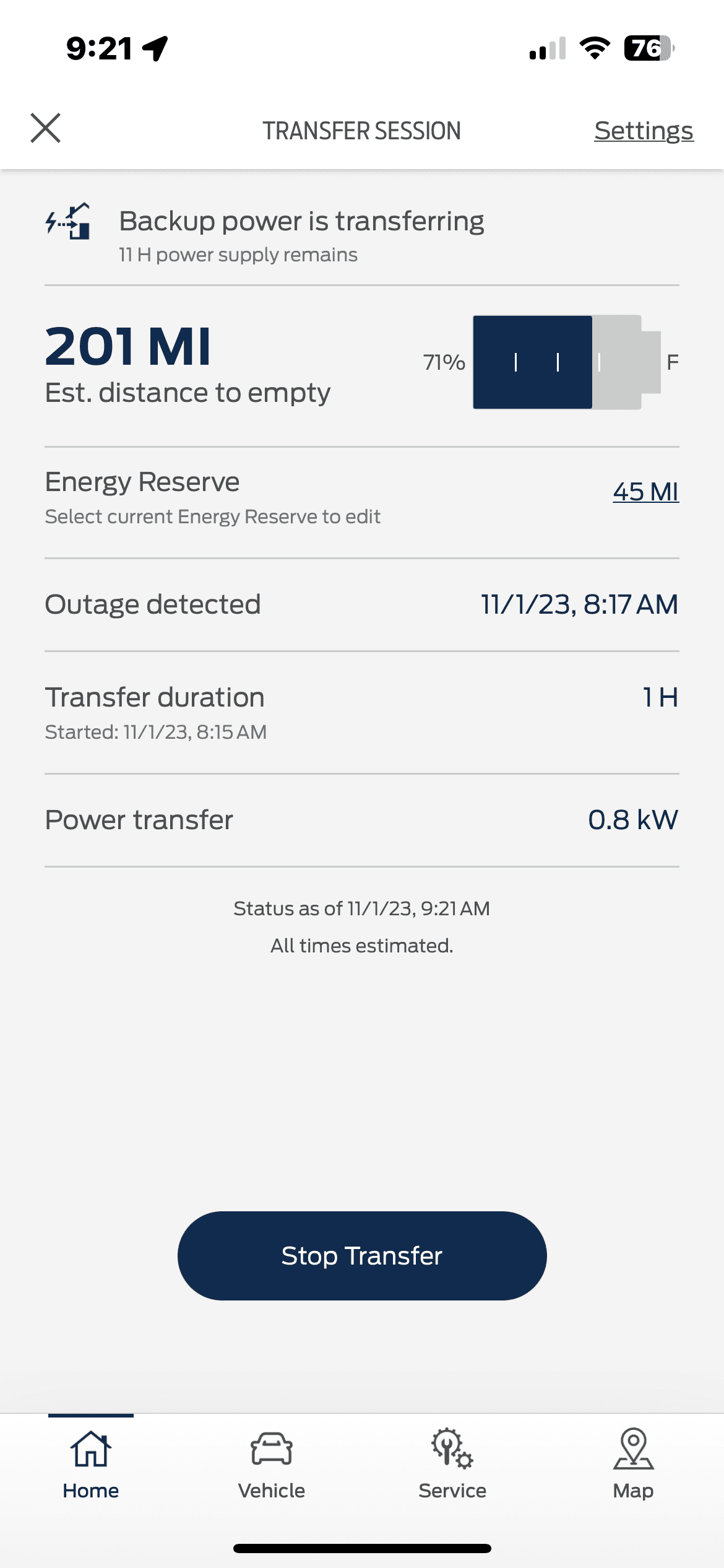

My HIS is still functioning, since my last post. I’ve had and reported FordPass issues to SunRun/Ford, but they haven’t impeded the system from working. All issues I have reported have been resolved in about 48-72 hours of reporting them.
Ford F-150 Lightning Installing a Home Integration System for Intelligent Backup Power (without SunRun) IMG_9261
So, can your system reliably and automatically transfer power when the grid is down and re-transfer when the grid is back (like a few times in a row)? I have looked and have yet to find any video showing HIS providing reliable automatic power transfer/re-transfer without issues. There are plenty of videos showing such smooth operation for generators.
hifixenthusiast
Dec 13, 2022
60
From the continued correspondence that I have had with SunRun/Ford, they are having daily stand up meetings discussing this system and the known issues with it. At least from my experience, they haven’t thrown the towel in on it yet.
So, the same OTA version (6.3) is working differently on different Lightning's?
Yes, my system has reliably supplied power to my home since the updates were applied to my truck and BDI. My FCSP already had the correct software version. There have been a couple FordPass application issues, but they haven’t impacted the systems performance. All of the FordPass issues were resolved once I reported them directly to my PoC at SunRun. My understanding is that they (SunRun/Ford) have a daily team meeting to review issues like this. The iPhone screen shot was of the last test I performed to validate that the system was functioning after reporting this issue with the FordPass application:

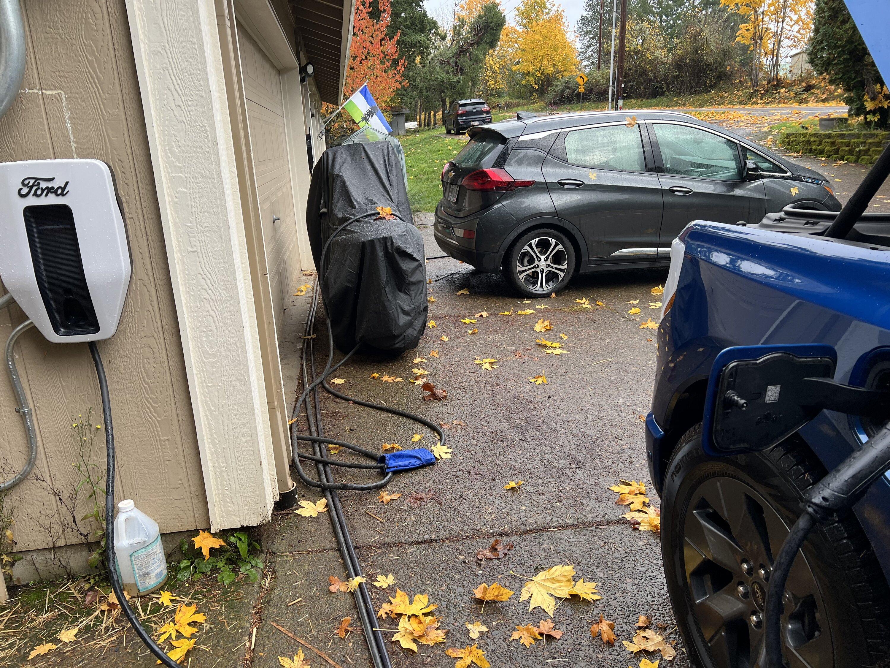

So... there's an update.
Ford has assigned me someone who is responsible for helping try to figure out how to get everything working - and on Friday we had a new FCSP installed at the house. Apparently I had an earlier version of the FCSP Ford was able to replicate being a pain at their headquarters. So, a new unit was sent out to see if that fixed the problem.
After spending 30 minutes trying to get the truck and FSCP to communicate, the engineer told me to park the truck so that the bluetooth module was closest to the FCSP, and eventually we were able to pair.
At that point, we were able to get a test session working without any issues, and then a second emergency backup session was established as the engineer was leaving for the airport. It ran for two hours, then failed, and the system refused to work any more.
Until that is, I figured out on Saturday morning that the truck could no-longer see the FCSP. The unit was installed on the front left side of our garage, on the outside wall, so that when the truck was parked nose on, the cable from the FSCP wouldn't have far to reach.
it looks however, as if even in that position, the bluetooth is too weak to reliably work. So I moved the truck, parking it so that it was parallel to the front of our garage, and at right angles to the FCSP.
It's worked multiple times since.
