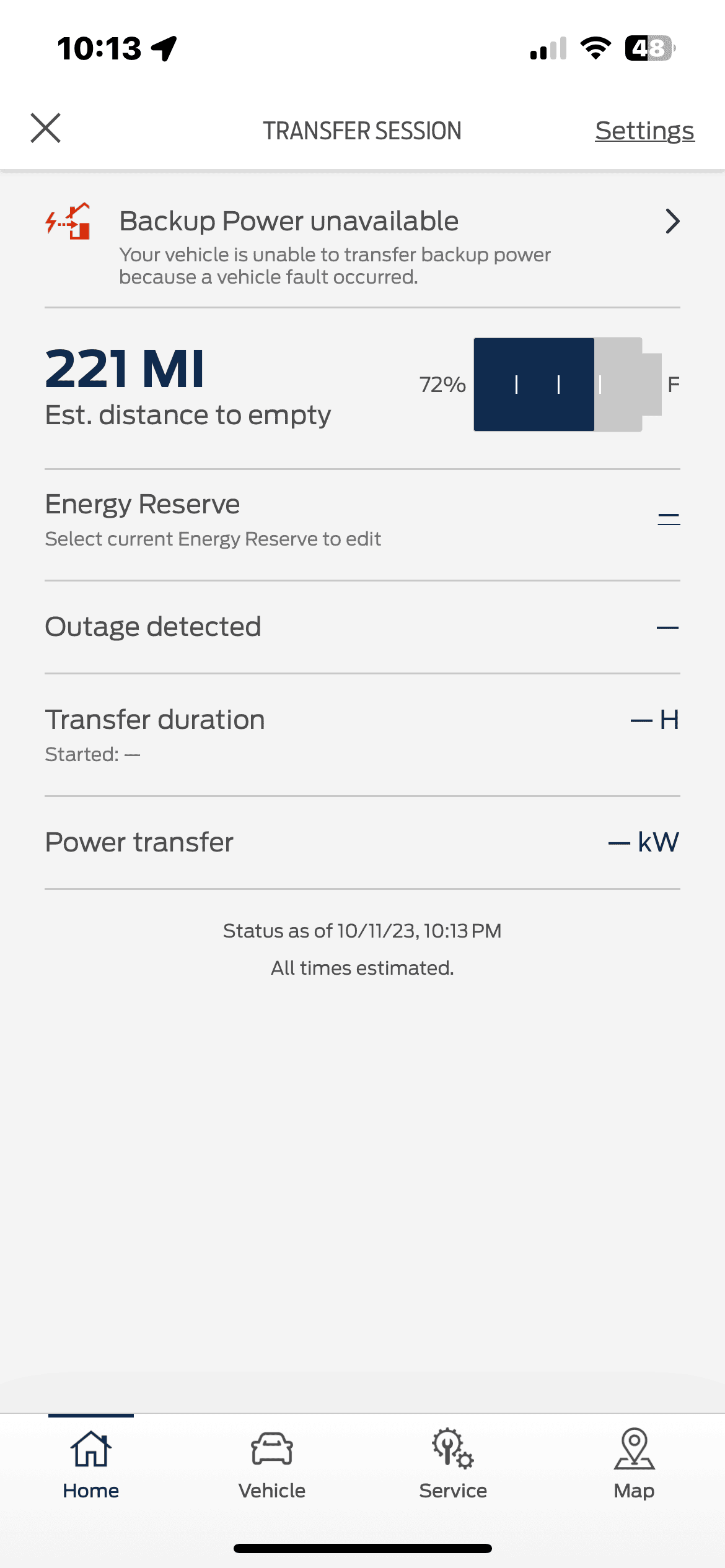

Ford/SunRun flew a team member out to my home to validate and ensure my installation was working. This included coordinating Ford to push Power-Up 6.1.0 and Delta to push the v21 firmware update to my inverter.
Did your distinguished guests say anything about when the rest of us HIS owners might get the required updates OTA or what's required to get that sort of attention in person from Ford and Sunrun? Sunrun has left my e-mail complaints unanswered.
The M Professional app shows a pending firmware update for my inverter. I can get it to start downloading via the M Professional app, but it never completes successfully. One time, the result was "failed," other times, the process hung somewhere between 28% and 70% download complete. Any hints from anyone on what is required to get the inverter download to complete successfully would be most welcome.

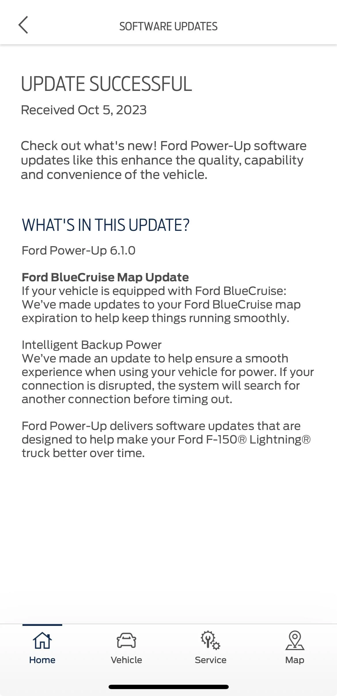

@Jim Lewis the team member expressed that with the release of this update, it has become a stronger priority for Ford/SunRun to resolve the instability issues of all early HIS adopters. It was represented to me that this was the first system to get the updates and Ford individually pushed the Power-up to my truck. The timeline wasn’t provided to me, regarding the widespread availability. But it was clear that the nuance and success of what was experienced yesterday was reported for the purpose of resolving this for other customers. This is a unified response between Ford and SunRun.
The SunRun team member also had to call Delta to remotely install the update, as it was failing to install when using the MPro app. My system hadn’t received an update since v18 and I had to manually install it then. I confirmed that the updates are supposed to be installed remotely and without customer interaction. The FCSP also has to be on version 91. My FCSP updated on its own weeks ago to this version.
Most of my journey has been documented here, but I was in the process of returning my equipment when this decision was made by Ford/SunRun as a last attempt of customer satisfaction. My Lightning had already gone through the battery module replacement as part of an early voluntary recall, which I am sure has also contributed to my specific circumstances. I was very skeptical about moving forward with this process, but I try to assume positive intent and I personally have been invested in getting this system working for 10 months. A huge weight of frustration and stress was lifted yesterday.
The SunRun team member was very knowledgeable and professional. It was clear that the team member was invested in the success of this system and being a steward of its user base. I’m glad to have met them.
I hope this issue is resolved quickly for everyone in this community!

Ford/SunRun flew a team member out to my home to validate and ensure my installation was working. This included coordinating Ford to push Power-Up 6.1.0 and Delta to push the v21 firmware update to my inverter. The Home Integration System is now performing like a champ. The firmware update fixed all BDI errors and allowed it to be configured with a working acrel meter. The inverter isn’t receiving automatic updates, so that has to be researched. But this was a huge step in the right direction. Where extremely delayed, Ford and SunRun’s recent response has been incredible. I officially have a registered and fully operational system that operates quickly and consistently.
OTA general distribution is out now for this:
https://www.f150lightningforum.com/forum/threads/ford-power-up-6-1-0-bluecruise-map-update.16961/
