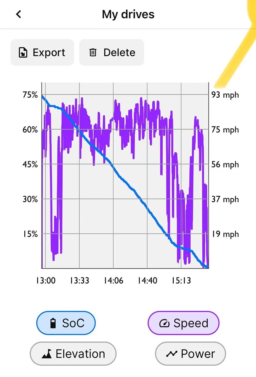

And just to clarify, I’m using true 80mph average according to OBD reading. We need to get on the same page on that as it can change the data drastically
Meaning if I have stretches of 60mph, I would need to go 100mph to average 80mph.
If we’re not using true 80mph average and we’re talking normal driving on local roads and on the highway set the cruise to 80mph, I find the OBD reports those as averages closer to 65-70mph.
This trip for example, I went 176 miles on 75% SOC, varying elevation, moderate headwinds and ended around 3-5%.
Ford F-150 Lightning Lariat ER slow charging is wearing me out IMG_5806
A quick glance would make you feel like that’s a 75mph average. I even touched 90mph at multiple points. The trip planner shows this as only a 63mph average.
So based on that, do I think you can do a true 70mph average, in the cold, with headwinds, with elevation, and go 200 mi on 80%? Not likely…I think it would be too close for comfort for most folks.
Hope this helps.
