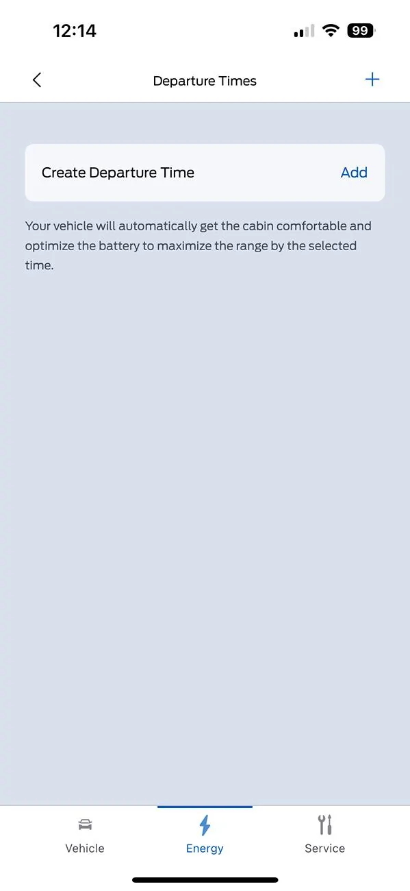

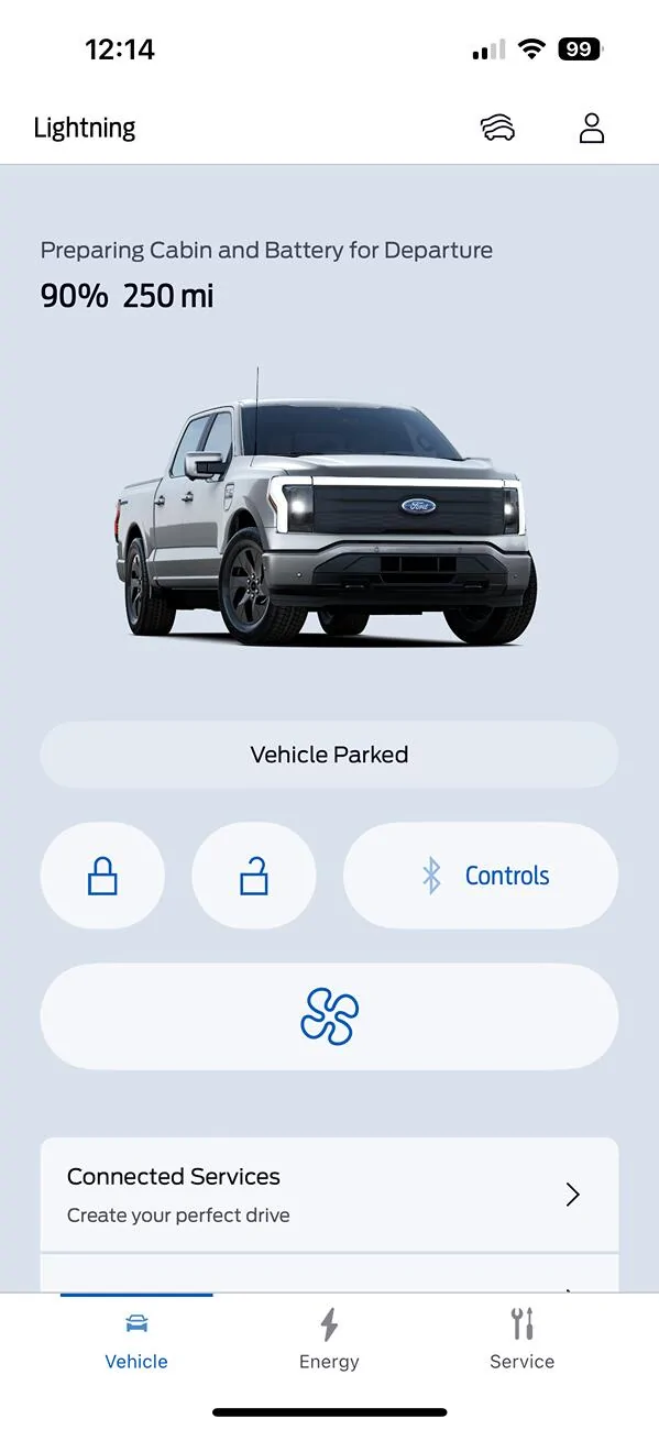

My truck is plugged in to the FCSP in an unheated garage and hasn’t been driven in two days. As with much of the country, NE Ohio has been very cold. I checked the app today and my truck was showing it was preconditioning for departure. There are no departure times set and have never been set for that time. Is it doing this to keep the battery at a certain temperature?
Yes

Yeah they try to avoid the battery getting too cold. I've noticed this twice today also with the temp in the 20's where it ran for about an hour and used 1kWh both times. When I checked the battery temp in CarScanner, it was showing the battery temp as 41F so a bit above freezing.

It is actually maintaining the battery temperature above 40 degrees if plugged in. I thought the same thing. So if cold (I park mine in a carport and today it was -4 degrees) the truck will attempt to maintain at least 40 degrees regularly. It will cost you about 30-40 minutes of house supplied power to the battery heaters a cold day.
