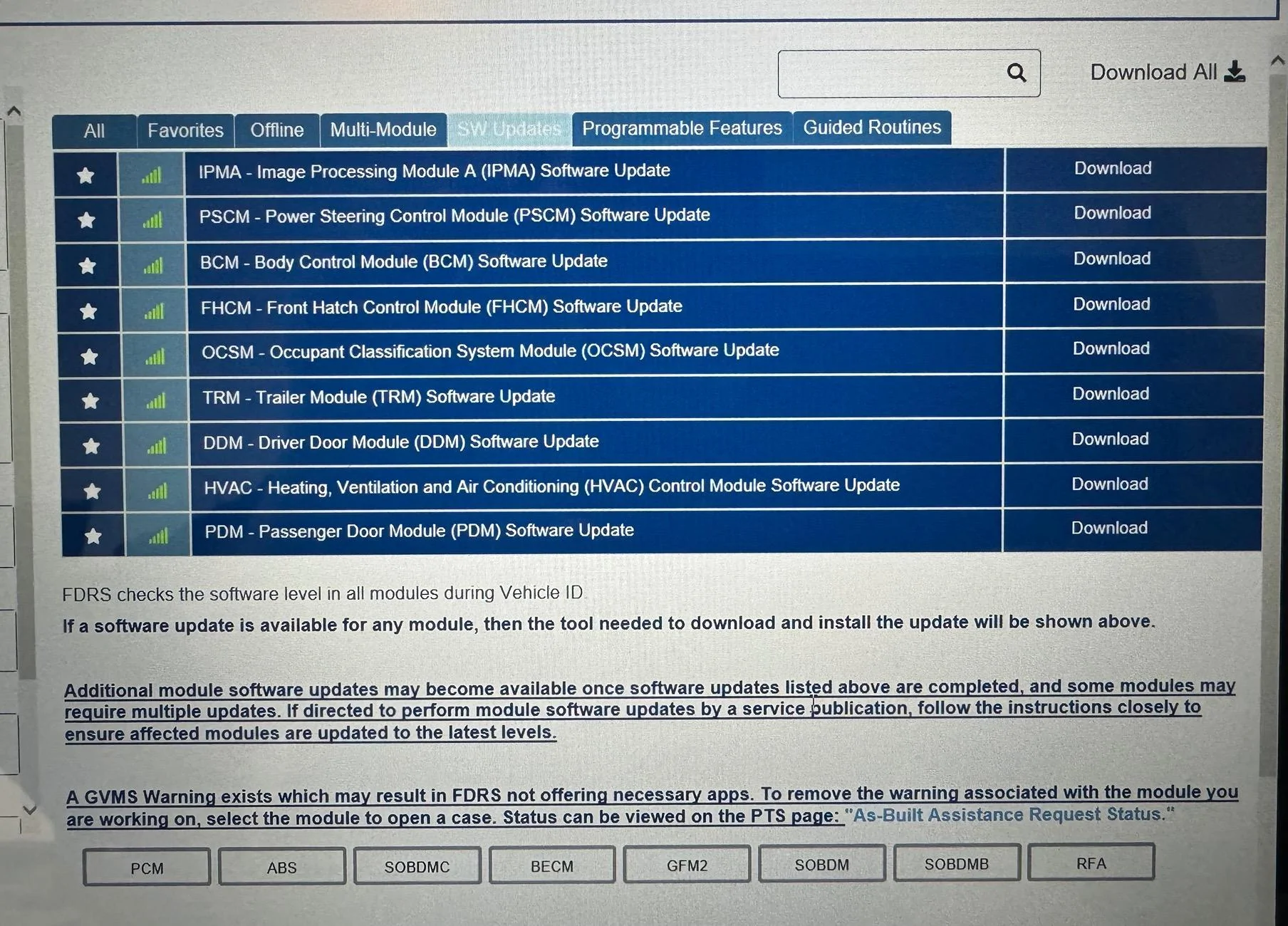

My truck is at the dealer for a shifter module replacement and I asked the dealer if they could update the BCM while they had it. They just reported back there are no BCM updates available. Could somebody look up my VIN and screenshot FDRS if there is one?
1FT6W1EV1PWG35822
1FT6W1EV1PWG35822
There are updates available for your truck. Sorry for my potato photo:
