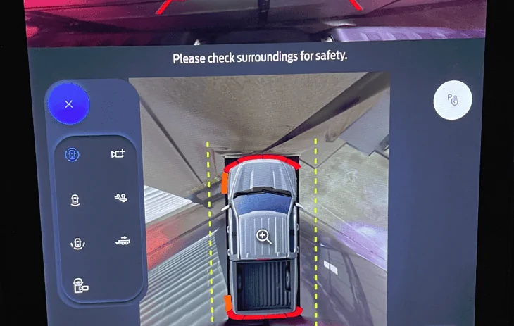

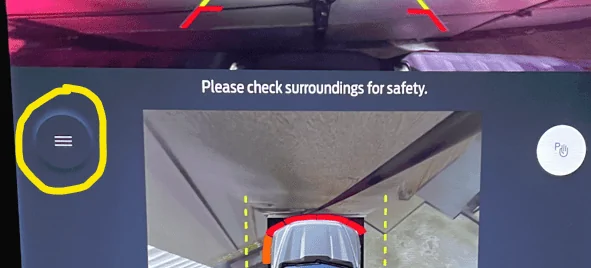

Another change I noticed is when you put the truck in reverse and the cameras come on the screen, all of the different camera angle buttons appear next to the 360 camera now.
I don't think the buttons were there before, but I could be wrong. I thought they only appeared when you manually clicked the camera button at the top.
You remember correctly. Took some screenshots pre-update. Putting in reverse, you get the 'hamburger' icon. Click it and the cams show up.

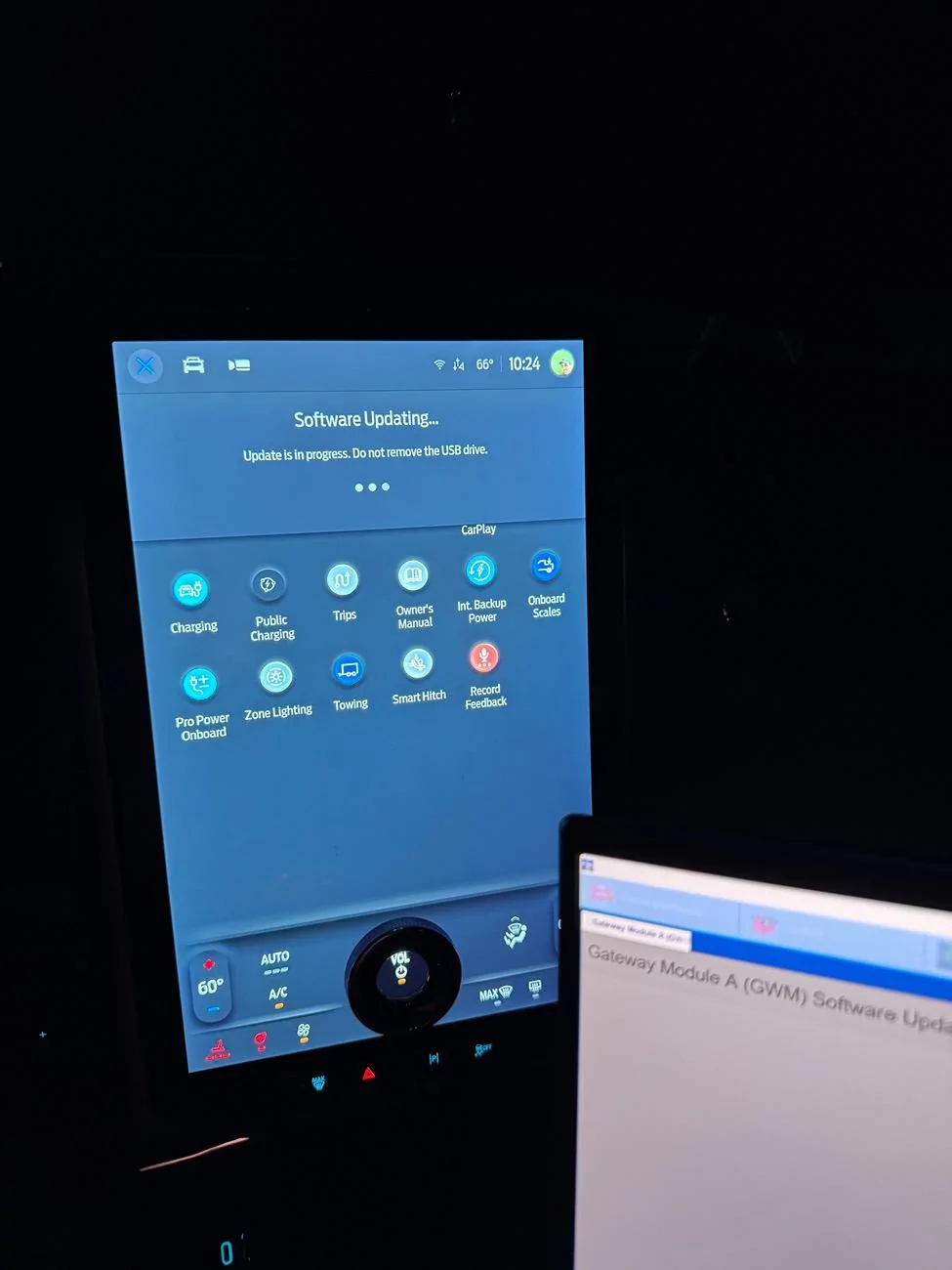

Got mine installed finally after doing the FDRS method again this evening.
My OTA method failed earlier this afternoon with what looks like a checksum failure on one of the files.
So retried the FDRS method and had success this time.
Mike G
Mike G
Jan 6, 2022
1,583
2,261
N. AL, USA
Came back out to the truck and finished up the APIM update to Sync 1076 and afterward since the APIM hadn't dropped off the list I re-ran the network scan and a new GWM popped up. One file about 170mg or so.
Truck is sucking that update in as I write this. So for those who've done the APIM update with FDRS you may not be finished yet :)

And now that the GWM is updated...I don't have the DTCs for the SOBDM or SOBDMC anymore.
Gateway revision is now rev. "-RCJ" if anybody's keeping track.

170mb file installed via USB in 7 minutes.
