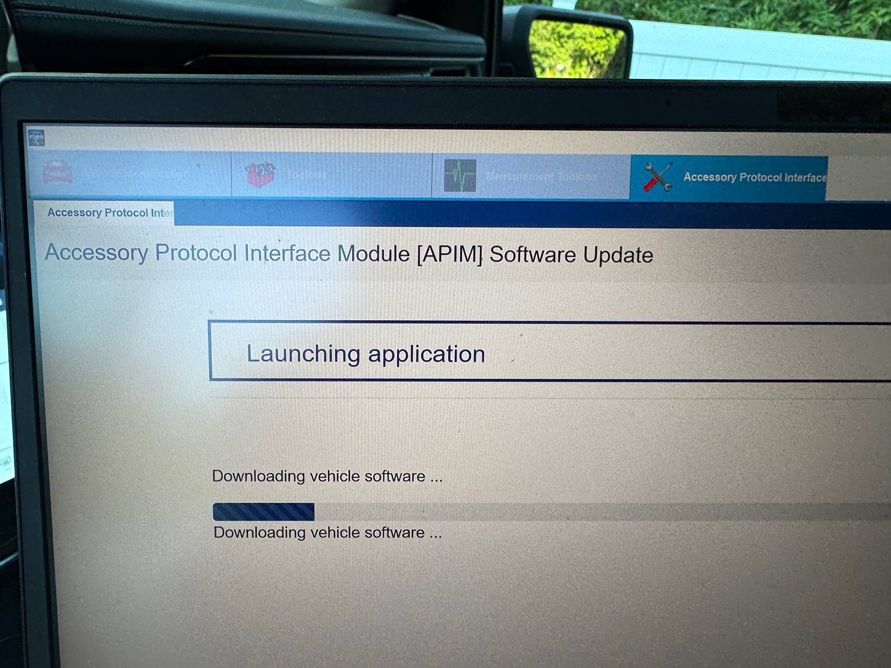

I have a 24 and was surprised today to see a new APIM (I updated that two weeks ago). I had logged in for the DCDC. Not sure how long this new APIM will take but I am about 30 minutes in.
While I like updating the car, it is getting a bit boring doing it (especially for two cars). I am going to space it out and maybe stay off this thread to remain blissfully unaware!

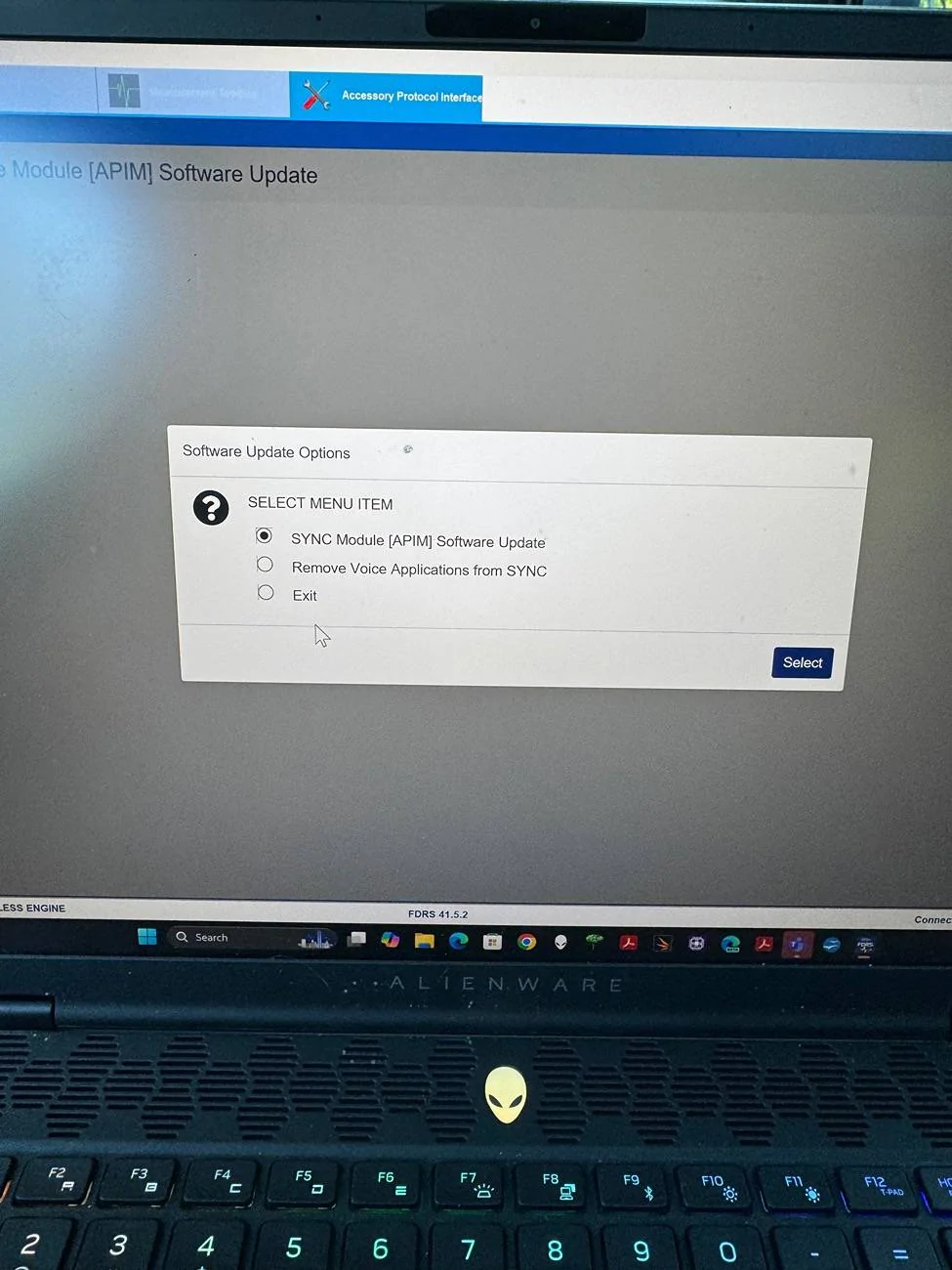

Like most (all?) APIM updates it's a USB install. 6 gigs . I had this screen pop up which I don't believe I've ever seen before .
I got that pop up the last time I did the new UI 6 GB update a few weeks ago. Got it again today, only seen it on these two 6 GB updates.
