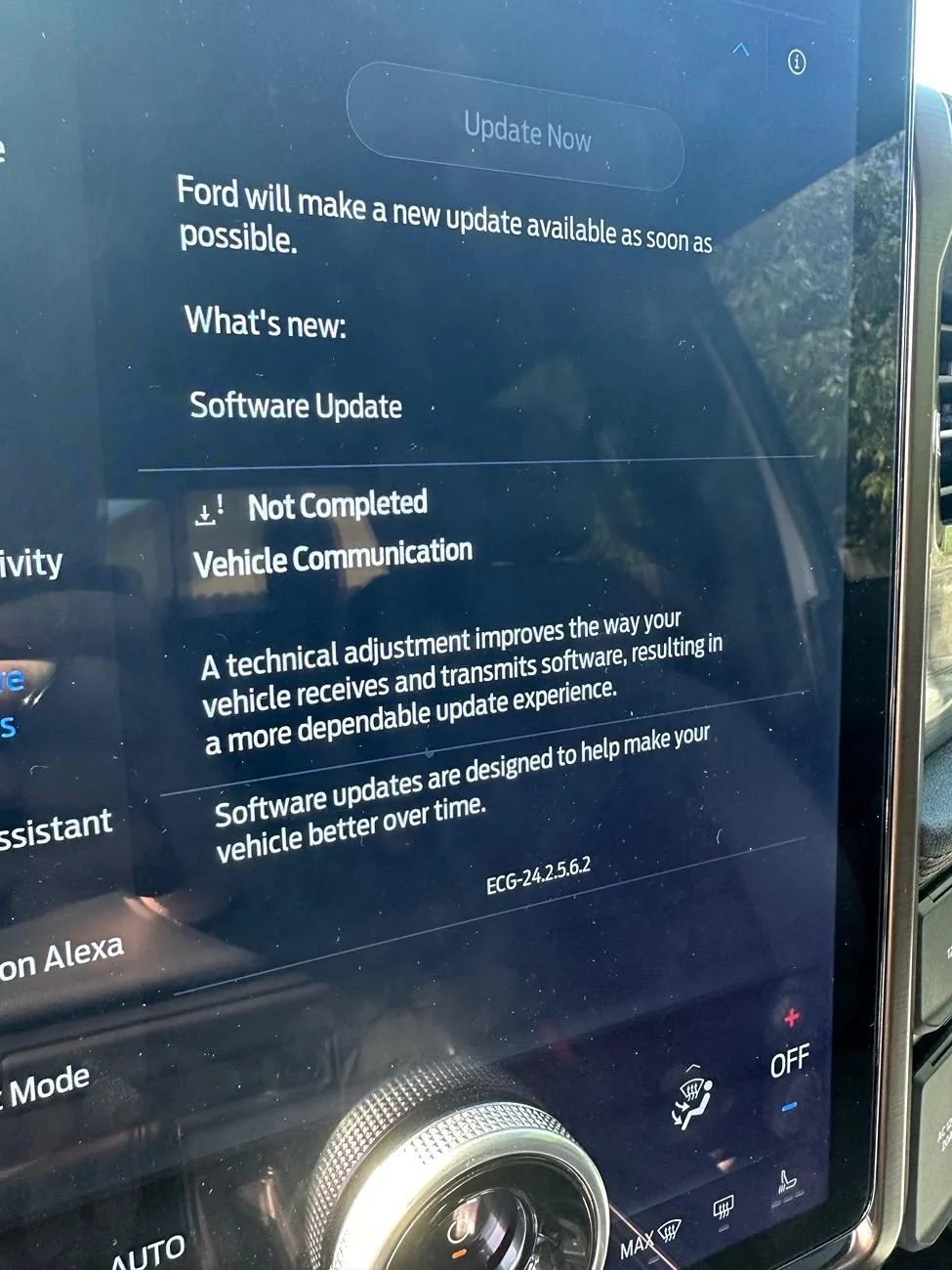

Ford F-150 Lightning Lightning Software Updates using FDRS IMG_2490
My first OTA in 14 months. I guess doing the updates through FDRS put my truck back in line for them.
However, it’s show as Not Completed.

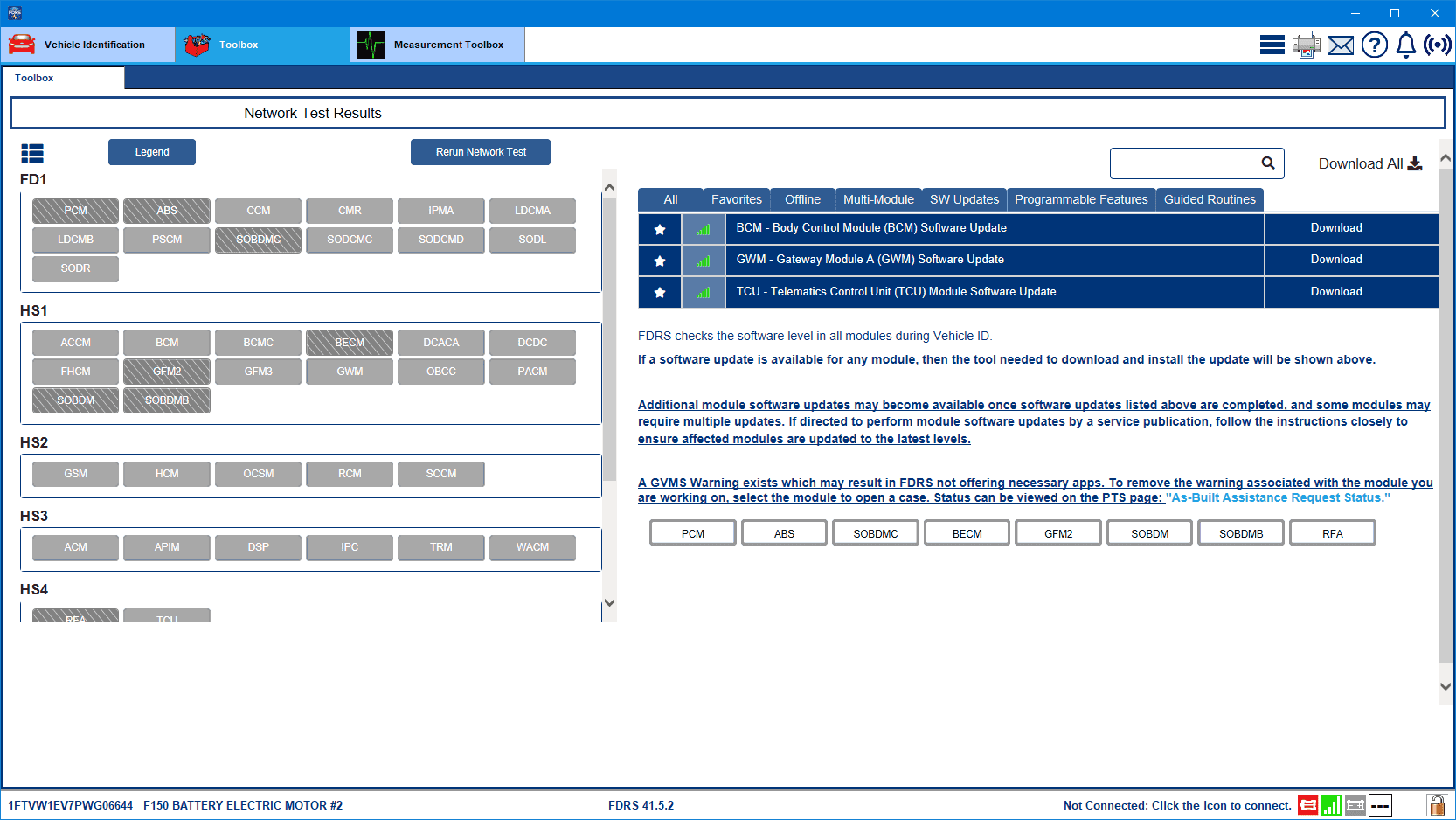

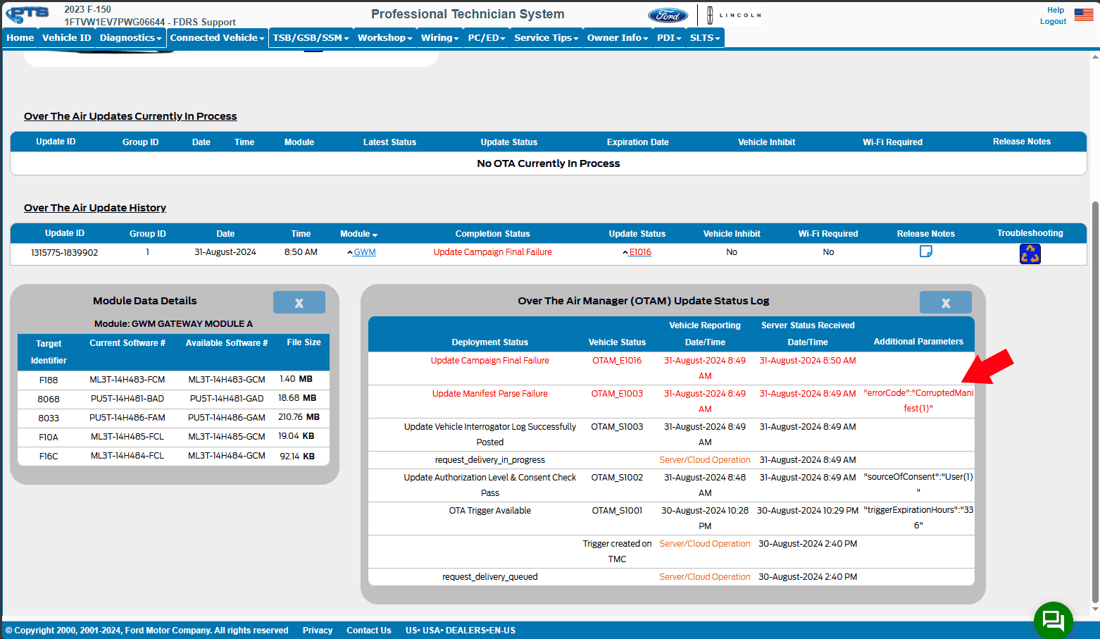

Ford F-150 Lightning Lightning Software Updates using FDRS 1FTVW1EV7PWG06644-31-Aug-24OTA
Time to get out the gear and the USB drive again....
Do the GWM first then the TCU.
