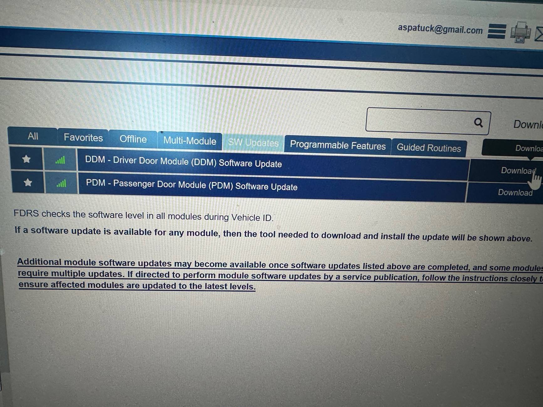

For some reason my software check in the truck got stuck at "Getting the latest software updates...". I am on 6.14 and it just started doing this about a week ago. I thought it would fix itself, but nothing changed as of today. Checked connectivity to make sure it wasn't turned off and it was on. Tried pulling fuse 32 (didn't help), but disconnecting the LVB today for 10 seconds fixed it.
Before I fixed it, I was trying to install a FDRS APIM update and the truck didn't give me the normal popup even after waiting 10+ minutes. After taking the LVB off for 10 seconds and starting back up, the USB got recognized almost instantly and it is now updating.
EDIT: APIM update finished, but I don't see anything obviously different. I also did passenger and driver door updates and some dc one as well in FDRS. No updates after several refreshes, so looks like I am caught up. Software update screen in truck still works and shows the last OTA I got (6.14).

I reported I believe earlier in this thread I had the same problem - my update check screen was stuck. I also pulled the battery cable last night and then it worked again.
@rugedraw had suggested a week or so back I reboot a couple of modules with Forscan, but that was before 6.14 downloaded for me. I received that update and then the freeze.
Ford has something amiss, but at least I'm checking for updates again.

@Robob and I were discussing this and I did disconnect the battery this morning. I’m now enjoying a second cup of coffee and watching the Sync screen “Software Updating…” banner as a result. Yesterday my truck refused to upload the new APIM update at all no matter what I tried. And like others I was getting the never ending Check Updates thing that never finds anything.
Hopefully all good now.

The next time I see this on either my Lightning or the Mach-E I'm getting the 10mm wrench out and disconnecting the 12V battery before trying anything else. I spent over two hours yesterday chasing FDRS configuration, USB formatting and re-formatting, manifest issues....And all it needed was a short nap to come back to it's senses. I think it was caused (maybe) by that short gateway update OTA we got before this APIM update showed up. I realize not everybody had the same experience I did and some got this update without any issues at all. But I definitely learned something from this.
Props to @Robob for suggesting this to me this morning!
