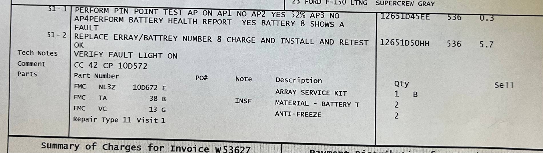

I got my truck back today, 9 days after I brought it in. They actually called me a couple of days ago and said they were working on installing the new array but the tech didn't like something about one of the parts so they ordered another, hence another couple days delay. I had 10k mile service and they did updates for the front hatch control module and front parking sensors. I had to gas up the loaner they gave me before I returned it and had to roll my eyes at the $95 it cost me... :rolleyes: but as I mentioned before, I am going to try and get this reimbursed by Ford, the service manager gave me a number to call for that.
First thing I did was go to a DCFC and make sure that worked which it did. Then I plugged it in when I got home and sure enough, works as it did before. All in all, it wasn't a very painful experience since they provided a loaner. Maybe I just have a better Dealer here?
Keep an eye on the coolant, couple reports of it going low as things settle. Also, there's a post somewhere that explains it'll take a few weeks for the BMS to fully settle in after a module replacement. Don't fret if you see your range est get a little wonky (at least more than usual).

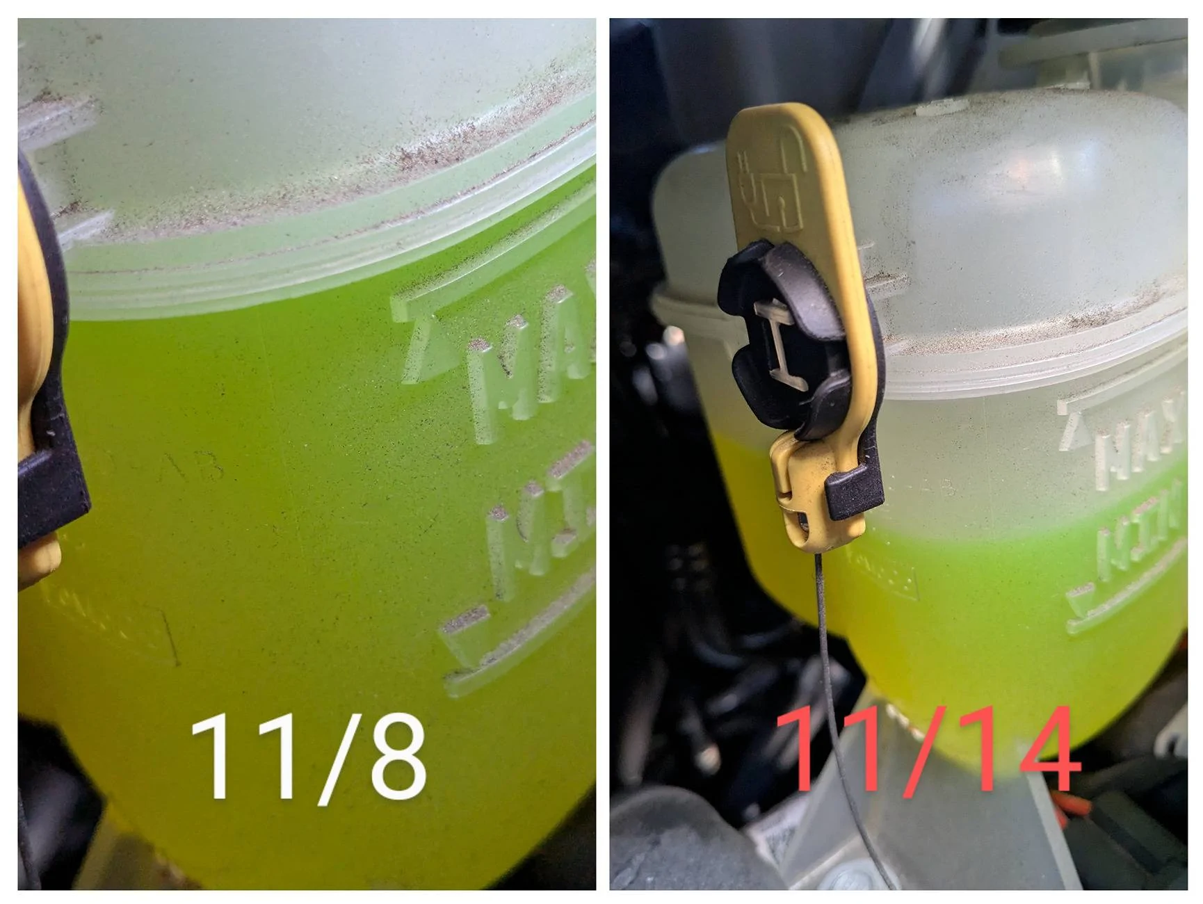

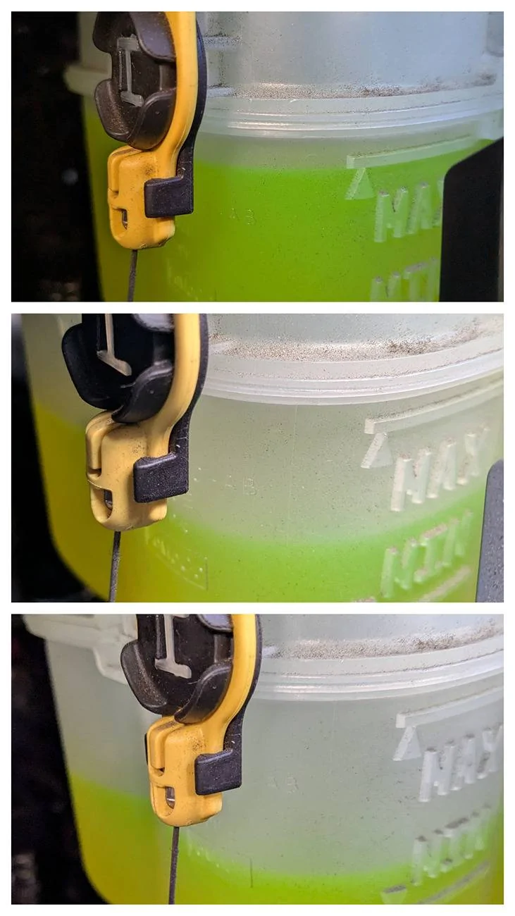

Second this on the coolant level. They never bleed the systems correctly (assuming they put it back together correctly). Mines down over an inch since having it back for a week for the same thing.
