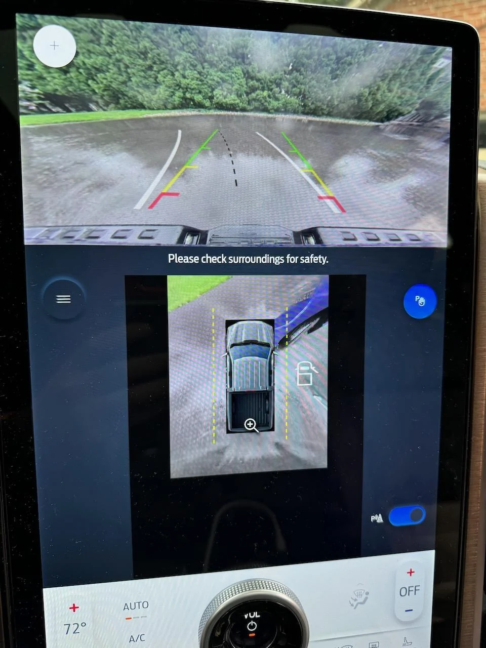

Everyone who received this update, please post here if your 360 degree view shrinks. Thanks!
Anyone know if the dealer can reinstall this update?
Did you ever get this fixed?

No. But also not sure if this recent update fixed it. I’ll have to take a look.
If this is the issue, you can fix it with FORScan. Go here:
7D0-01-04
xxxx xxx3 xx--
You are showing a 2 there. Change it to a 3, write the change and reboot the APIM.
7D0-01-04
xxxx xxx3 xx--
Yeah that’s it!

Just checked and still the same after the update. Any chance that a future update will fix this or is this something I need to do myself? I don’t have Forscan. Will Factory Reset fix it?
No, reset won't do anything. Dealer can fix it, but rather than go on that hassle, I'd just get the $35 adapter for FORScan.
