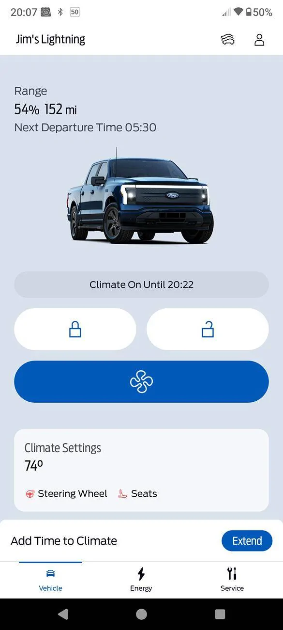

I just tried this on both iOS and Android. The Auto does seem to correctly set the heating or cooling, but heated seats and steering wheel is manually controlled. This screen capture taken after I manually started climate. Notice it tells what it is doing and if you click on that section, it lets you change any of those settings.
Same for me. Everytime I remote start the truck (or schedule departure) it will automatically adjust the temp/seats/steering wheel according to the current outside conditions.

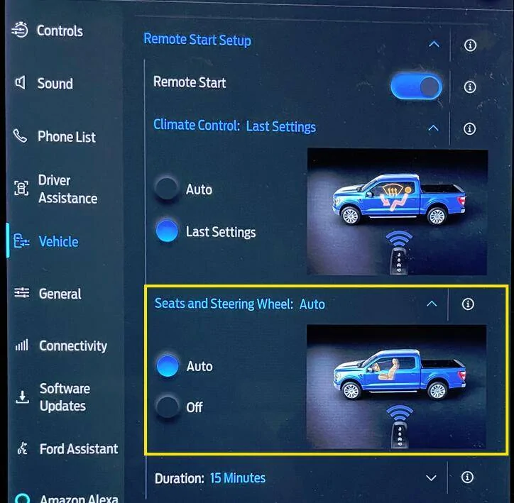

FYI, seats and wheel are a separate setting from cabin temp under Remote Start. You may have those set to off.
