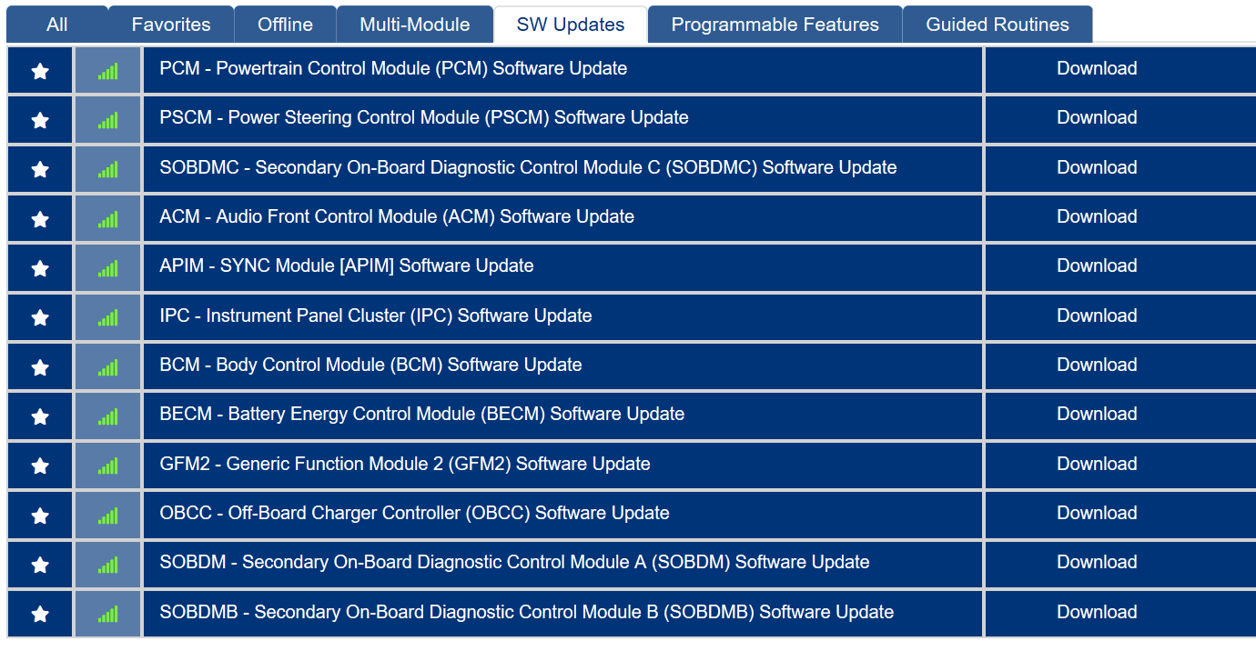

Many Lightning owners have messaged me to look up their VIN to see if this update is pending for them, and I have not found a single truck with an IPC update pending. it is my opinion that Ford pulled this update for some reason.

My dealer also performed the FDRS “update all modules” at my request (and expense) with the same result. I’m sorry there’s this mystery of inconsistent updating between trucks, but it’s somewhat better to know we are in the same boat. Thanks for posting.
Same boat here, 23 Pro. Dealer checked everything and @rugedraw helped with FDRS as well, no IPC update pending :(
Interesting. So I had looked up my VIN in FDRS back on 10/8/23. I took a screenshot:
Ford F-150 Lightning SOC Display in Instrument Cluster? Screenshot 2023-10-08 195559
I assumed that all of the above meant I had pending updates for those modules. But maybe not. Like I mentioned, I was mostly curious and have never actually used FDRS to do updates.
