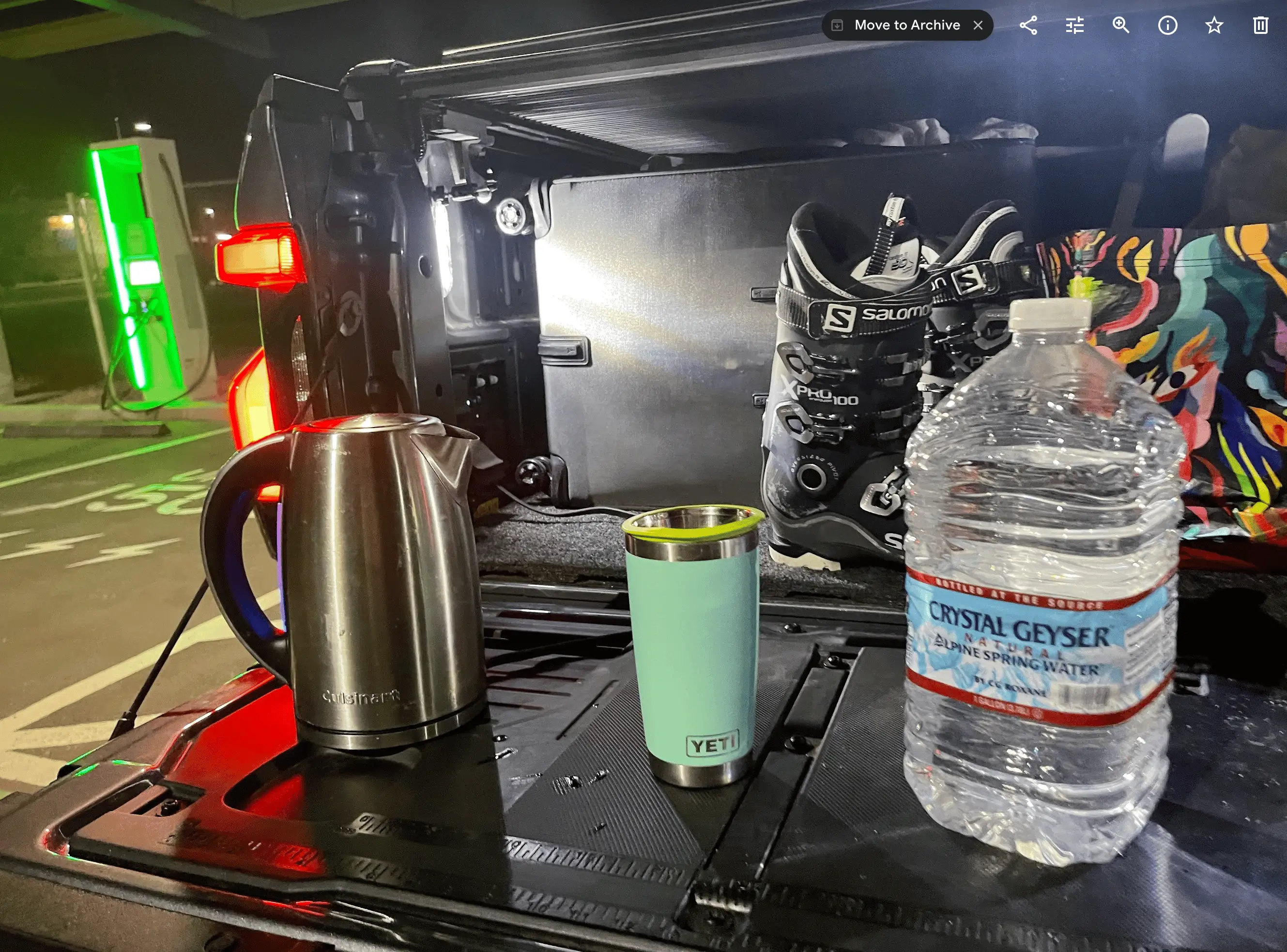

So they won't be able to get anything out of the bed whilst supercharging?
Or make a nice hot drink?
haha, nice. My GF got me a whole coffee station to bring on ski trips for apres ski coffee.
Ford F-150 Lightning Supercharger cables are too short for the Cybertruck IMG_2367
