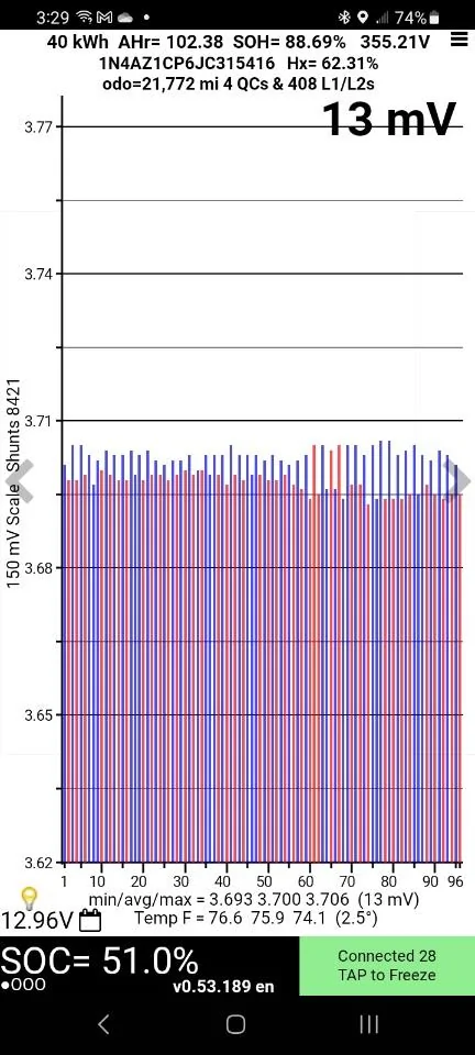

In Japan, the original Leaf's batteries are out living the vehicles. Nissan is now repurposing the used modules into power banks.
Ironic too, since the Leaf battery catches so much smack for its lack of thermal management. Definitely an issue for those use case scenarios that can torture such a battery. But there are so many Leafs that enjoy a long life in a low stress environment.
There needs to be some kind of testing and reporting process so that people will have confidence in status of the replacement batteries.
I would indeed want the equivalent tool(s) for any EV that I own that all Nissan Leaf owners have access to.
It's a smartphone app written to read/report/monitor the onboard EV parameters through the OBD port. Certainly makes it easy to see the most important values of a used Leaf. You instantly see the SOH of the HV battery, along with the charging history. And for monitoring your current Leaf you get REAL SOC, as well as things like battery temperature and realistic mileage estimates. You can even view the live delta between every battery cell/module's voltage.
A 5 year old Leaf on the Texas coast:
Ford F-150 Lightning When do you plan to replace your high voltage battery? 1000018232
Every EV make/model needs just one nerd-genius to develop a similar app.
