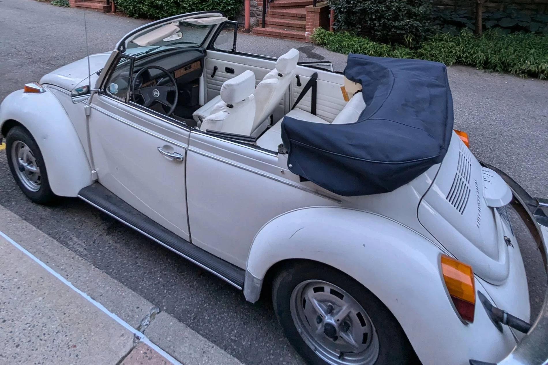

Or maybe -- just maybe, you know -- I'm a non-"flatlander" who spends a ton of time driving and riding 4 and 2 wheeled vehicles on loose surfaces, who definitely knows what you're talking about, but who doesn't agree with you. Managing how much power you put to the road is definitely key to maintaining (or regaining) control on loose surfaces, but "none at all while I shift in and out of gear" is not a management style I favor.
I learned to drive in a rear-engine, stick-shift, air-cooled VW. You want the wheels disengaged from the engine? There's a pedal just for that. But I wouldn't advise moving it all the way to and from the floor on gravel, sand, or snow. Feather the clutch for less traction? Sure. Lug the engine a little in "too high" a gear to manage torque? Sure. Jam the clutch to the floor and keep it there (much less hit neutral with the shifter while trying to manage a slide)? Nah. Doesn't work for me. If it works for you, sure, do it. But please stop throwing around insults.
I find feathering the gas pedal in 1PD mode to be a very effective way to manage traction. It's no problem for me to find that middle point where the vehicle free rolls - or to feather just to either side of it for a tiny bit of drag or a tiny bit of gas. It's not as easy on the Lightning as it was on the Model S I used to have, but it's a little easier than on our Model Y. The jury's still out on the Mach E - though the friction brakes on the Mach E are so grabby, winter driving's definitely going to be all about touching them as never as possible. I definitely prefer the Lightning in 1PD mode in the winter; more than in the warm seasons, actually.
Here is a picture of the aforementioned VW (Well, one of them. This one's actually better in the snow than the Microbus was, but the bus had...other winter advantages). It's about to go home to Europe where another generation will learn to drive in it - my nephew on my sister's farm in Norway. Snows there a bit. Though come to think of it, I guess the first thing I ever drove was our 1960-something Massey. Definitely not a fan of letting that thing freewheel in the slippery...
