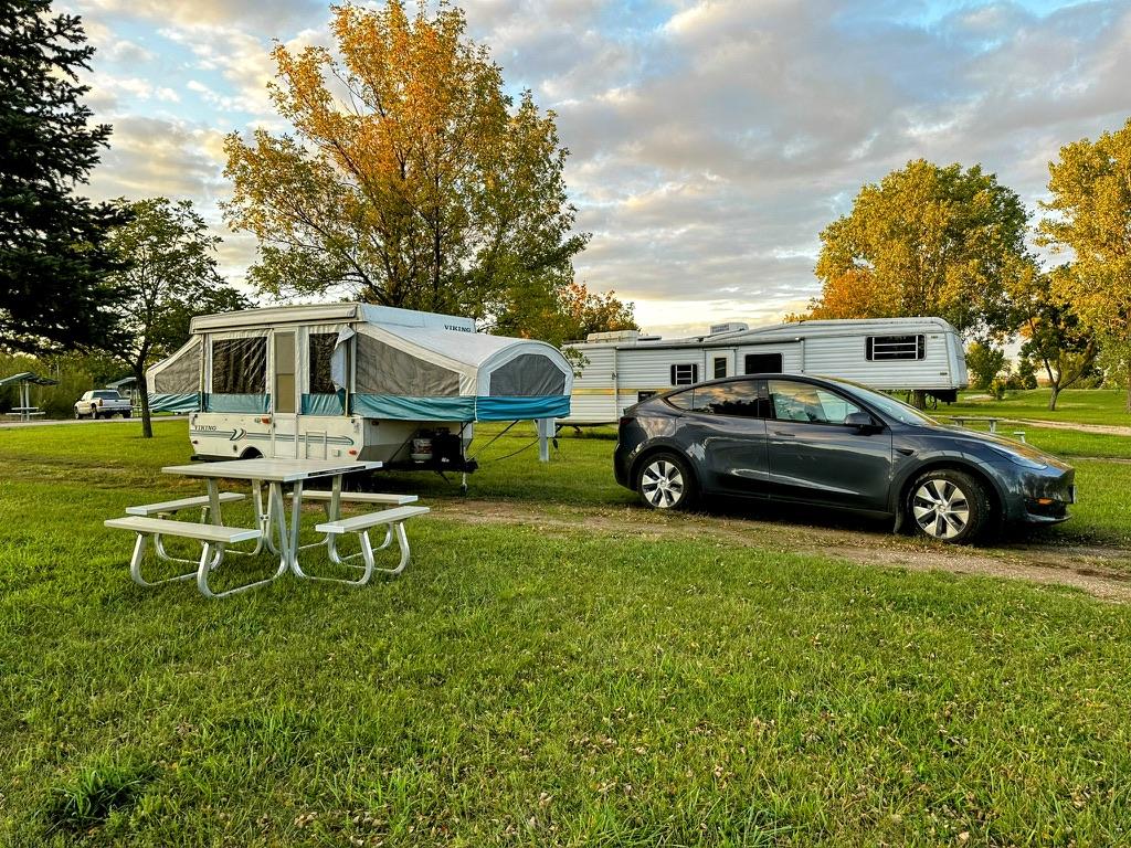

I took a trip with my Model Y to California and back towing a small popup trailer. I stayed a campgrounds and charged the car from the 14-50A outlet at the campsite.
My last stop was at an old run-down campground run by the town of Armour, SD. My 32A Mobile Connector tripped the breaker after five minutes, so I ran it to the empty, adjoining site and it tripped again. I dialed down the charge current to 24A and charged without issue all night long. I don't know how old those breakers and outlets were, but they looked ancient.
My money is on a bad breaker because a fault within the truck's OBC would likely set a code and disable charging.
