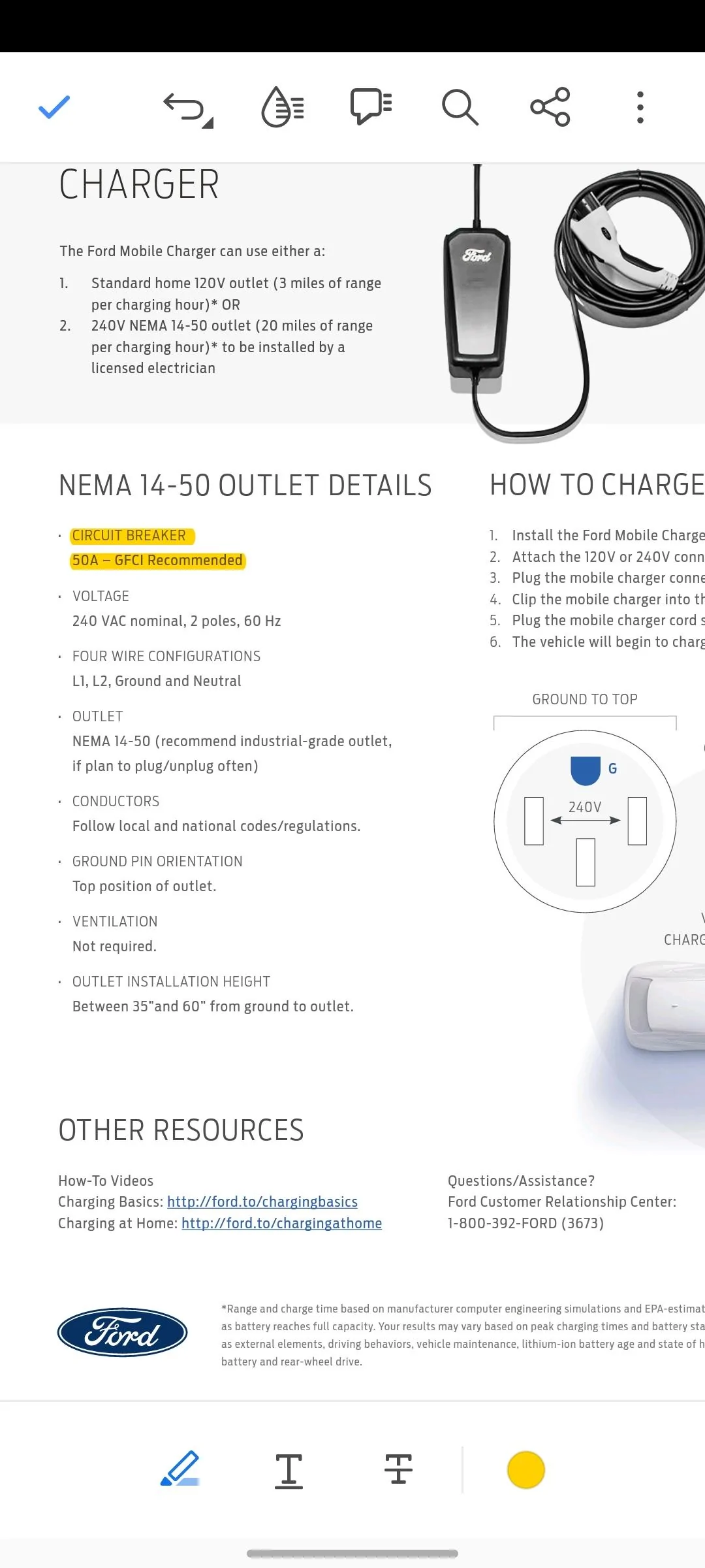

The rather hidden info for the Ford Mobile Charger also specifies that it is only for a 14-50 outlet WITHOUT GFI.
Tesla owners have the issue but much less frequently. See: https://www.teslaownersonline.com/t...tor-nema-14-50-gfci-breaker-reliability.7713/
Perhaps the Ford Mobile Charger can be changed so this isn’t an issue. Or should we do a survey like the Tesla owners did?
Hidden? What are you reading? Actually says to use a GFCI circuit breaker...

@RickLightning is right, a GFCI breaker is recommended. That leads me to believe something is wired incorrectly.
I think Occam's razor applies here. Try to solve the problem with the fewest elements. Going from tripped breaker to NEMA 14-50 won't work in California is a leap with a lot of assumptions.
The problem isn't the building code, the problem is a tripped breaker. Why did the breaker trip? A properly functioning GFCI will trip when an unintended path to ground is detected. Where is the unintended path to ground on a newly installed outlet? The wiring is one possibility. Humans make mistakes and yours would not be the first outlet where the ground and neutral were swapped. The charger is another possibility. Does it trip other, known-functional outlets. Testing this could be a bit tricky since 14-50 outlets aren't common in residential applications. Another way to test the wiring would be to use another charger but again, most people don't have an extra EV charger laying around.
Anyway, my point is the troubleshooting process should be narrowly focused to the problem (tripping breaker), assumptions should be kept to a minimum, and elements of the system should be tested individually to the extent possible.

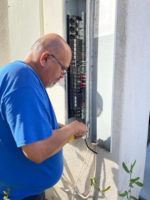

My electrician said it's cheaper to hardwire than to install an outlet and then limit the maximum current to 40A.
Mine is hardwired and delivers 48A (11kW) and it's been perfect since day one.
No outlets to wear out, no heating up contacts, no melting plugs, etc...
Electrician installing dual 60A breakers hardwired to my Emporia 48A EVSE:
