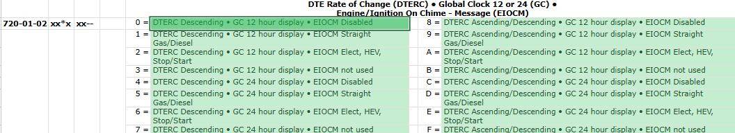

Now if I could only figure out why the clock in Sync keeps reverting to 12hr time everytime I start the truck, instead of the 24hr time format I prefer that would be great.
I've seen this come up on this forum before....I don't remember who was the member that had this issue. This fixed it:
Javier, I will go out and do that today. And thanks for pointing out where that was in the spreadsheet, I couldn't find it yesterday.
I'm just hoping that when I do the change it will actually 'stick'.

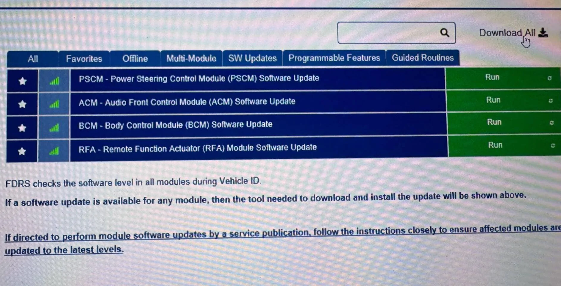

Ford F-150 Lightning ECU module programming guide using FDRS 1734496633883-c
Is it normal that ACM/RFA/PSCM are still on the SW update page even after installation?
installed 2 times and it still shows up
also is there any hack to get BCM installed? need WAL...

ACM and RFA not clearing is expected but haven't seen anything on the PSCM not clearing. For the BCM, you'll need to sweet talk your dealer.

I'd do (or redo) that PSCM update. It will also drag the IPMA into the mix since they are scripted to be updated together. But if the IPMA has already been successfully updated, FDRS will recognize that and skip over the reprogramming and configuration, and go right into the PSCM next. That PSCM by itself takes no more than 5 minutes normally.
That was me! (I think) I had the same issue where it would always go back to 12 hrs. This fixed it.
