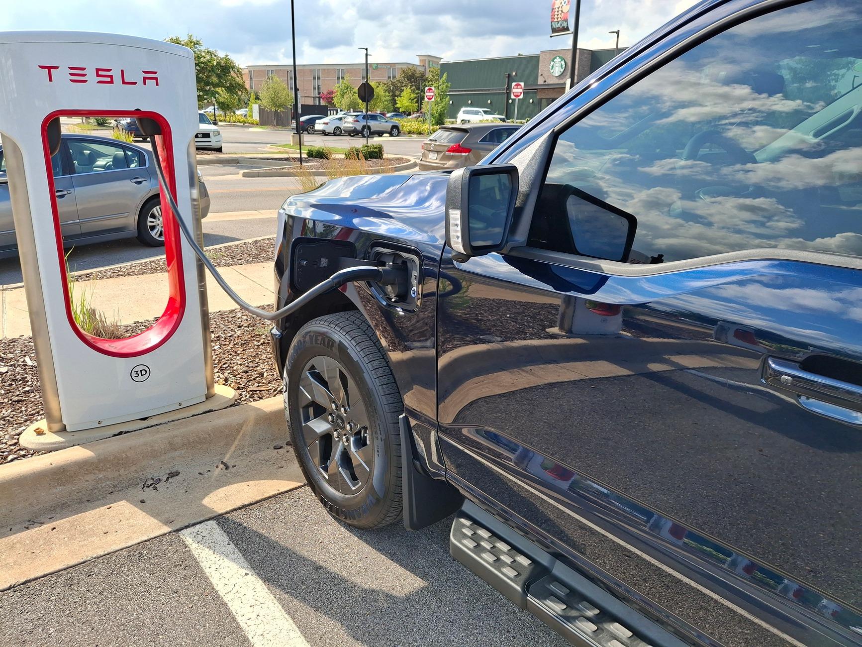

After reading all the input and Tom's review I ordered the A2Z just over 2 weeks ago and received it yesterday. There are v3 stations near my work so I decided to try it out today as a test run.
The A2Z is heavier then I expected and was very tight trying to insert the Tesla plug. It failed the first time because I thought the lock was on but it wasn't. I ended up inserting the Tesla plug into the handle about a dozen times till it started to click easly and lock securely.
The truck initialized faster then any other station I've used, by the time I got back into the truck after the blue ring appeared, the Ford app showed a nice 171kw speed.
I was just trying it out with no real need and was taking care of some emails when a 2024 Flash backed into the 2 spaces over in the Tesla charging stations. I was worried they were just using the parking and not charging, but instead the lady came over and asked about the adaptor. We had a nice conversation and I pushed the stop button to disconnect. It was a bit difficult to remove because the line had very little slack and took some wiggling.
Getting closer will be critical for sure as others have noted. All in all I'm pleased with my test run and look forward to a better charging road trip experience.
