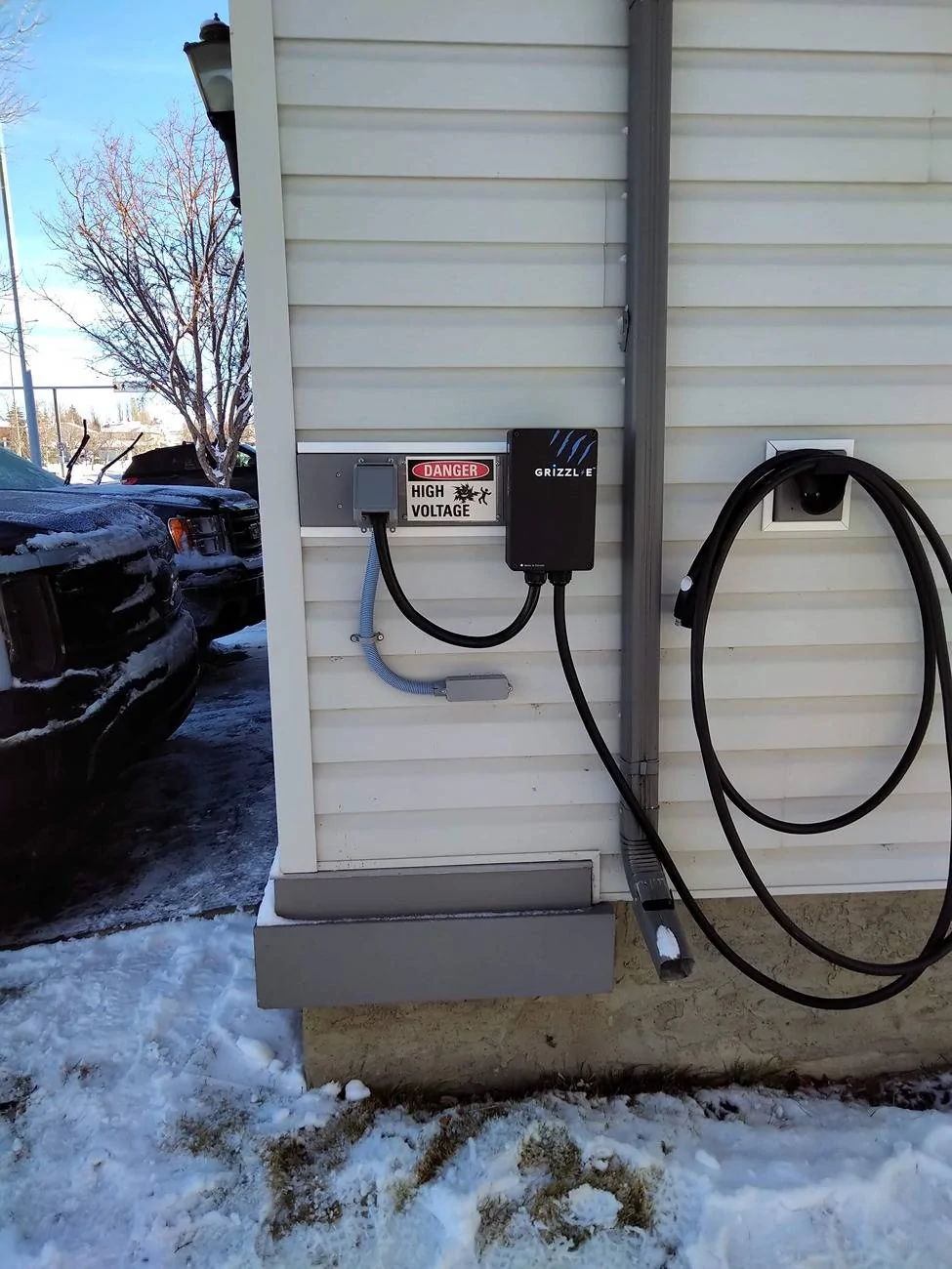

I'm using the Grizzl-E Classic 40 Amp charger without wifi. It can be ordered with either a NEMA 6-50 plug in cable, or a NEMA 14-50 plug in cable and has a 3 year warranty. It works very well in cold and hot weather.
Ford F-150 Lightning Home charger for 2024 Lightning Lariat - need CCS1, right? IMG_20231210_1229385

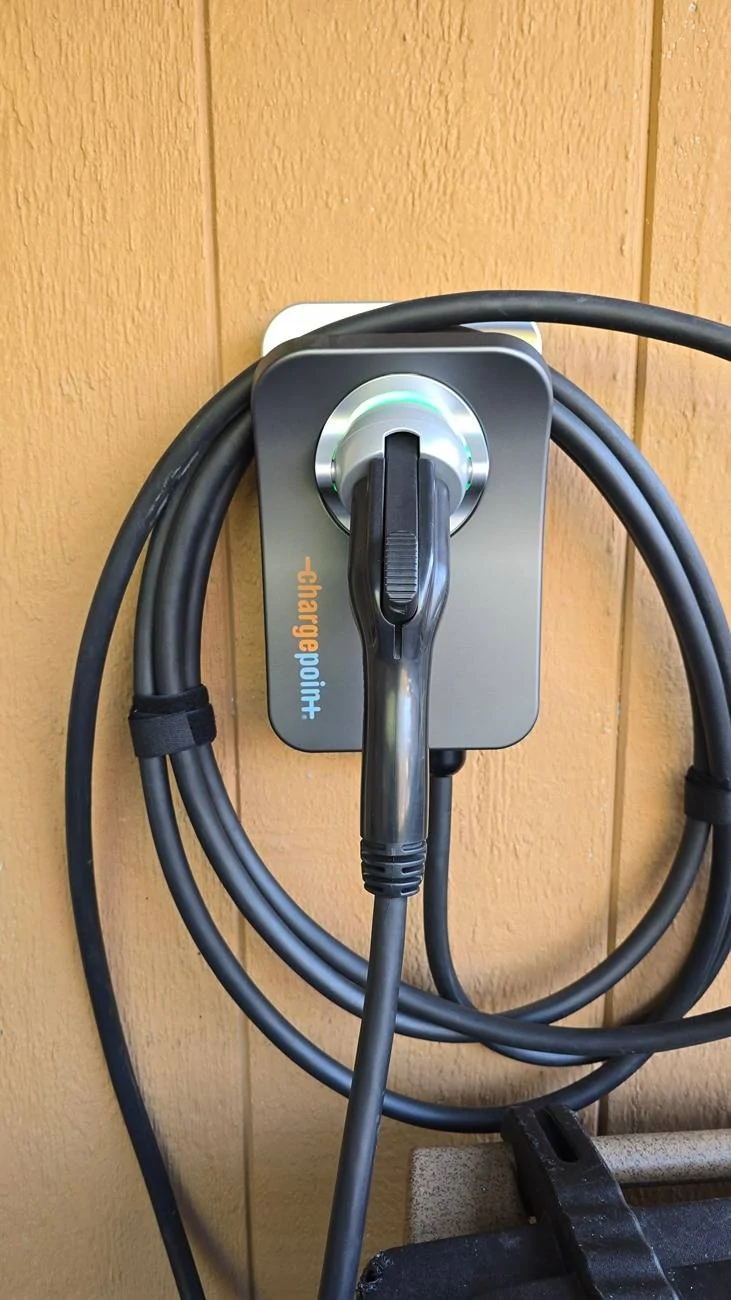

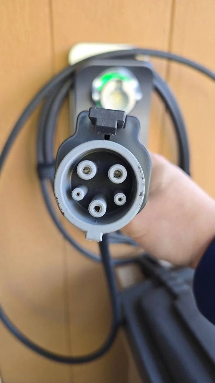

I have a ChargePoint and it has been solid. 60 amp breaker so 48amp charging @ ~ 11ish Kwhr. I got it new from someone on eBay for $350.
Edit- no DC connection, so not a CCS, it is j1772. See pic below
Ford F-150 Lightning Home charger for 2024 Lightning Lariat - need CCS1, right? 20241108_090439
Ford F-150 Lightning Home charger for 2024 Lightning Lariat - need CCS1, right? 20241108_090446
