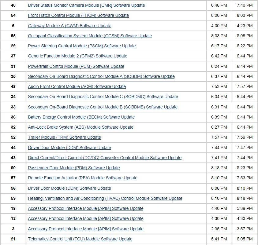

I got those times from @Mike G who looked up my VIN on FDRS after the tech left. I think it would be cool if all you Mongeese folks (and the one China VCM clone) start posting your FDRS session logs with times.
Fyi the tech told me he did the APIM and FHCM but he didn’t. I’ve decided to get in the loaner queue and do them myself.

Ha the AI notes generated in FDRS are pretty amusing.
On 10/5/2024, the vehicle underwent multiple software updates across various modules. The updates began at 2:27 PM with initial network and self-tests confirming the functionality of numerous systems such as ABS, ACM, APIM, BCM, and others. The Accessory Protocol Interface Module (APIM) experienced repeated software update attempts due to a failure to locate the manifest file in FENIX responses, necessitating multiple retries and adjustments including turning the ignition on and off and ensuring power stability with an external power supply. All APIM updates essentially followed the procedure of updating using USB software, which required ensuring the ignition settings were correct and patience for the SYNC system to confirm the update’s installation which was successful as per the last button press confirmed by the user.
Subsequently, the Gateway Module A (GWM) and Telematics Control Unit (TCU) underwent similar updates, involving USB software application, selecting drive options, and waiting for SYNC responses. Each module required the vehicle's ignition to be toggled between off and on states strategically according to the update’s needs. For GWM, after the update, a key aspect was to leave the vehicle off to ensure completion. The final update steps involved confirming the installation success before finishing each module's application.
Moreover, the Power Steering Control Module (PSCM), Powertrain Control Module (PCM), Anti-Lock Brake System (ABS) Module, and various other control modules including SOBDM, SOBDMC, SOBDMB, BECM, GFM2, CMR, DDCM, HVAC, and PDM all underwent software updates following the structured protocol of connecting to an external power supply, appropriate ignition toggling, and update application through USB system responses. Each component's update concluded with a series of network tests and self-tests to ensure complete systemic functionality and update integration without errors, confirming the updates' successes systematically. The final network and self-test at 8:26 PM verified that all systems were operational.
And here was my Friday afternoon. Out of order but was trying to get it on 1 page and avoid all the self/network tests. Was up to 6.8 in a Dec 2023 Built Lariat prior to Friday.
Ford F-150 Lightning Lightning Software Updates using FDRS 1728186693814-5j
