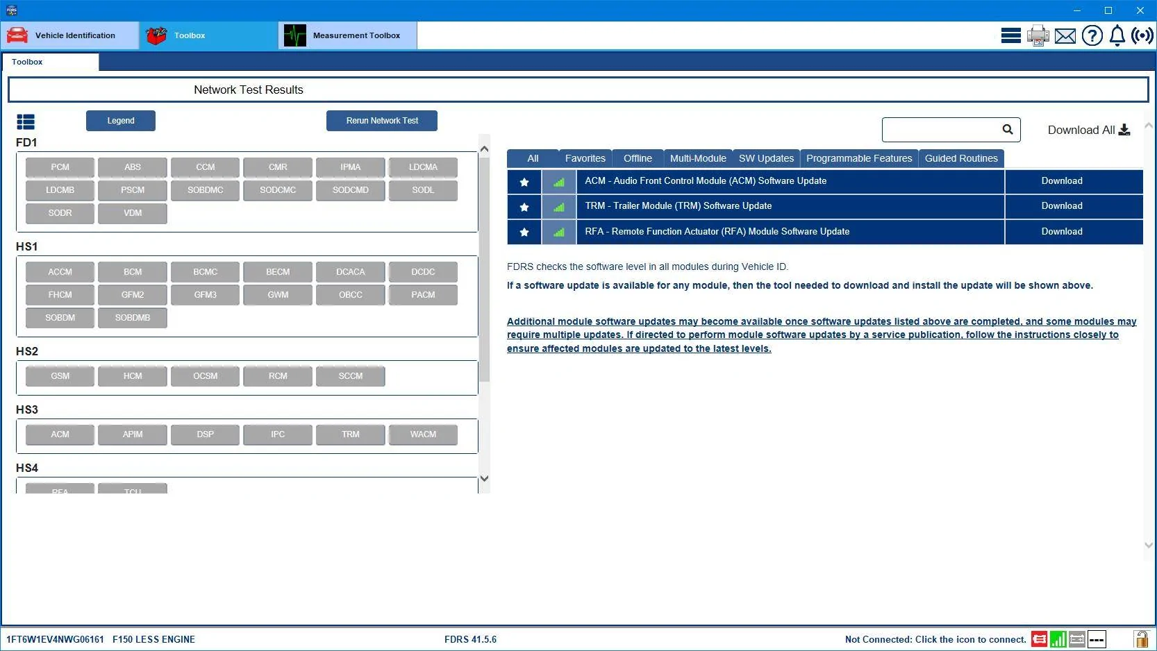

Got a new trailer module update in the list this morning...along with the 'persistent' ACM and RFA updates that either won't update properly, or do update but won't clear off the list. It's not clear which.
Ford F-150 Lightning Lightning Software Updates using FDRS Lightning_TRM_3-Oct-24
ChrisCon
Jan 7, 2022
509
929
The Hamptons, NY
I've sat in my truck and watched both of the ACM and RFA updates and they even go through the validation process at the end , so I tend to think it's just "won't clear" . On vacation but I will run the trailer module update Saturday morning.

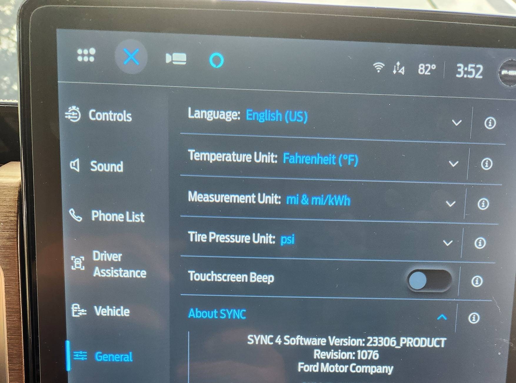

I had 1049 and just updated to 1076 with the new icons. All joyous 6GB worth. Then got a gateway and now onto another 6GB APIM. o_O

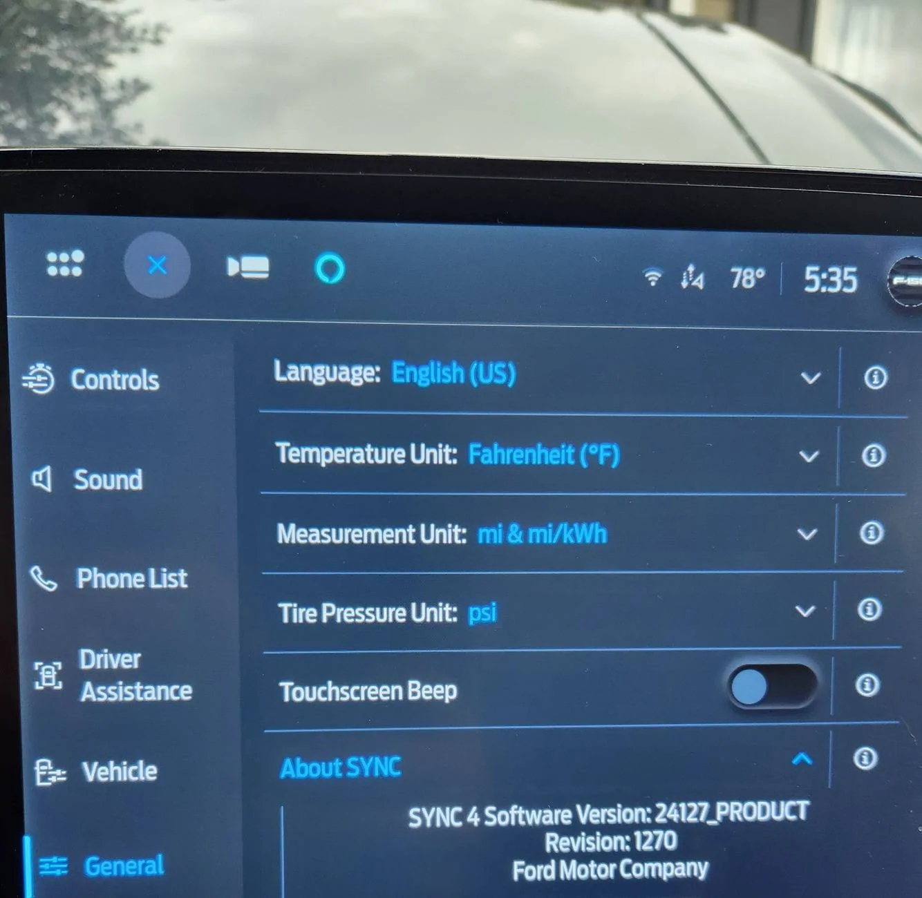

And that one was 1270 with the Karaoke app. Moving on up in the world.
