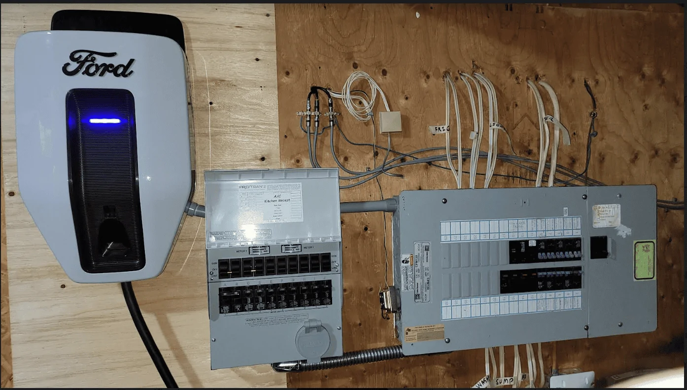

Here is my “Unintelligent” backup power installation
I just went simple if power goes out I plug in the truck. Low cost setup.
Ford F-150 Lightning My “Unintelligent” backup power installation 1665856187741-png-png-
Works no problem with the trucks GFI This setup cost me about $1,100.00. I just need to plug truck in and turn it on Pro power. ;) This transfer switch has 10 ciruits that are separate in that I can pick and choose which ciruit I want to run off the truck. 1 240 volt 30amp for the air conditioner(only if needed), 1 120 volt bridgred for kitchen plugs the rest for fridges, sump pump, internet modem WiFi, some computers, and bedroom TV +.
FYI I turn down the Ford Pro charge station to setting #5=48 amps. wired direct to panel with 60amp breaker.

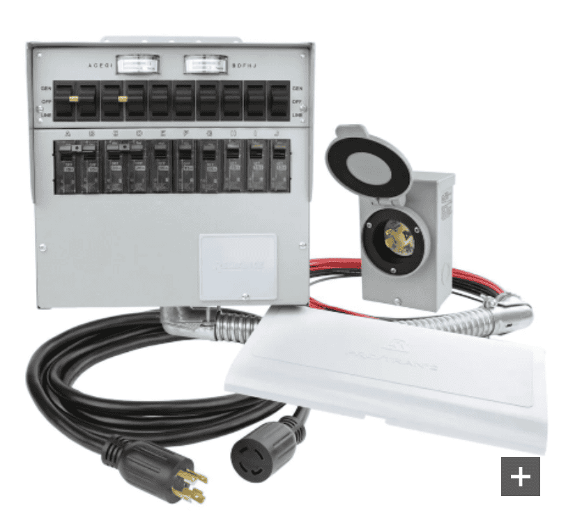

Reliance Controls 30 Amp 7500W 10-Circuit Indoor Transfer Switch Kit
Model # 310CRK|Store SKU # 1001061741 Canadian Home Depot US unit maybe different.
I took the generator connector plug out of the remote outside box, and installed it in the optional position in the transfer switch panel. Since the Lightning has no gas fumes I kept the system all in the garage. The reason it works with the truck's GFI is the ground from the truck is not connected to the transfer panel. Some people have technical issues with that. But if there is a grounding issue the house GFI will detect it and shut of power.

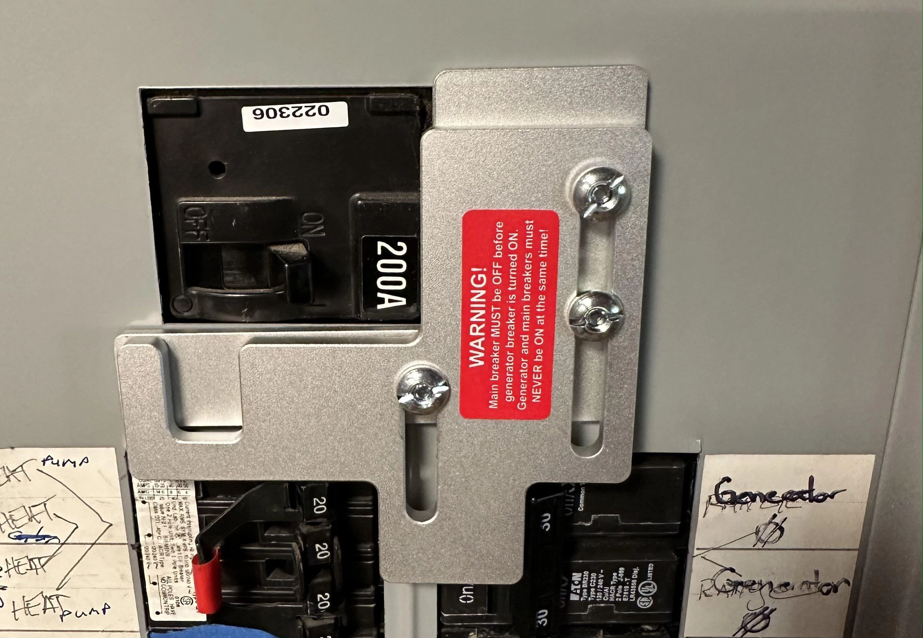

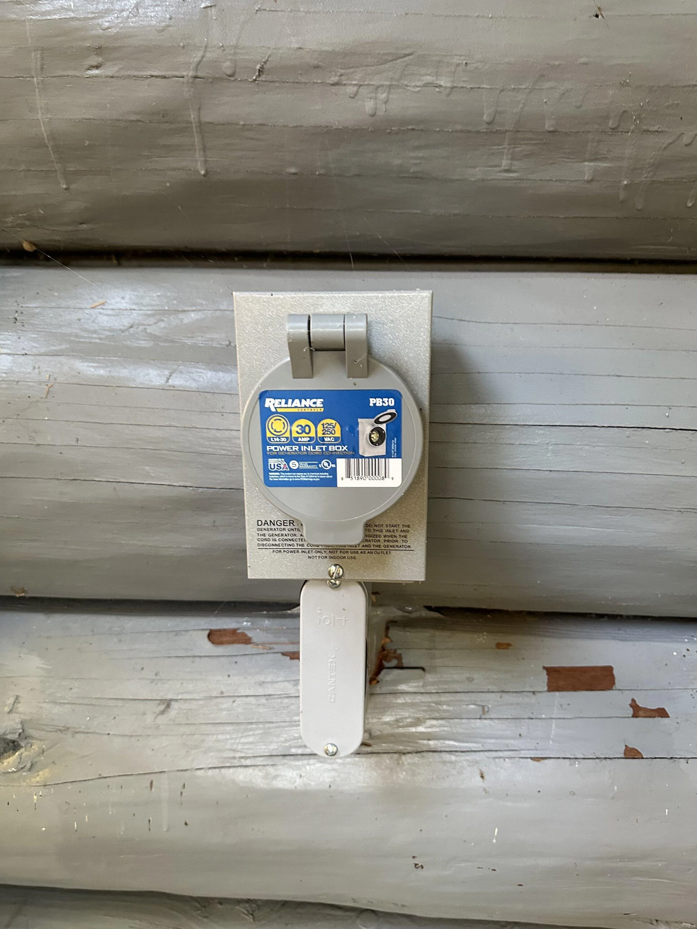

I have a generator inlet box on the side of my house, and a UL Listed main breaker interlock as shown a few posts up. Normally used with my portable generator to power up the whole house. Safe and effective alternative to main ATS or sub-panel with ATS. Same thing got me with the truck seeing the house's bonded neutral as a fault.
I made up a new generator cable with the ground disconnected on the house-end (female end) for this reason. That way the truck doesn't see the "ground fault" that is the the house's ground/neutral bond at the panel. And the cable itself is still 99% safe since it still has the ground wire in it, so if someone (me) runs it over with a lawnmower, it will still trip the truck's ground fault detection. There is probably some code requirement that would want to see this done differently with a thousand dollars worth of extra parts, but this is safe and functional.
I'm going to be putting a new generator inlet box in the garage so I can plug it in there rather than driving it around to the side of the yard.
