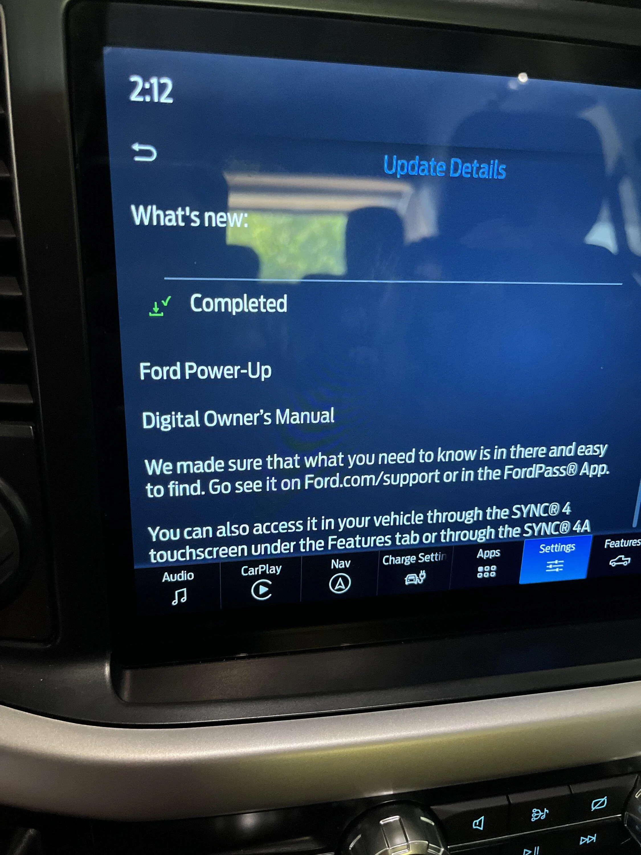

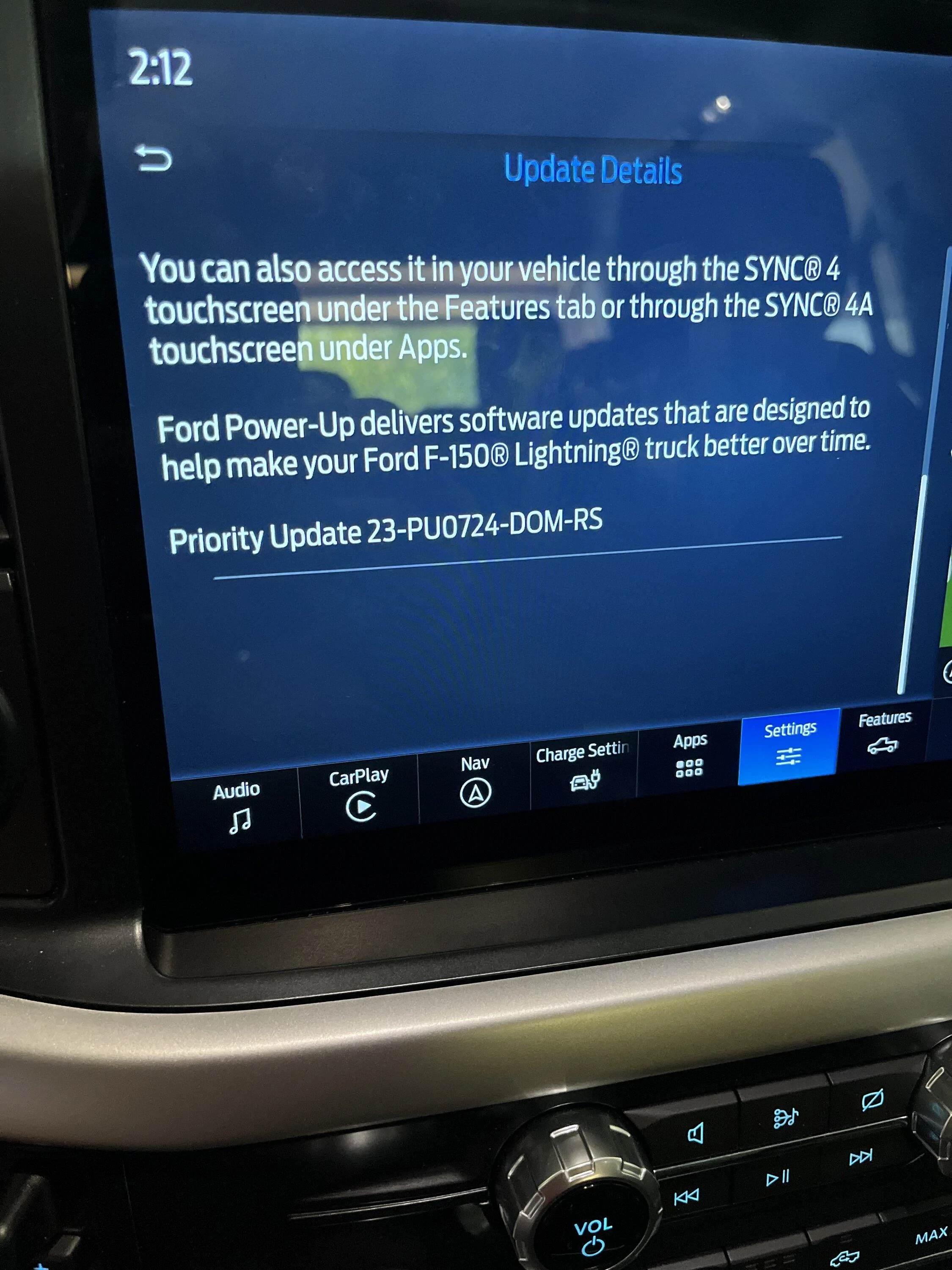

OK. So I have not gotten an update since June on my lightning pro. However, my wife’s XLT has been up-to-date the whole time.
Went for a drive today, and I got the latest update for the digital owners manual. However, I am still missing anything else that came in between, including the one that gives you the percentage on the display behind the steering wheel.
Now, maybe I’m starting to get the updates or it could be because I had mobile service out and he updated the body control module and the front trunk module. He tried to do others modules as well but they failed.
So maybe I just got this one or something he did triggered it to start working. But he came on Monday and this came Thursday afternoon, three days later.

This is really interesting. Many others all in the same boat, no OTA updates for 3 to 4 months. Almost starting to seem normal until you get some older SW updates installed via FDRS (along with some failures) and then boom, 3 days later you get an OTA.
Seems like Ford has some deeper digging to do and explaining as to why so many trucks aren't getting OTA's.
I wonder if @rugedraw would take a look at your VIN now and see what you have left in the queue and if those failures from the other day have cleared up?
