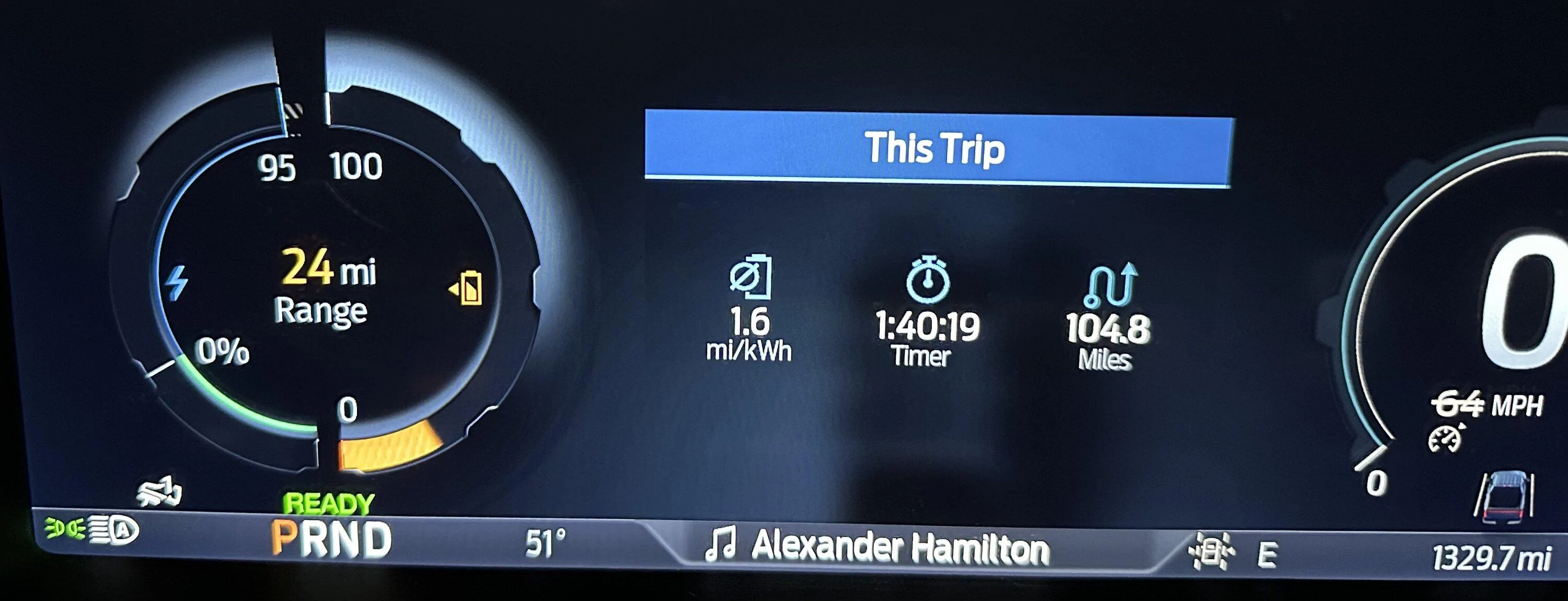

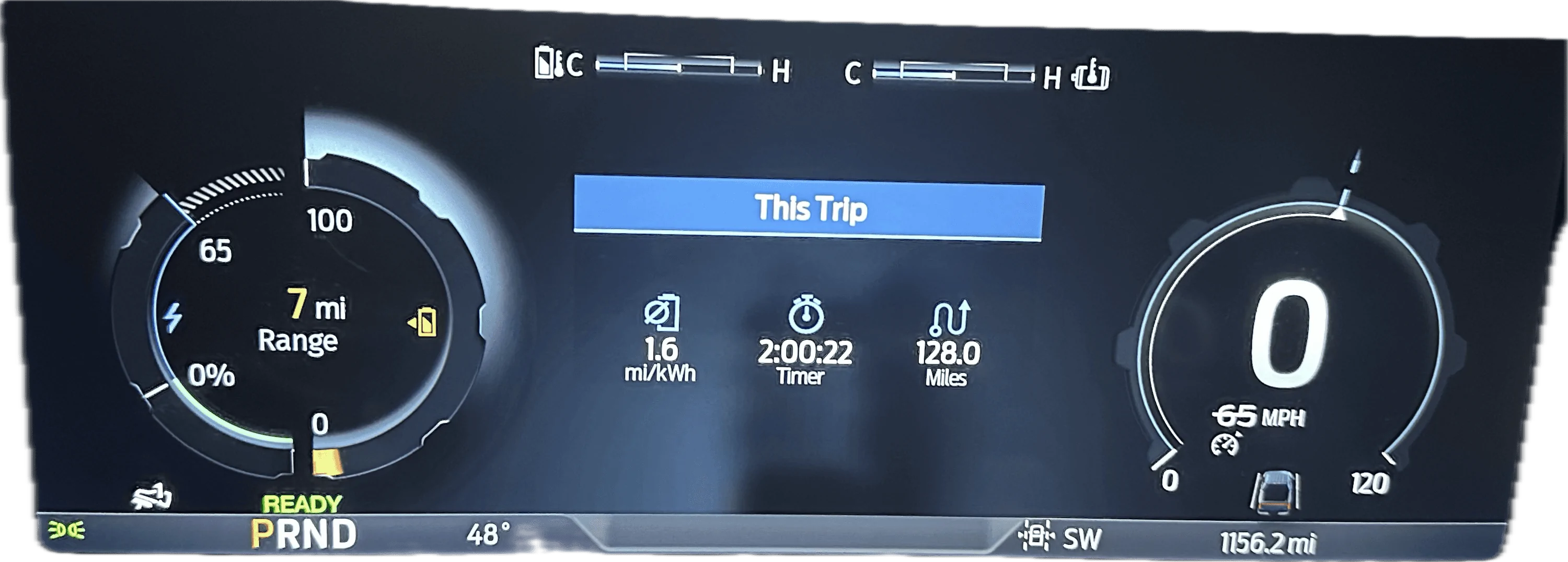

2023 F150 Lightening XLT SR
It was fairly windy for the first half of the drive, mostly from the West while I was heading South.

I think WIND is a big, big factor in your overall miles/per kwh average over long travel, ESPECIALLY at 'high' speeds... yes, a Model 3 is not going to have the same wind concerns as a big TRUCK, with a flat front... slow down. SPEED is the answer. You can drive slower, and charge less. You can drive faster, and charge more often.

So, for a Ford, 50 degrees is cold? That’s incredible. Other EVs don’t see that sort of degradation until you’re below freezing. And, as I. My post, it got better mileage when it was in the 30s. Same speed. Same climate setting (actually with the climate control off when it did one of the worst legs). So, the “cold” explanation doesn’t hold up. An almost 40% reduction in range, unloaded, just because it’s in the upper 40s to low 50s is pretty sad. And, there are many posts/videos. Of folks out there getting 200 miles in these things at 70 mph. Yes, it’s as aerodynamic as a brick. But, it also has a huge battery compared to my previous EVs. So, I guess it’s useful as long as you never take it out of town.
Was your other EV a big azz truck? Was it a traditional vehicle design or more of a purpose designed EV?
I ask because it is not a Ford thing, it is a physics thing…?‍♂

You were getting 1.6mi/kWh. The full 100% of your 98kWh battery pack would give maximum range of 156mi, driving at 1.6mi/kWh. The lower efficiency is most likely due to 1) high speed, 2) headwind, 3) colder battery temp, or a combination. If you look under “Trip Energy” in Features, you’ll also be able to see how much of your consumption is due to cabin heating (it’s usually not as much as a lot of people seem to think it is); it probably doesn’t hurt your efficiency enough that you’d want to turn it off (but learning to love those heated seats is a plus!).
It’s a practical idea to monitor your efficiency (mi/kWh) while driving, and you’ll never wonder why your range dropped. You can reset Trip1 or Trip2 as often as you wish, to obtain the current mi/kWh. To improve your efficiency, you can always slow down 5-10mph and recheck mi/kWh, or fall in line with some larger profile vehicles to lessen the wind and speed effects (doesn’t work when you’re the only vehicle on the road, of course).
I don't have a Lightning, but even in a much slippier EV, which I normally get 4.1-4.3 miles/kwh, if I am at 70-75 it drops ~25%.
If it's wind in my face, it takes a sizable hit as well.
I can imagine with a brick that's getting 2.X m/kwh in ideal conditions, dropping to 1.6 would be normal at 70-75mph. Add 15-20mph wind and you are near 100mph with a sheet of plywood trying to punch a hole.
That's really not much battery in those conditions.
