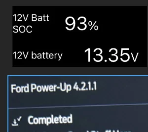

Got mine installed yesterday without a hitch. Did a check on my 12V battery before attempting it.
Edit: 4.2.1.2 install complete on Feb.16, 2024

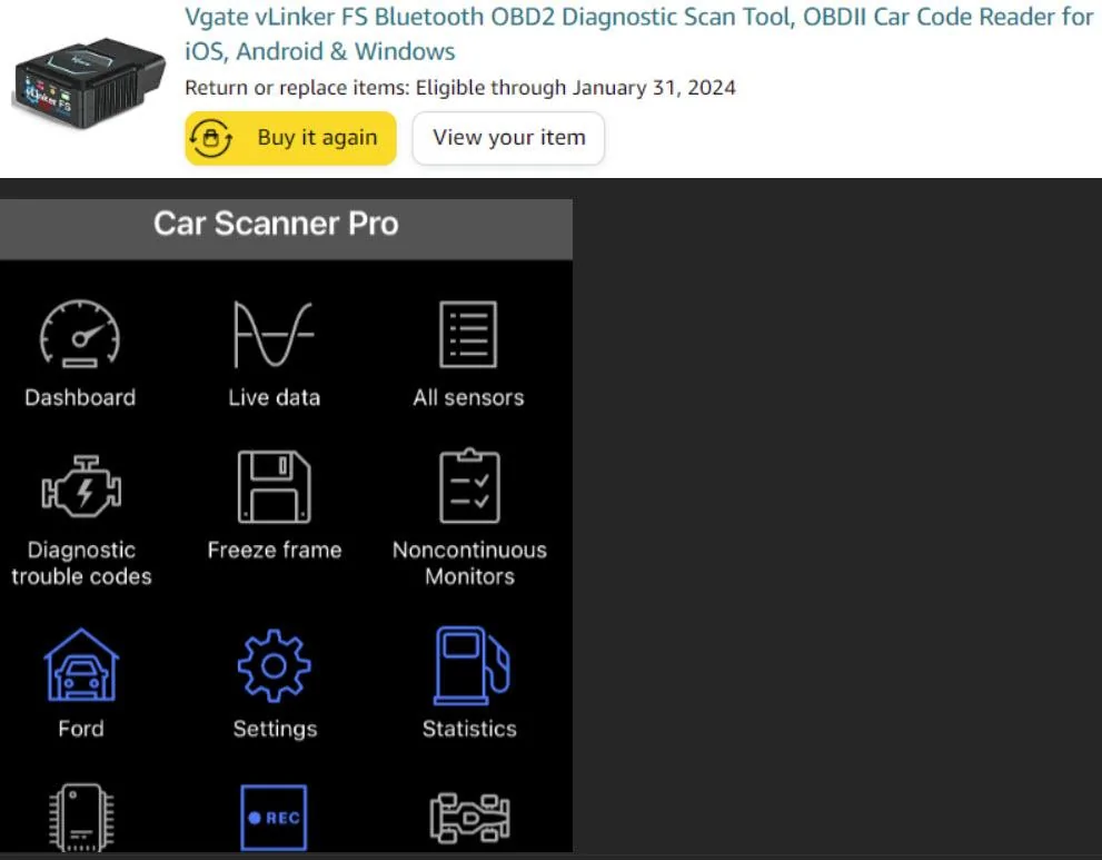

BTW - how did you get the SOC and 12V battery information on your screenshot?

I'm using Car Scanner Pro with the Vgate OBD2 scan tool.

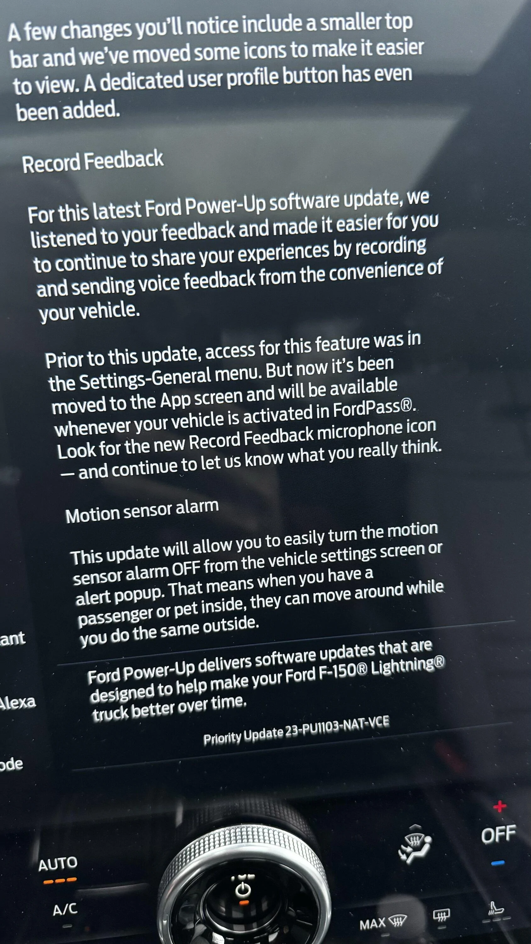

I got revised 6.2 today. So still proceeding on a similar schedule. Today’s update was meaningful as it provided the Apple Maps charger integration.
Looking forward to this update! I am on 6.1. Does anyone know if apple maps will precondition enroute to a charger?
