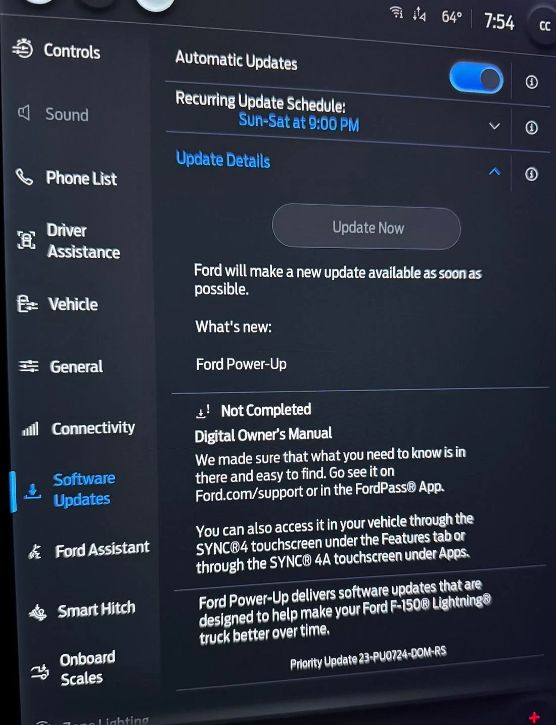

Anyone see this before ? The update shows as “not completed “ but I can’t force it to update because it doesn’t require downtime . Every other update that has ever shown “not completed “ I’ve been able to force through by pushing the “update now” button which is grayed out for this one.

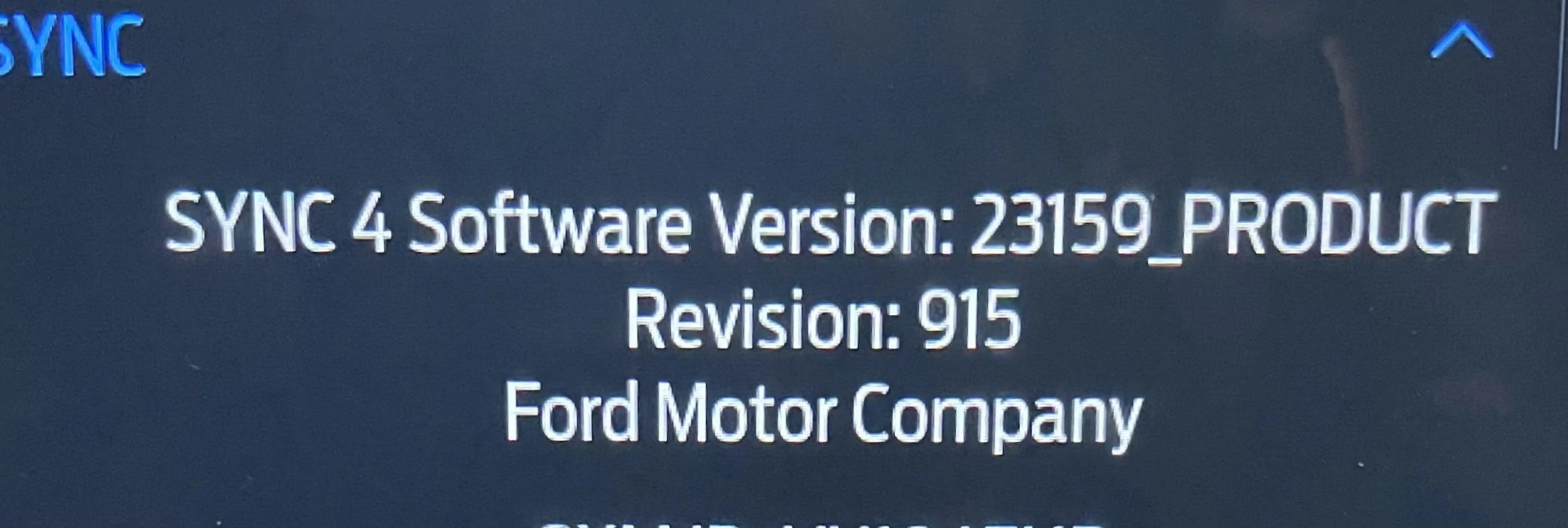

To report in, I also just received this update tonight (even after all of the updates the dealer did today).
@rugedraw - had looked at my truck and noted that one of the updates the dealer tried failed, but I should be up to date now.
This update changes the Sync version number.
Might not have completed the download as of yet.
I can check in PTS for you. Just need the VIN. PM if you prefer to keep it private.

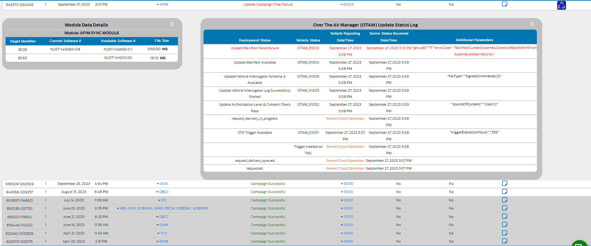

Interestingly enough, the BCM update that vehicle history showed that failed is gone from the list, and the PSCM that vehicle history showed went through is still on the list. Even though you got the APIM update that brings you up to Sync 23159, you're still showing an APIM update.
Ford F-150 Lightning Priority Update: 23-PU0724-DOM-RS 1695954907514
PTS also shows you're on Sync 23159. I'll check it again in a few days to see if these come off the list once your truck Syncs up with the mothership. I was only expecting to see the failed BCM update showing for you. There are no other APIM updates after the one this thread is about that I have seen.
Update failed 3 minutes after the OTA trigger was created citing a manifest mismatch. Not a single file was attempted to download due to error of the nature. While I have seen many updates fail with this error, I do not know what causes it. The update was canceled by the mothership.....nothing you can do but wait for them to resend it and hope for better luck next time.
Your VIN was left out of the screen shot to preserve your privacy, but I wanted to respond here so others can see the nature of the failure. This can happen to any truck and any time with any OTA.
