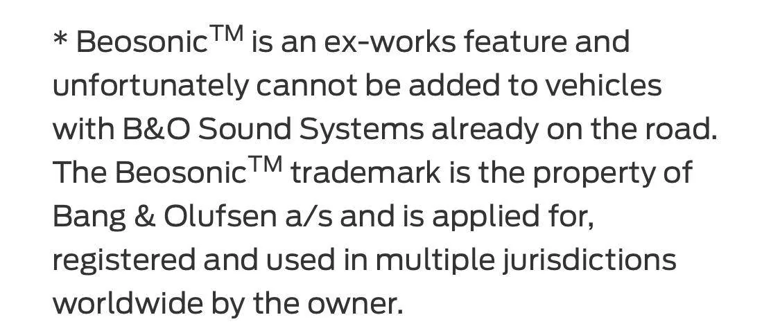

Well it says this. So maybe even though we can “enable it” it’s not really doing anything because we are missing something else. 🤔
Yes but…
The article is dated April 7, 2021 so I would assume that this would have been prior to the existence of the Lightning?
Regardless, that is a pretty cool looking screen-LOL
