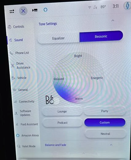

Anyone here feel like being a guinea pig to see if the Beosonic menu works on these trucks? It seems work on 21-23 Mach E's and 2024 F150's, but over on the ICE forums, we have not been able to get it to work on 21-23 trucks:
783-01-01 xx1x xx
7D0-01-01 xxx8 xxxx xx (The 2024 F150 had to use a 9 here instead of an 8, so try a 9 if the 8 does not work)
783-01-01 xx1x xx
Tried it and it works! I used instructions from Mach-E forum:
Code:
783-01-01 xxXx xx - Add 1 to X  (this is DSP As Built)
7D0-01-01 xxxX xxxx xx - Add 8 to X  (this is APIM As Built)
On my truck for 783-01-01, it was a 0 so I made it 1.
For 7D0-01-01, it was an 1, so I made it a 9.
So just like you said for the 2024 ICE. I'm not an audiophile so didn't test it. For just radio, I couldn't tell a difference.
