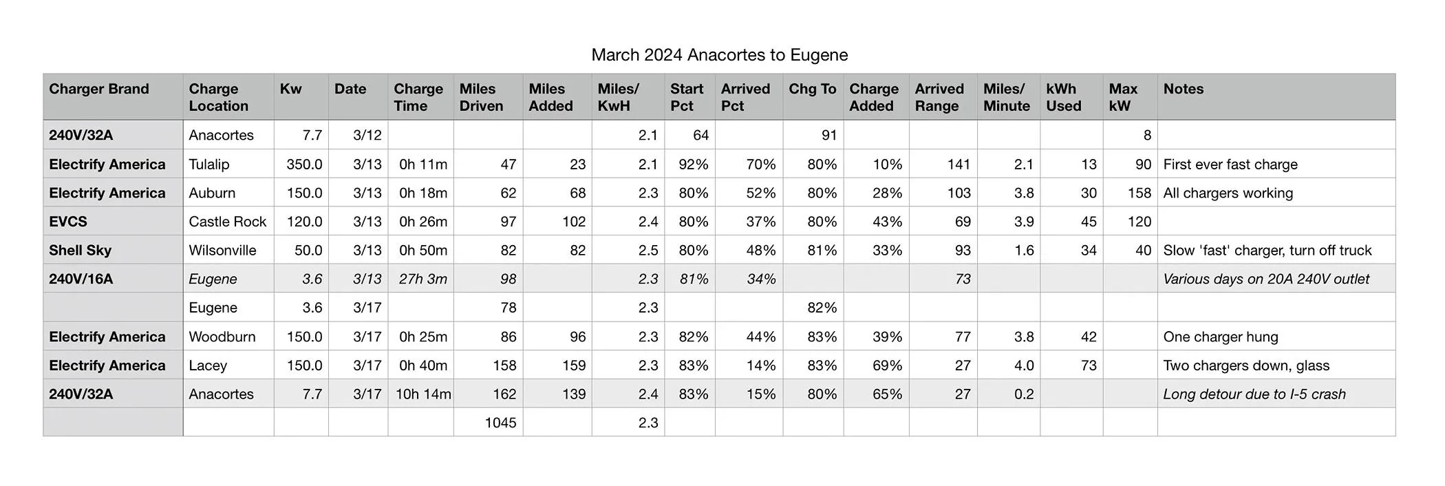

I should add that on my most recent long trip I was getting between 2.3 and 2.5 mi/kWh so the range on my chart is low. In reality we could drive about 160 miles comfortably while keeping to our rule of not fast charging above 83% or going below 10%.

The weird thing is that on the LIghtning I am getting better efficiency on the freeway than in town, although temperatures have gone up a bit in the Northwest. I can't really explain it except that town is kind of hilly so maybe starting from a stop takes more energy than cruising along? I'm going to do another long trip soon to see if it was a fluke.
This was our first long trip, and the first time that we used fast chargers. Our first stop was a test so if it didn't work we could go back home. We stopped at four on the way down and two on the way back when we were more confident and in more of a hurry to get back. The guess-o-meter (range) meter is pretty bad, it lost predicted range when I added a rest stop *before my destination* on the same road! I use the miles/kWh * battery % * battery size method.
The "turn off truck" is for a Shell Recharge 50kw station, it didn't work and that was the advice we were given when we called. Turn it off when plugging in, you can turn it on once it starts charging. It worked (but 50kw is really slow, that stop was a mistake.)
