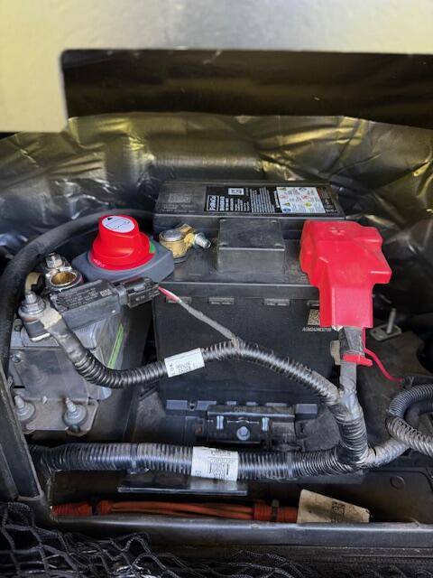

I've been thinking about doing this. I have a Naviks HDMI interface module running through my APIM which tends to get locked up in a funky state every now and then and the only way to kick its ass back into gear is disconnecting the battery.
I know there are plenty of ways to do this, but what did you to yours?

What cutoff switch did you install?

This one.
I did have to pull the cable retainers out of the battery tray to give me some extra slack. The switch is also a bit offset as you can see to clear the battery access cover.
If I find a better one I'll be changing this one out. I'd like to find one where the input and output posts were closer together so that the cabling wasn't as displaced as it is now. But it does work fine the way it is.

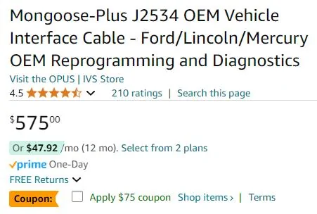

Amazon currently has a coupon for $75 off any mongoose, expiry is 11 Oct 24
Ford F-150 Lightning Lightning Software Updates using FDRS 1728403047553-3k
Price used to be $540, it went up a month or two ago. $500 probably as good as it's gonna get. Have they ever had a black Friday/cyber Monday sale on these?

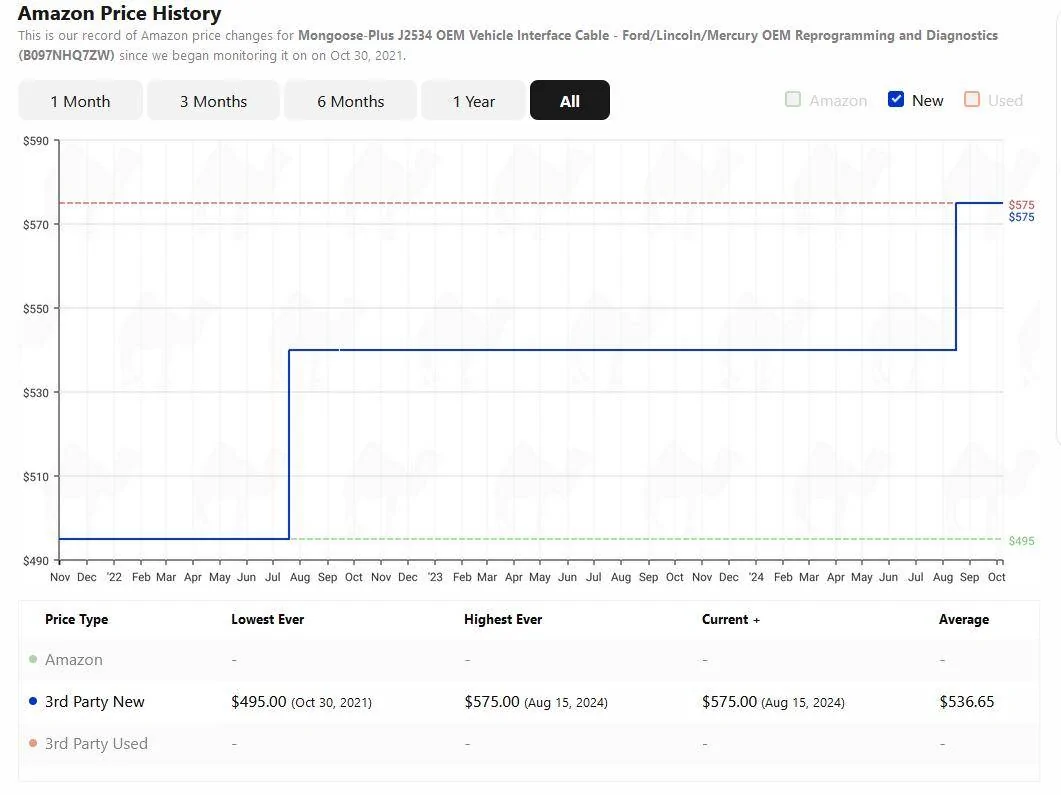

camelcamelcamel says the lowest they've ever tracked this on Amazon was $495 on Oct 30, 2021.

There was a Reddit post asking this 4 years ago and Mongoose said they don't do Black Friday deals. I don't know if that has changed since then. Looking at the Amazon price history they were $495 until mid 2022 when they jumped to $540 (https://3cmls.co/US/B097NHQ7ZW) . Looks like they jumped to $575 around a month ago. Not sure if that was in preparation for this $75 off sale or not. I paid $540 for mine about a year ago on Amazon

Do you have to install the switch at the battery post or can you get away with disconnecting at the module input and installing something like this https://www.amazon.com/Ampper-Battery-Disconnect-Isolator-Vehicle/dp/B0BZD1KDF8

You could use that one and disconnect after the sensor I suppose. I don't know if it would make a difference electrically. Might be worth a try. These things thankfully don't cost a lot so experimenting is inexpensive, and I can always use the extras on stuff like my tractor or mower, etc.
